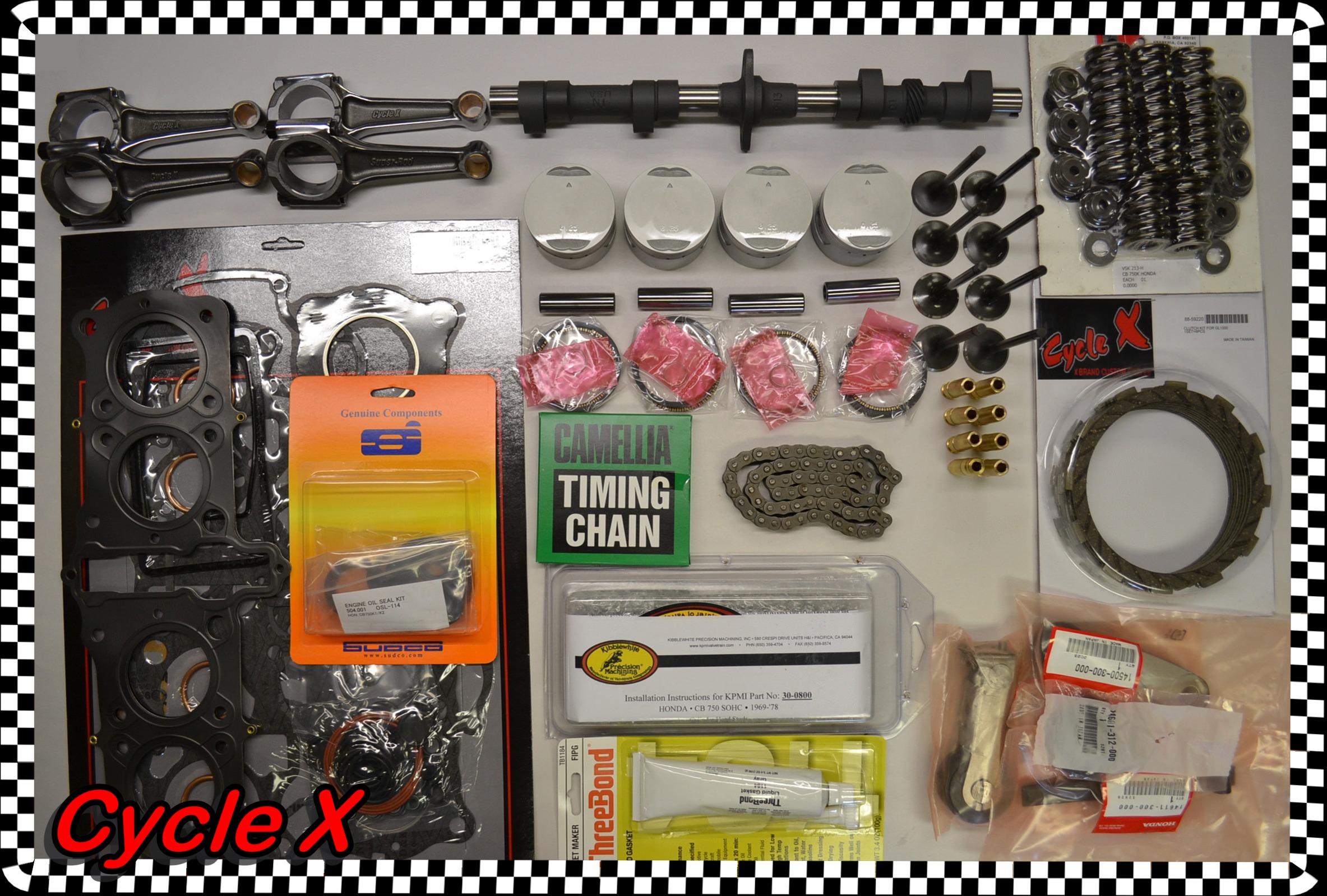

So, I'm going to need lots of new bits! I'm thinkng 836 kit from Cycle X? What do you reckon?
I'm going to need about two thirds of all that anyway, might as well just go the whole hog...
An admirable attitude!
