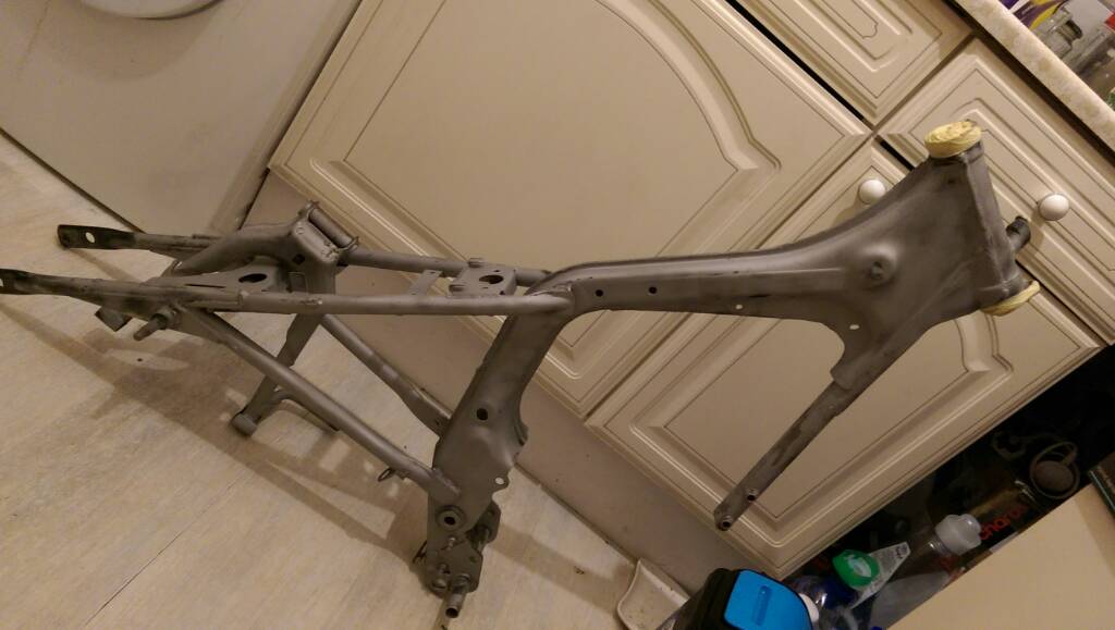

Frame has been blasted, I have welded the rear hoop on since this picture and it's going to be blasted again to give an even finish and remove the small bits of rust and dirt I missed the first time
