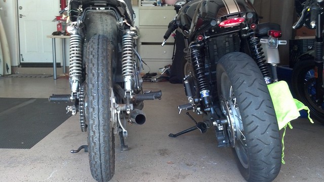

I don't know, something seems off. This tire looks tiny. No way that's too big for the stock rim.
This pics shows a comparison against the 130 on my Thrux

Be sure to lace up a wider wheel first. The stock "skinny" tire is already towards the edge of the wheels capacity.
