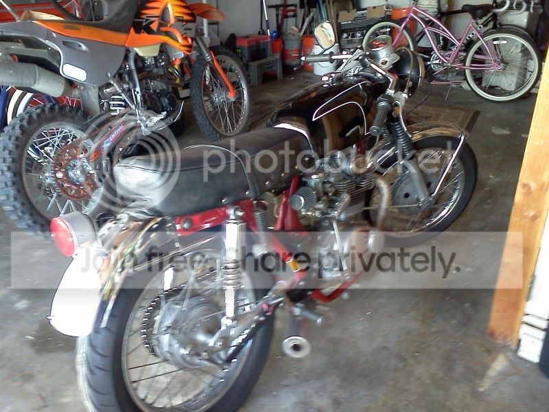

This is a 120/90 I put on the cl350 I built for my brother.
I guess you don't like him much?
That is wide enough to be dangerous, you can see the curve on sidewalls, plus, it looks like contact strip is only about an inch or so wide?
As for tyre sizes, max safe size on stock rims is still 90/90 front and 110/90 rear
You've seen you can fit wider tyres but bike will be way less stable.
Even 90/90 and 110/90 does affect handling compared to stock sizes (definitely more 'twitchy' but you get used to it)

Pj, now your making assumptions.... he rides it every weekend!
and so you got less mileage...that hardly constitutes "unsafe". My brother Keith has had it replaced for sure I know.... Is it the best width for the rim? no Will this person die if he runs a 120? yes, but from something else...
Lastly, I would like to say, I do agree with most of what you guys are advising. Just not the "danger" aspect. A 120/anything is not best for optimal for performance. But chances are, he'll get rear-ended by some chick texting before that 120 would be his demise.. And if he fallows a majority of this board. His bike wont run. Lets not get the cart in front of the horse here.
