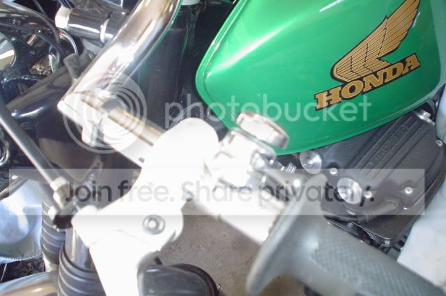

Any hints on how to do this? What do I need to to have on the bars? Blinker, horn, Hi/Lo... anything else? How is everything waterproofed? What amperage do the switches need to be? What am I not considering? Can I ask any more questions in one post? Why would i want to? Will I shut up? Probably not......
You can skip the blinker and use hand signals (that's what I'm asuming the owner of the bike in the pic has done). As far as water proofing, there's little need. You're not gonna short anything running at 12V with a bit of water.
