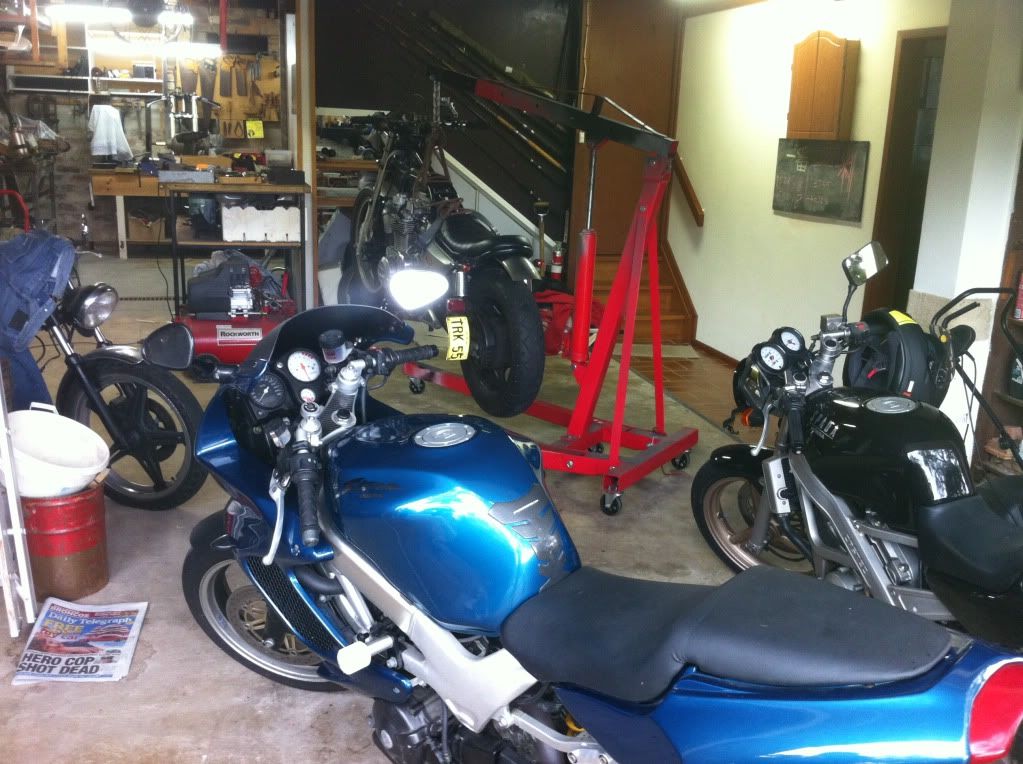

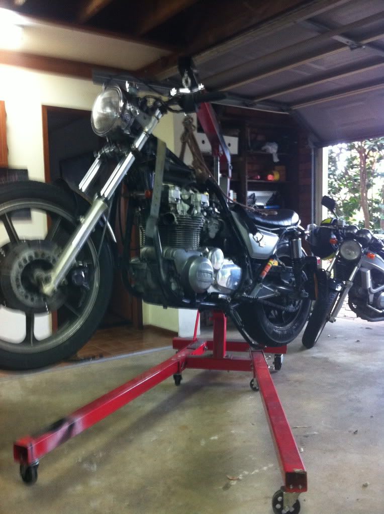

poor mans bike lift!!!

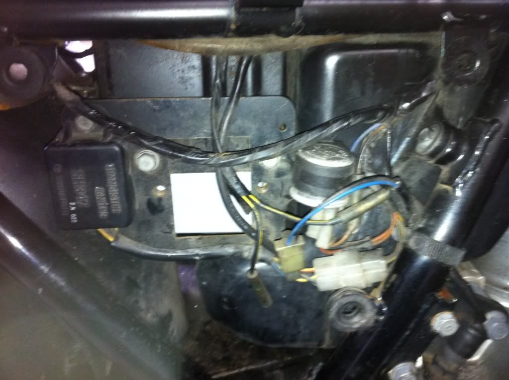

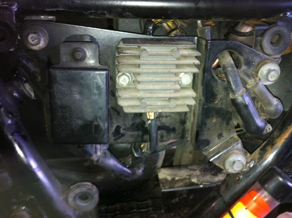

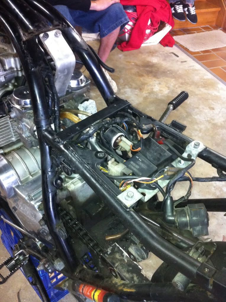

i have ordered some pods so i thought ide take out the airbox and see what i could do with the wiring.....
here are photos of each side......before

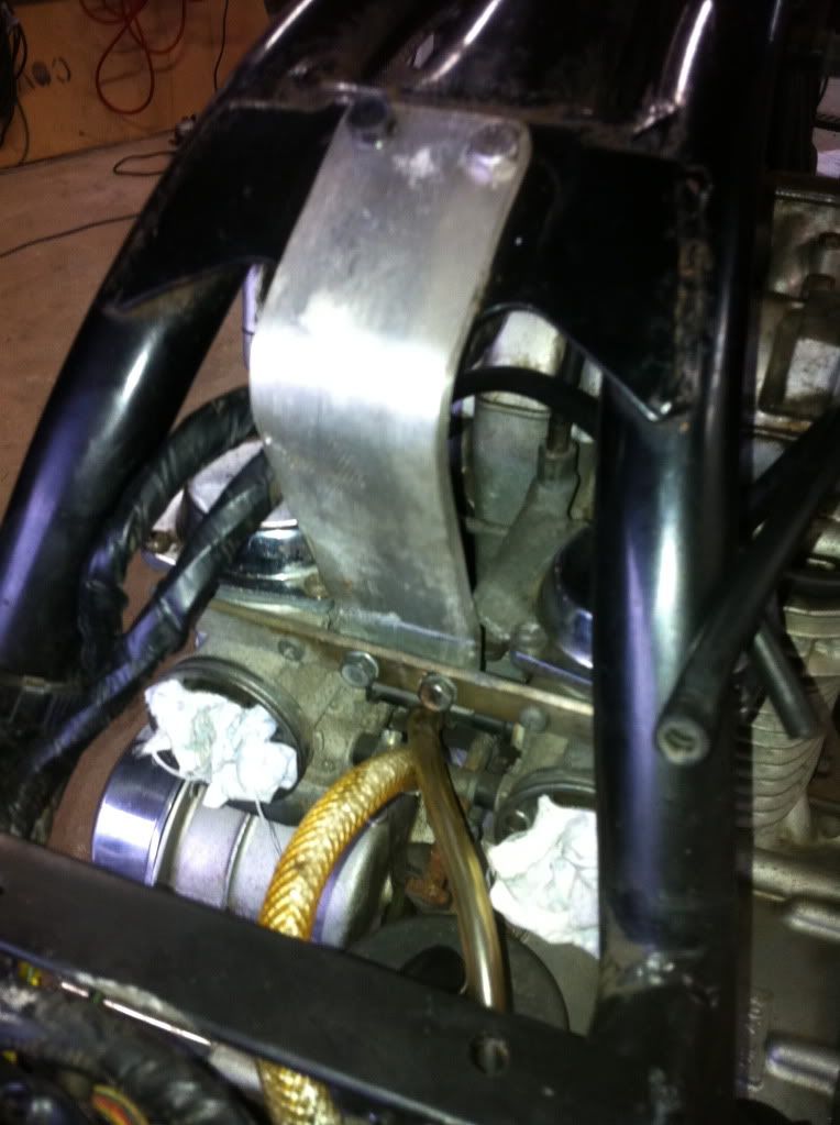

the airbox actually supports the carbs so i made up a bracket from some 4mm ally to stop the stresses of "vibing" carbs, it could damage the diaphragms if the carbs were to 'bounce'..... over a bump or something.
i will take this bracket back off and finish it properly "speed holes/matt black"
trying out some options with the electrics
heard you guys like a gaping hole!?
check out my firestorm.....

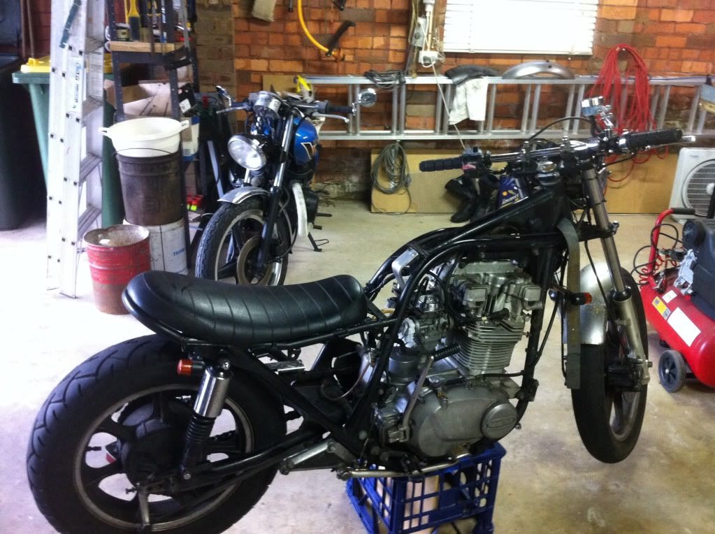

and finally as it sits at the end of the day..........just chilling

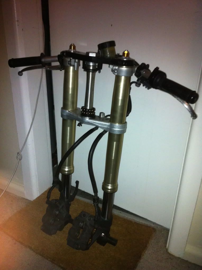

my new front end!!!!!
decided ill throw this 04 r1 usd set on......y not! love the look of the usd's
they will require the use of some usd fork extensions..... as the fork difference in length is about 4 inches.... (let alone wheel size)
my biggest debate with myself is what to do whith the wheels??????
 options arent going to be easy and require professional engineering.......i am aware of the can of worms that awaits...yet eager to jump in....
the options are
1. stock wheels 16 and 19 (painted) matched up to 04 r1 disks with custom axle etc....
2. r1 wheels (17's)
3. building some custom spoked wheel set-up (motard style)
so many pros and cons either way..... ill let you ponder them....

i'm going to use the original wheels..... good idea swivel with the single brake....i mean if they can pull up a 300kmh speed machine on a dime. then 1 of them will be plenty on my lazy ass slow-poker.......plus ill tell all the peeps that i switched to single brake for "weight reduction" hahaha
i like the idea of the hub cab... the rims look sweet as. so i want to show them off (love those enkei's)...
 remove and clean them....repaint all the black, then polish the lip and the side cut spoke detail.....mmmmm
the only thing that kinda throws me off is the 16 inch rear (drum) i would love another 1 or 2 inches of diameter on the rear just to even things out....
but the whole 16/19/usd thing surely would be a conversation starter....
swivel..... i feel like a noob. whats the difference between a ground axle and machined axle??
and thanks for the interest and feedback......keep it coming....(im sure you will)

ok swivel no k180's then........
how about this pirelli on the front?
http://www.ebay.com.au/itm/PIRELLI-SCORPION-TRAIL-DUAL-PURPS-FRONT-TYRE-100-90-19-/330578489248?pt=AU_Motorcycle_Parts_Accessories&hash=item4cf8036fa0#ht_875wt_907
ahah those hubs do look cool.... i would obviosly only be doing at the back.....
oh and swivel i think ive gone back to the twin disc front........(i want twins coz ill still run drum rear and it came with twins.....so ill keep twins) even though its overkill.
also rather than make a new axle could i not use the r1 axle.....and get new wheel bearings with a bigger id?? then just use some custom wheel spacer?? speedo drive dont matter coz i dont use a speedo....

cut out the slot on the carb brace.....(the tank has a tongue which slides in....rubber mounted)
speed holes n blacked out

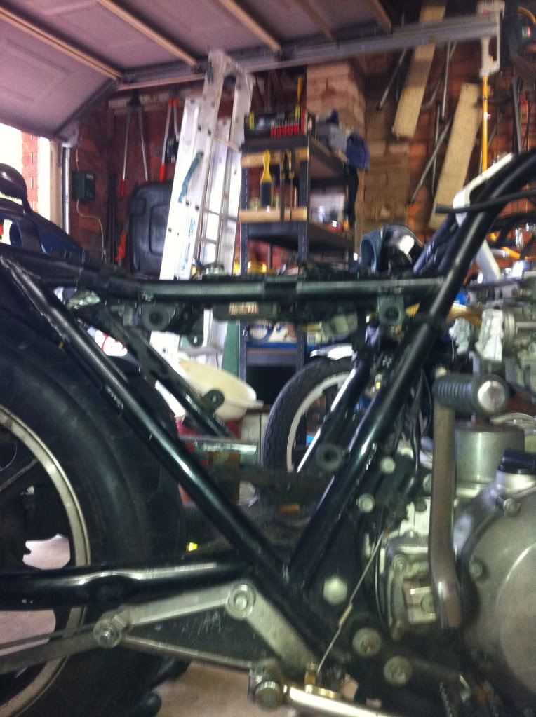

then de-tabbed the rear subframe......and tidied up some of the cables.....opting for solder and heatshrink as opposed to the cable connectors.....i left the old seat mounts because i want to use the old seat on long trips......new ground cable too beacause the old one was about to break.
