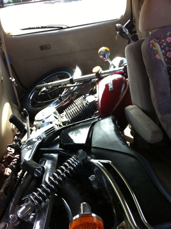

With that bike as my inspiration, I started watching CL, and found one fairly local...and $200 later I had this:
Coming home crammed in my minivan:
FUGLY!
The good news was that the bike has been in a storage space for a long time, and its in decent shape.  Motor turns over just fine, everything works....but it doesn't run.   The guy I bought it from (the original owner) said he had just had carb work done on it 3 months ago and it was running great (dont they all say that?) but that he'd left the petcock on when he put it away those months ago and that the jets were probably clogged.  I took a leap of faith and decided to tear it down first, then work on getting it running once I was all done.
