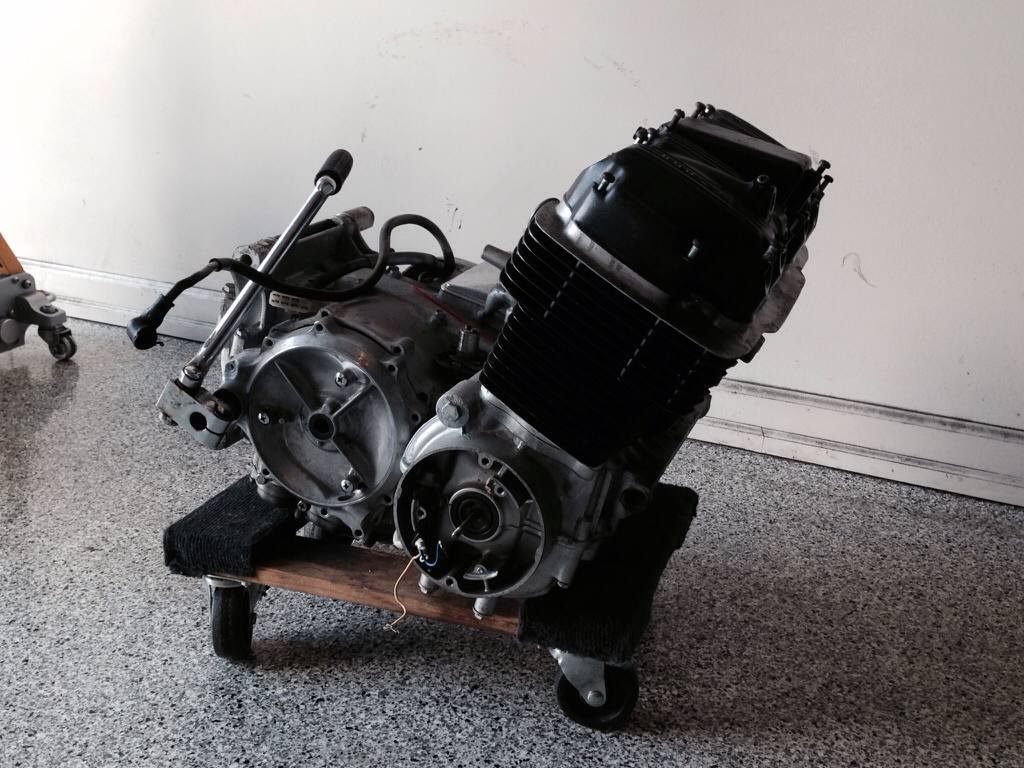

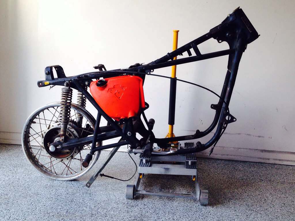

So I picked up this CB750 (frame and motor) a few months back. I want to make this one seat two so my wife can ride with me sometime. Hints the name Tsuma which means wife.

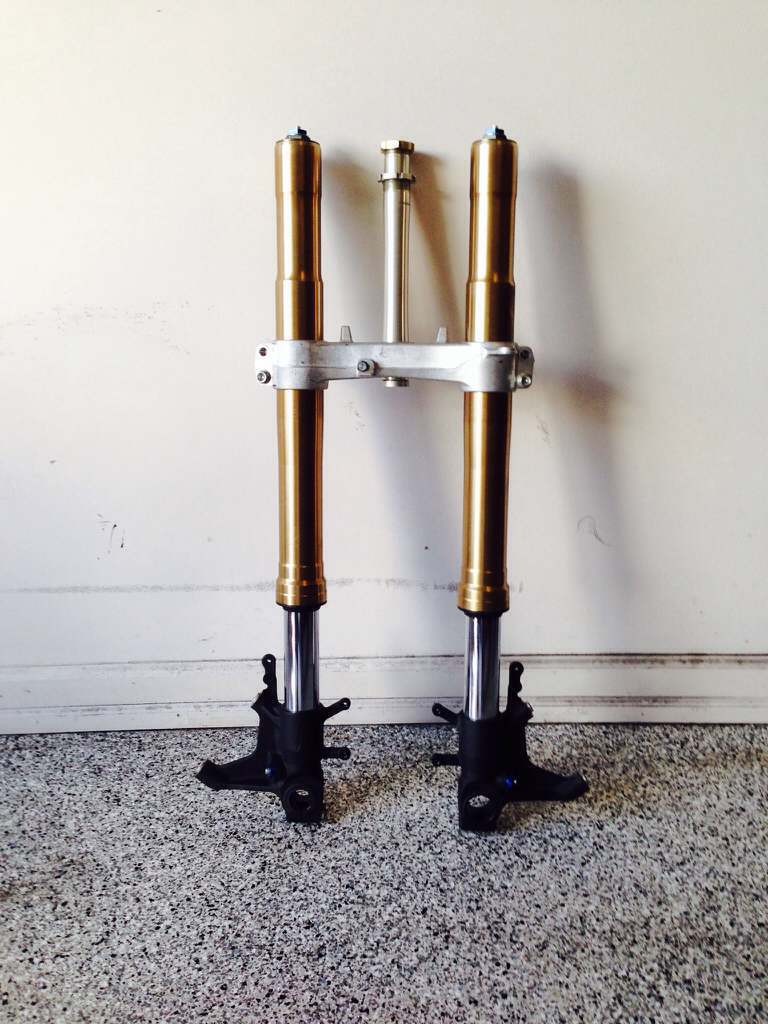

I also picked up a GSX-R fork from eBay for $250 a few months back. It was a deal so I bought it.

Don't have much of a plan at this point. I'm going to start throwing stuff on and see what looks good.

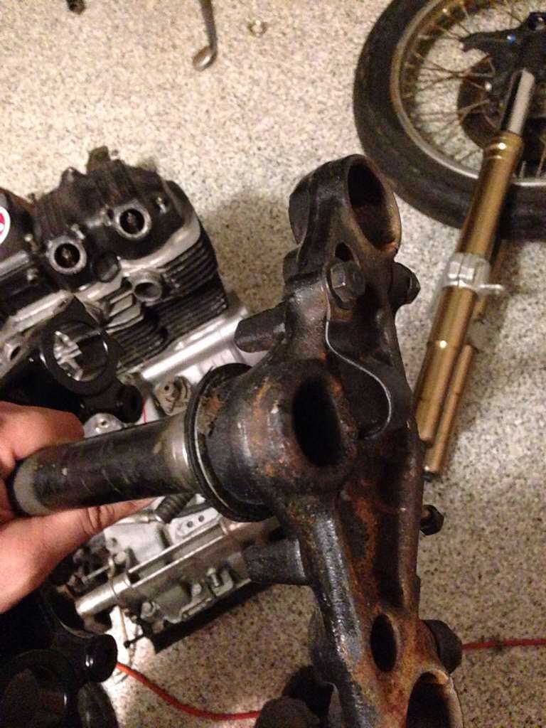

To get the GSX-R stem is to short to bolt on to the CB750 frame so I have designed a longer one to replace the stock GSX-R stem

Just out of curiosity: did you try taking the stem from the stock triple and using it in the GSX-R triple?
I've seen one guy do it online and he had to heat and swell the end of the stem, enlarging it a few mm to press it into the GSXR fork. I'm not exactly sure how he did that since it appears to be one piece or welded in
