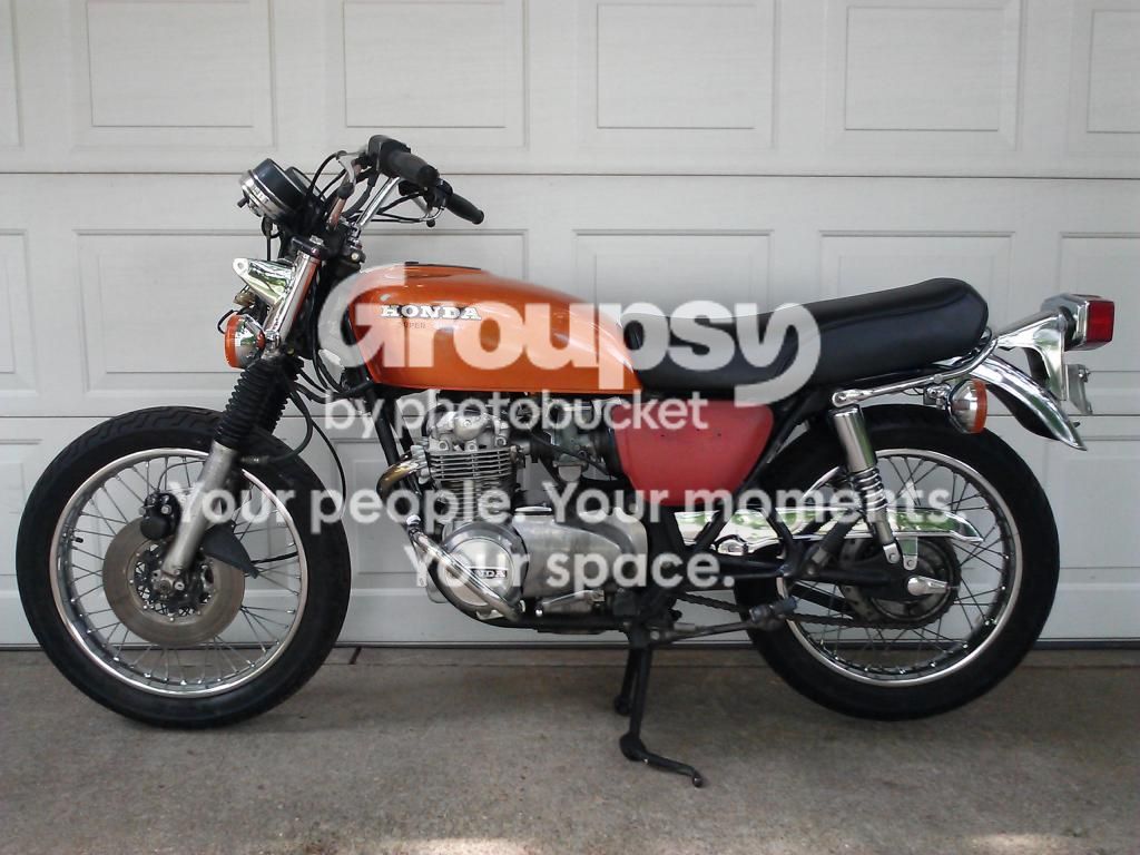

Here are some pics of the bike:
1)
2)
3)
4)
I'm open to all suggestions on things you guys think I need to do. Thanks!

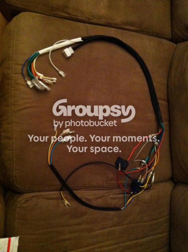

I also received my custom harness from Sparck Moto, it's the tits and I can't wait to put it on...

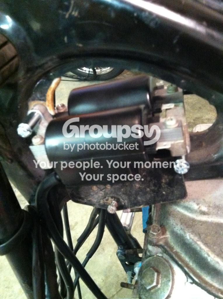

I mounted the new coils...

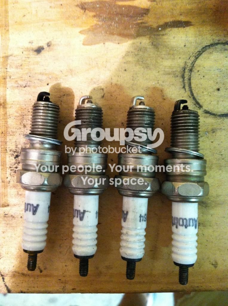

Replaced the old spark plugs...

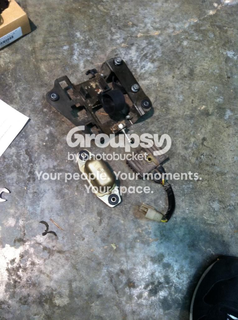

Goodbye old Regulator and Rectifier...
Ricks Combo...

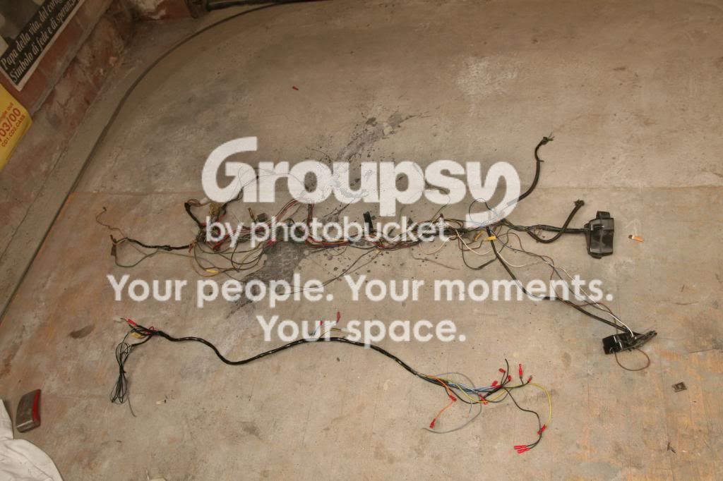

here's what I made of mine:
original on top, new one bottom
Nice! It's crazy how much stuff is unnecessary (to me at least) in the stock wiring.
