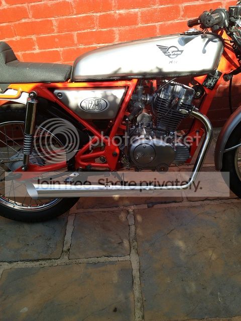

anyway here's the exhaust I chose
very happy with how little it weighs and not restrictive like the black std thing
This thing must have really choked off the breathing , so narrow looking down the through header..

If that is the OO racing pipe, you will probably need some silicon spray to help twist that graphite gasket on. It seems that leaving the header that length is the way to go from others posts. So exhaust pipe may end at back axle nut or beyond.

Thanks for the heads up on the graphite gasket, bit of a tight fit that..
ive cut 3" off the header to help align the rear mount, I think its still plenty long enough and it sounds much better with a healthy response from the engine. At standstill at least...

hey, I've got the same exhaust setup and earlier this week I made my own exhaust damper, because the one fitted in the slash cut exhaust still restricts the flow. Because it enters the exhaust damper pipe, exists from the side into the back chamber and enters from the opposite side again. Should have taken a picture... :)
Have you taken the damper out yet?
If you do, you can ride around without the damper, BUT it is deafeningly loud, especially your right ear, and you lose backpressure. But it's just insanely fun :D

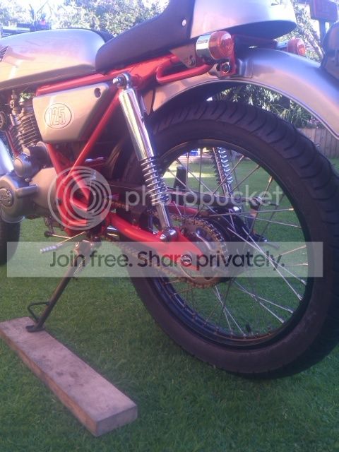

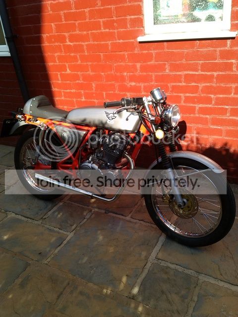

a short update chaps,,
ive been enjoying my little 125ace and had a good few short rides out & about..
few things have come to light,
1, everything needs a regular tightening up if its a little engine gets pushed to its limit :D
2, original tyres are crap
3, rear brake is woeful
4, suspension is a little on the squidgy & bouncy side
anyway , I still love it..

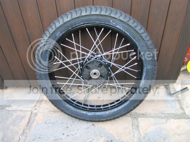

so im on with the wheels as im not keen on these spokes needing a constant checking over..
ive got a spare rear wheel that I had re-spoked and powder coated from a rx-s100 or rx100 known in other countries and with two extra washers it fits right in.
its got a separate cush drive as well and a new metzeler tyre
The wheel will be fitted tomorrow along with a new chain and sprockets , hopefully !!!
bluesmoke said:
its got a separate cush drive …
I will have to find one of those! A huge improvement on the CG125 arrangement.
