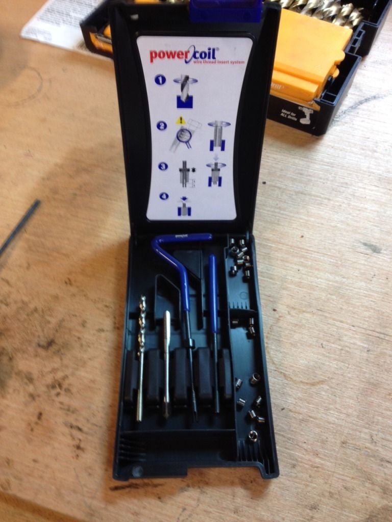

My suggestion is to use a helical type insert. This is what I'd always done previously. It's what I eventually did in this case. And it's what I'll do in the future.
Just in case anyone is interested, that insert kit (M4x.7) is available through Grainger for about $65 and it comes with 20 inserts.
