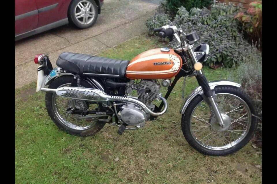

Thanks guys, yep I think rachel and I will get along w the 6v system just fine for the time being.  Shes not gonna be doing any off roading or high speed night driving for quite some time.  lol
DAY 4
She started up pretty easily (5 kicks, more or less)
I got the timing set w strobe light.  Kinda a pain in the butt.  Had to use my old 12v 360 battery to power the light.
Worked on Air/Fuel mix.  Im gonna look into a new carb.  This thing leaks air from every screw needle and the threads around jets.  So it runs pretty sporadically.  When I cleaned it w compressor yesterday.  Bubbles came out everywhere.
Next task is getting the throttle control apart so I can spray some lube in the cable.  She wont even try to return without me rolling it back.  So, idle speed adjustment is almost useless.  it returns different every time.
I ordered an adaptor kit for the compression gauge (12mm plug).
Probably not much happening til after the Thaw.  Be there or be square.
