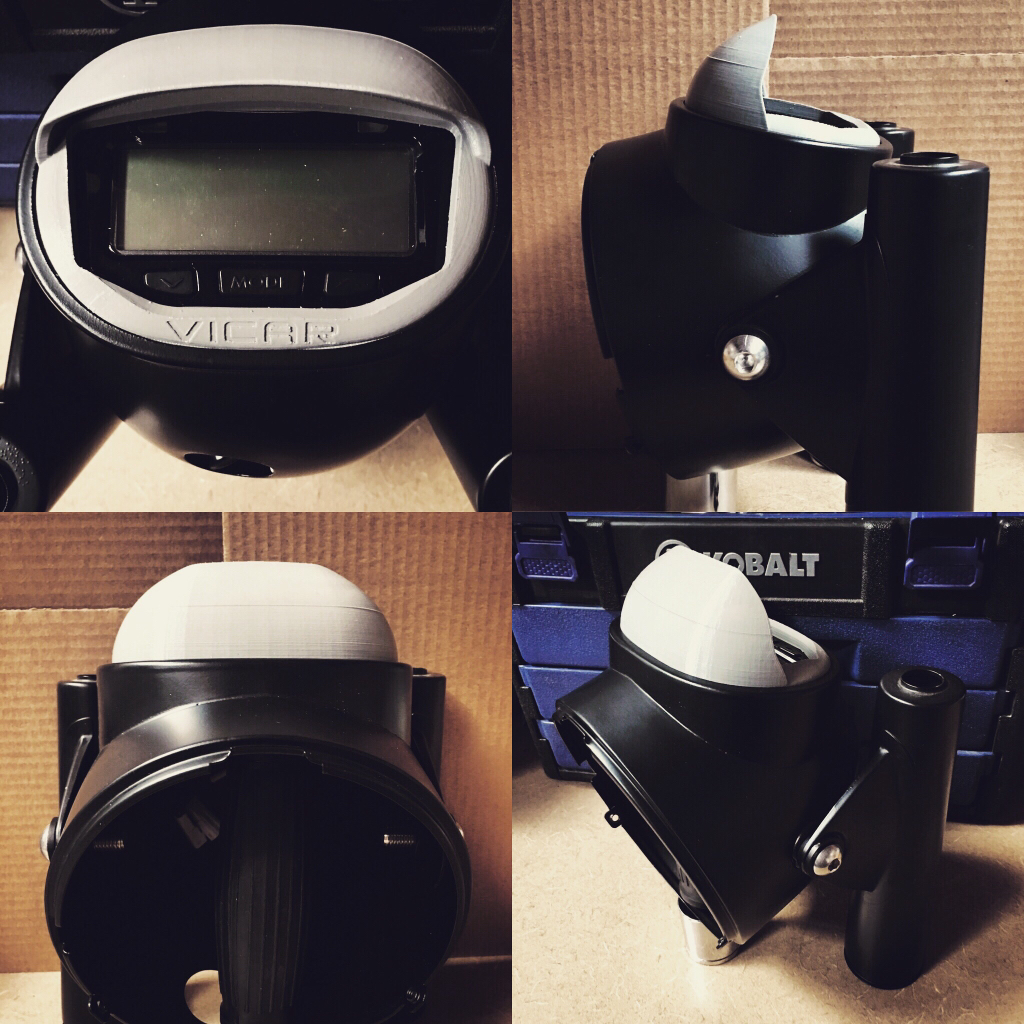

Finally figured out a proper way to mount the Vapor gauges.
Looks off center but it's not.

My only concern with the CNC machining, with the part topography, the surface will have mill marks. Even with post tumbling. I may do PIM or diecasting to get a smooth finish.offroadjeepin said:How does the 3D printed hold up? I'm not sure about the costs associated with injection molding, assuming that the set-up is costly and with only a few parts being produced not worth it? maybe Aluminum is the way to go? Possibly machine out of plastic?
offroadjeepin said:The "hooded" version will have pretty serious amount of machine time. I can see tool marks being an issue. Flat version wouldn't be bad?
