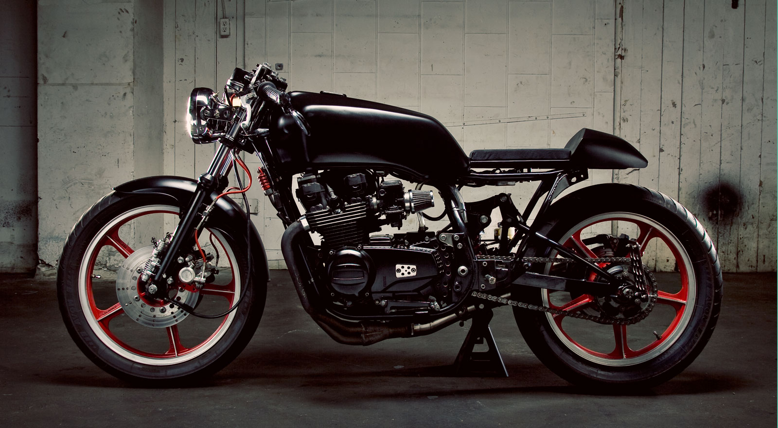

I've been working on a 1984 Kawasaki GPZ 550 mono shock build. This bike (see attachment - '82 CB900F - Rob Chappell) was my initial inspiration. I found others that were similar and I'll attach them later if there is interest.

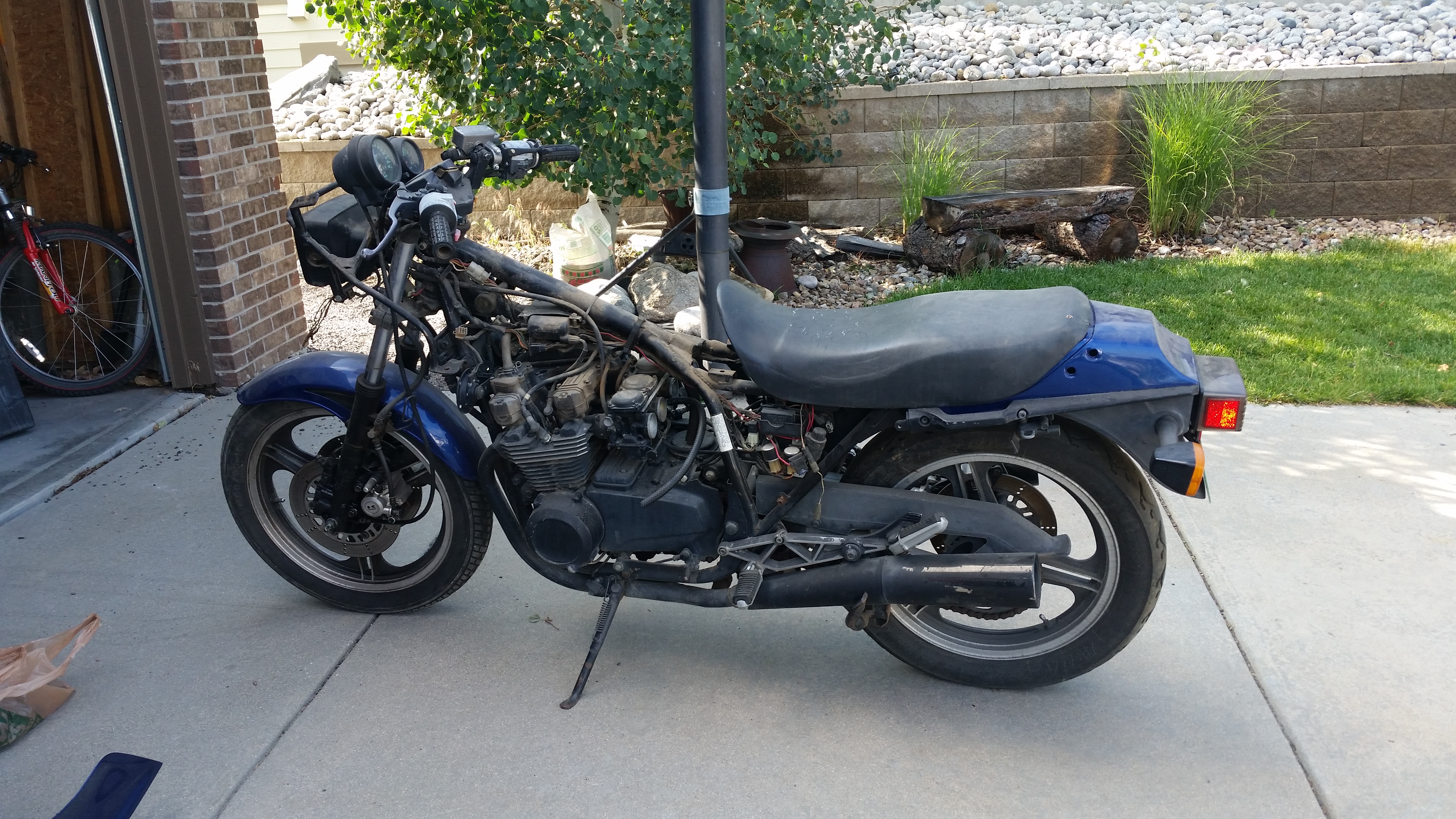

So I started researching the GPZ and found that in 1984 the swingarm was changed to aluminum and got a little bigger, which I liked, but the tank changed and I didnt like it as much. So I started searching craigslist and found my bike. A 1984 GPZ 550 without a tank. It had been sitting and was last plated in 1997. I bought it for $700 bucks at took her home. Here she is on day one:

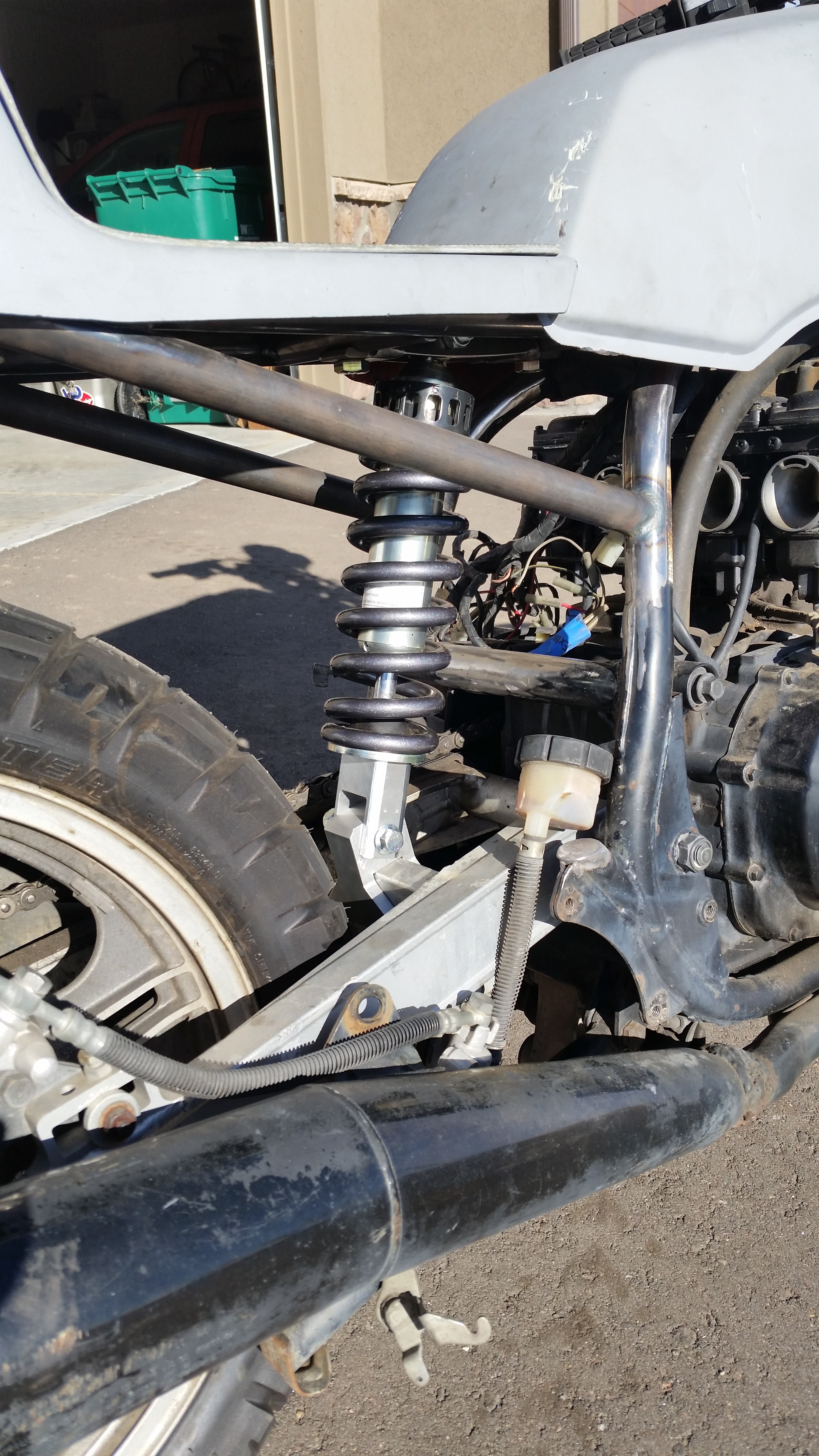

Here are some better shots of the top mount when it was tack welded in place. It has been finish welded since these photos were taken:

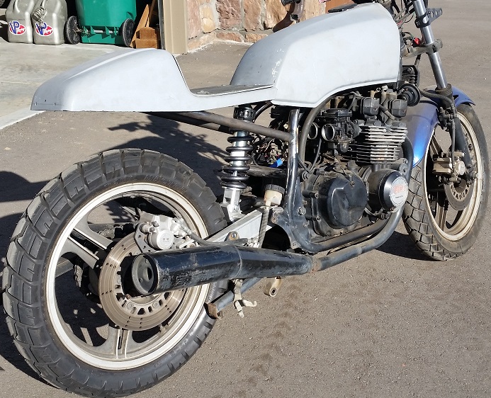

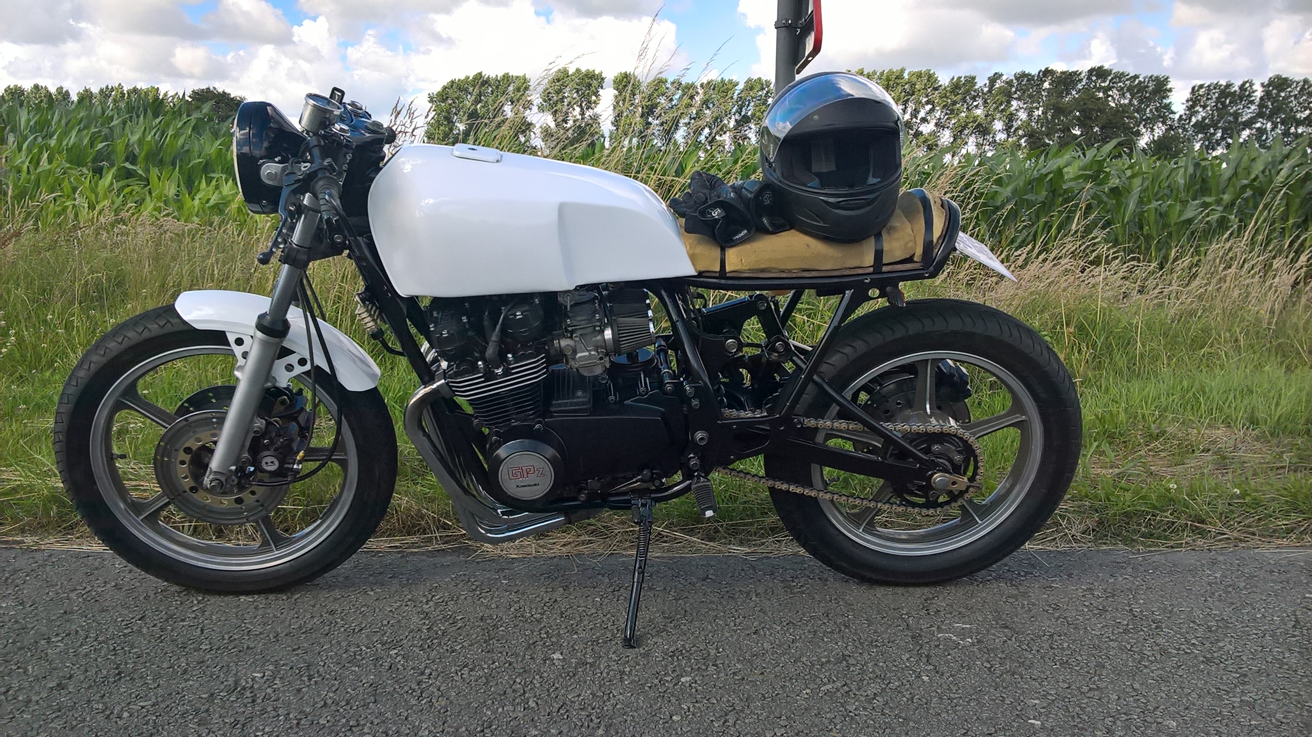

I'm with that Limey bastard (I'm one too ;D) on the tank. Trim the bottom to flow with the seat. I like your vision for the bike :) Is that shock from a linkage setup?
I'm working on the same bike, and modified the tank by cutting the walls out where your knees go, and then making steel plates to fit. I brazed the plates in place on the tank, and it turned out really sweet (in my opinion though).

I love the shock mount solution, very neat.
