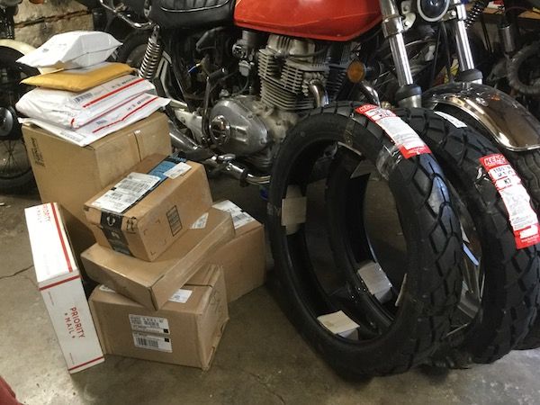

The first wave has arrived.  Stragglers will be trickling in over the next week.
