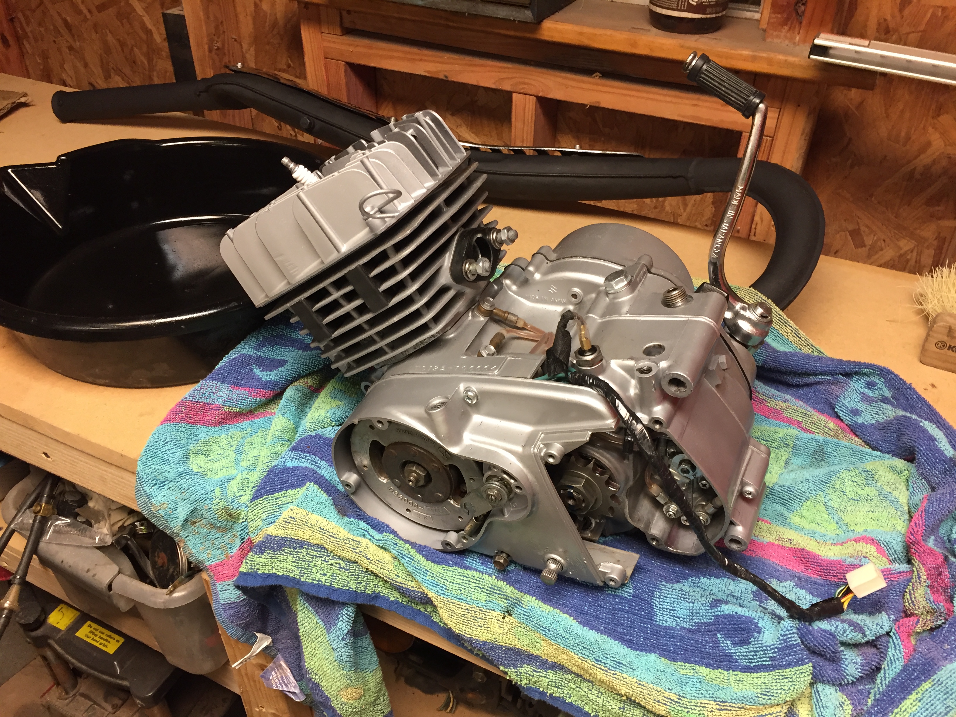

However, during this series of mishaps I discovered that the kickstarter gear is completely botched. The ratcheting mechanism only grabs about 10% of the time. So you can kick it over a couple times then bust your shin open when it doesn't engage. Awesome. I ordered a new assembly and annoyingly pulled the motor out to prepare to split the cases again.
On the plus side, this motor takes about 20 minutes to pull and it only weighs about 25 lbs, so it could be worse.
You sure it isn't just the drag spring on kickstart? very unusual for the gears to be trashed unless teeth are broken off
I'm not sure what it is exactly. Its probably the spring or a worn mechanism. The gear looked fine to the untrained eye when I put it back together. Either way, all that stuff happens between the crankcase halves, so they have to be split to assess the problem.

The gears can 'look' completely worn out but still work , the internal springs always look OK(it's obvious when they are broken) but can be completely worn out.

I can't decide if I like the left side of the crankcase more or the right.
It's a split decision.
Thanks, I'll be here all week.
