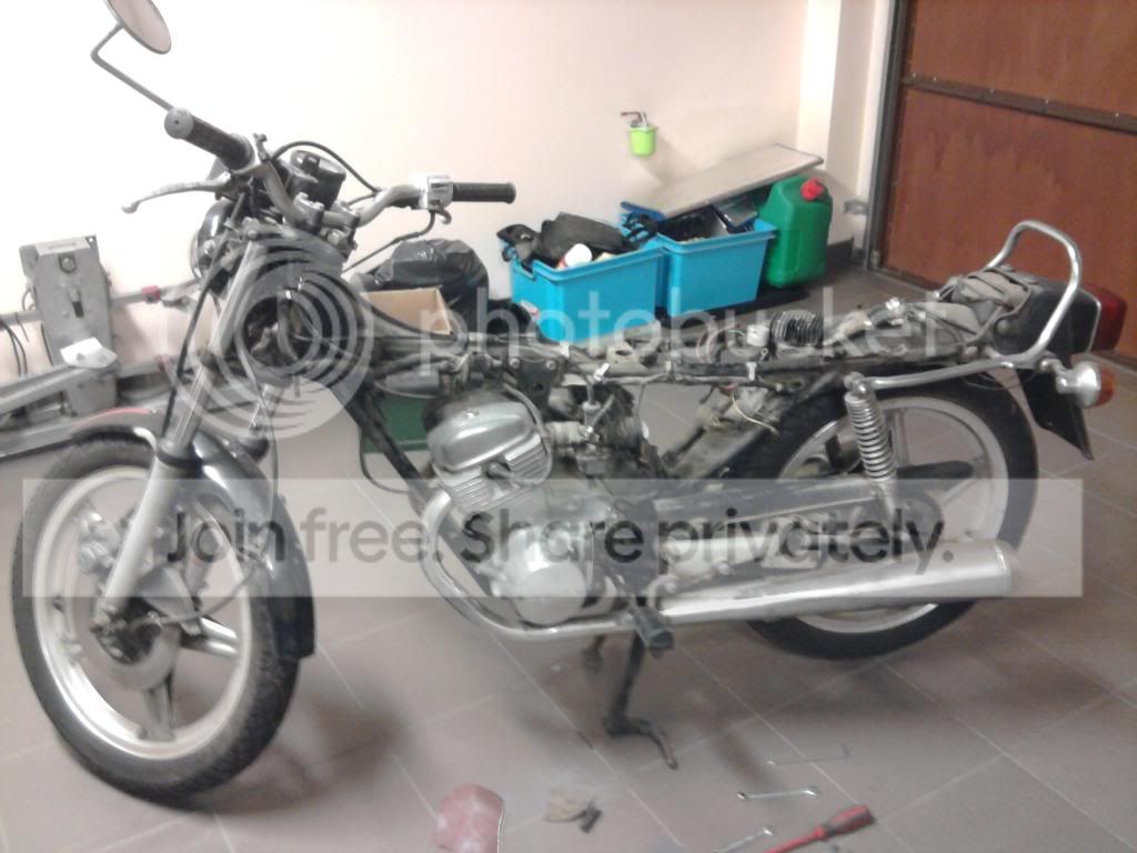

The bike as I bought it:

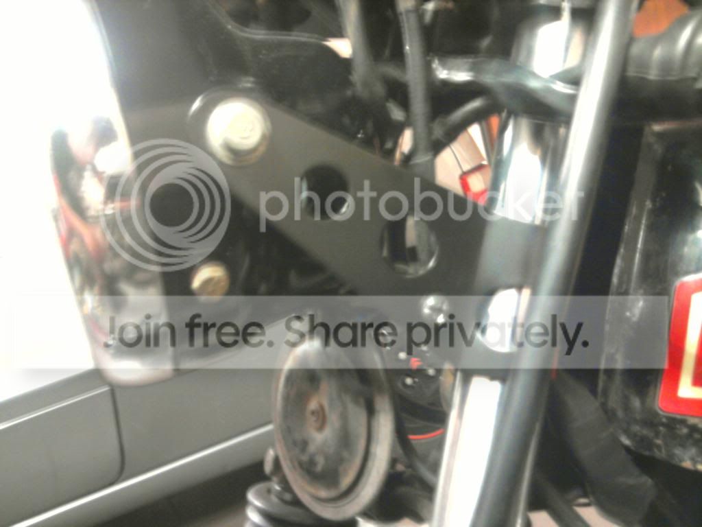

-headlight brackets:
index.php

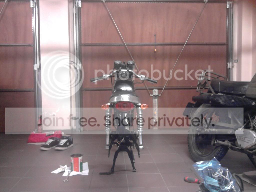

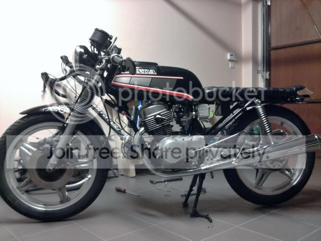

how the bike stands now:

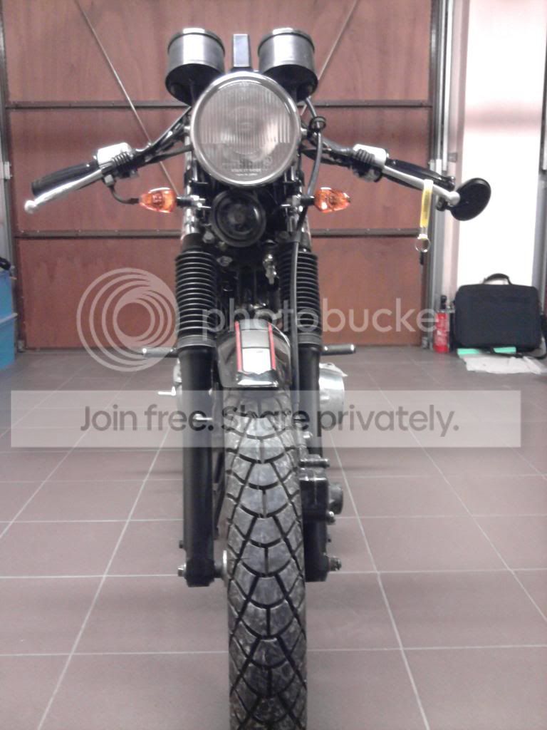

Shot some more pics to give you an idea of the bike:
headlight clamps:

Good weather driving with open air filters:

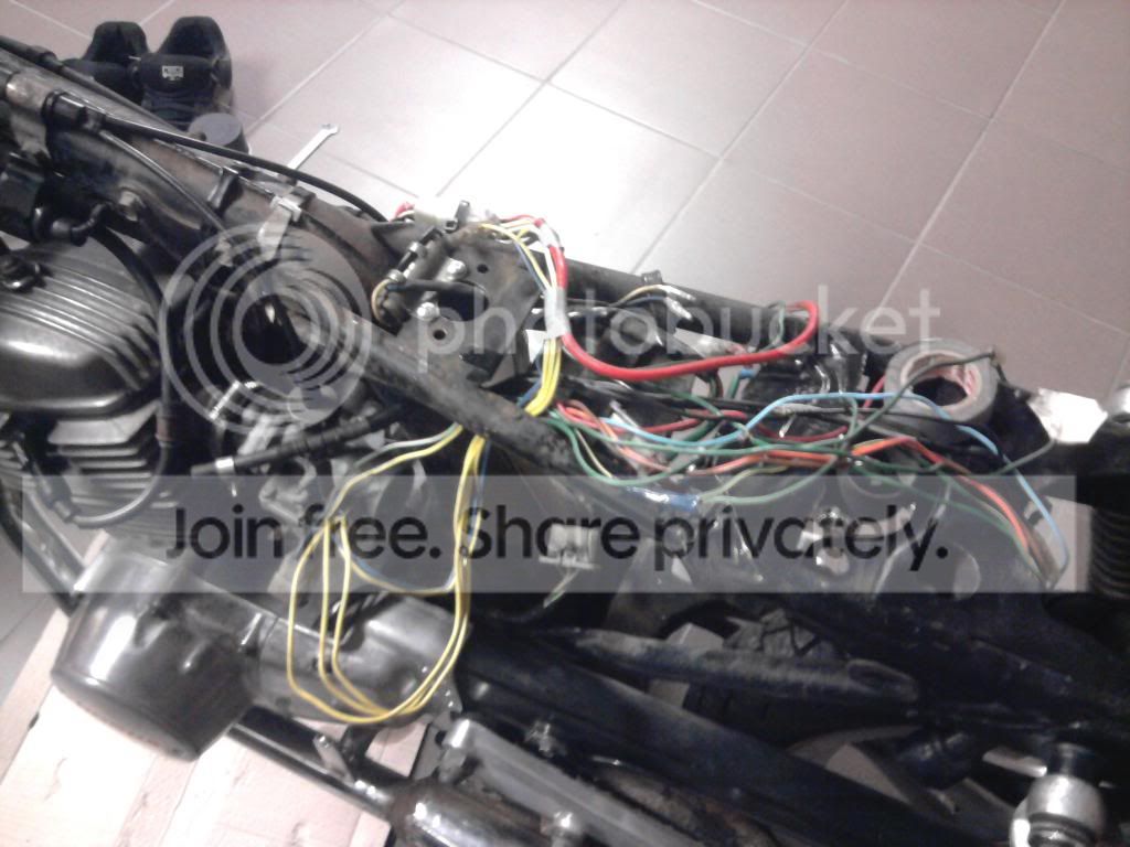

also messing around with the wiring to get everything tucked away

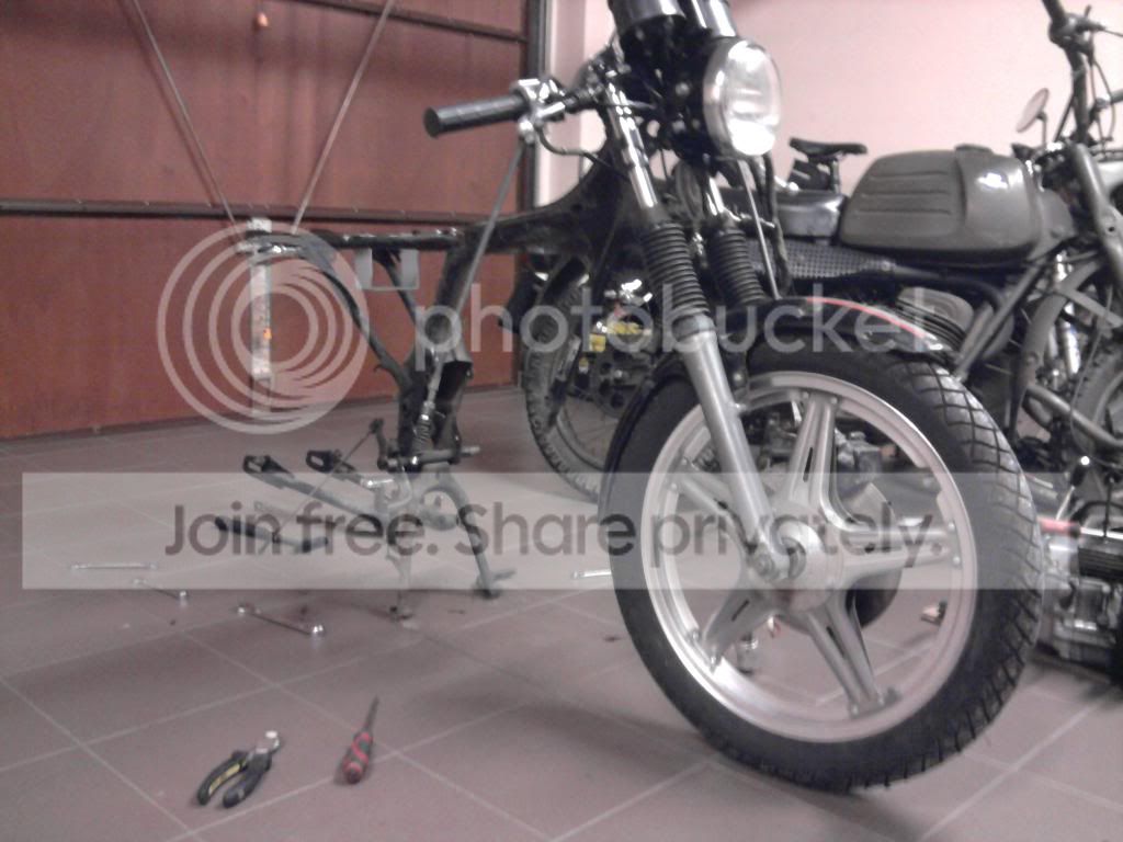

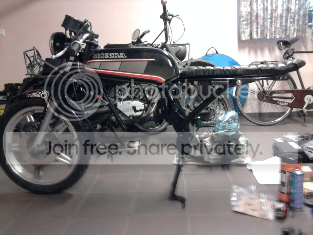

So, little update from the last few weeks:
First of all i modified the brackets for the passenger footpegs to mount the rearset on, and designed a system with a cable to connect the brake to the brakelight switch.
After i knew everything fitted it was time to drop the engine out, take the cylinderhead to the local honda shop to get the valves closing properly, new valveseals and to clean the exhaust ports.
When the engine was out it was time to strip the frame and repaint it.
The seat was missing something so go to work with some junk metal and created this
I like it rusty
Cylinderhead is coming back tomorrow so i'll try to get the engine back in as soon as possible and let's hope she'll be good to me and start up without any more problems.

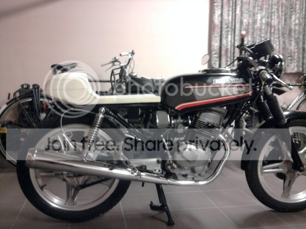

Got her back from the local specialist, and she is running great. just rode her home and it's just unbelievable how good she runs!
The only thing left to do is change the left ignition breaker because she misfires when she goes over 10000 rpm.
Now it's time to ride her and when winter arrives she will get a small makeover... Because the little bitch needs a cafe seat!

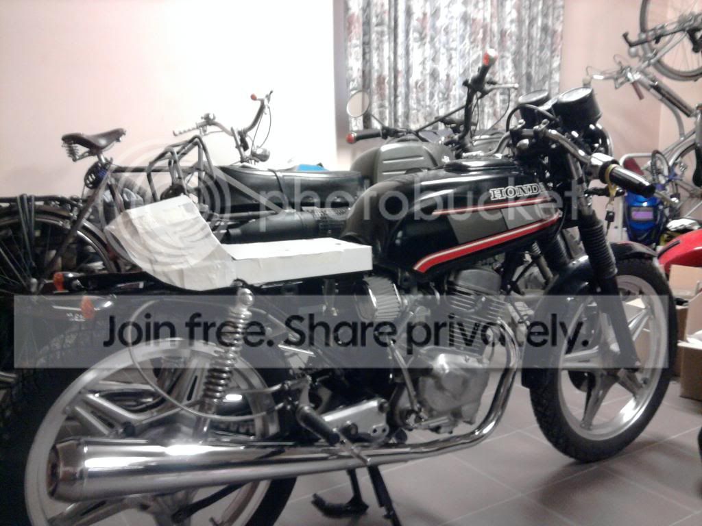

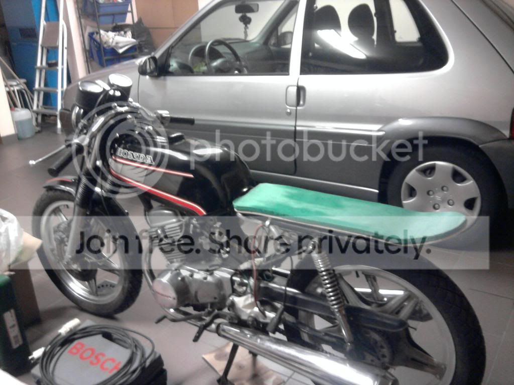

So a bit of progress:
plasti dipped front forks and tail
blinkers in the front
cafe seat cardboard mock up
I will start on the mold for the seat as soon as i've got some time this week. I'll be making it from isolation board my grandpa got laying around. Can't wait to see my parents pissed if they find the garage dusty as fuck again...
