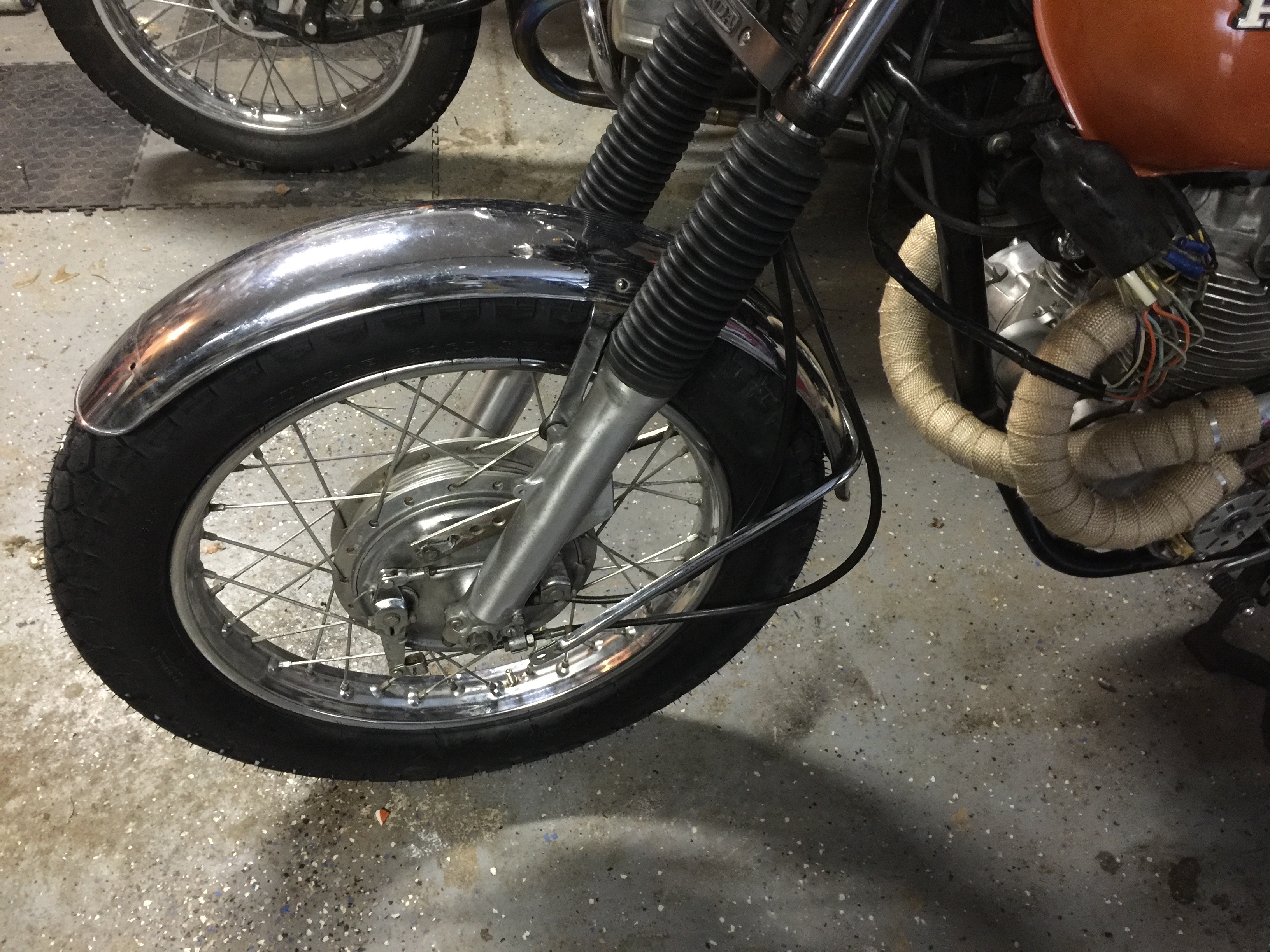

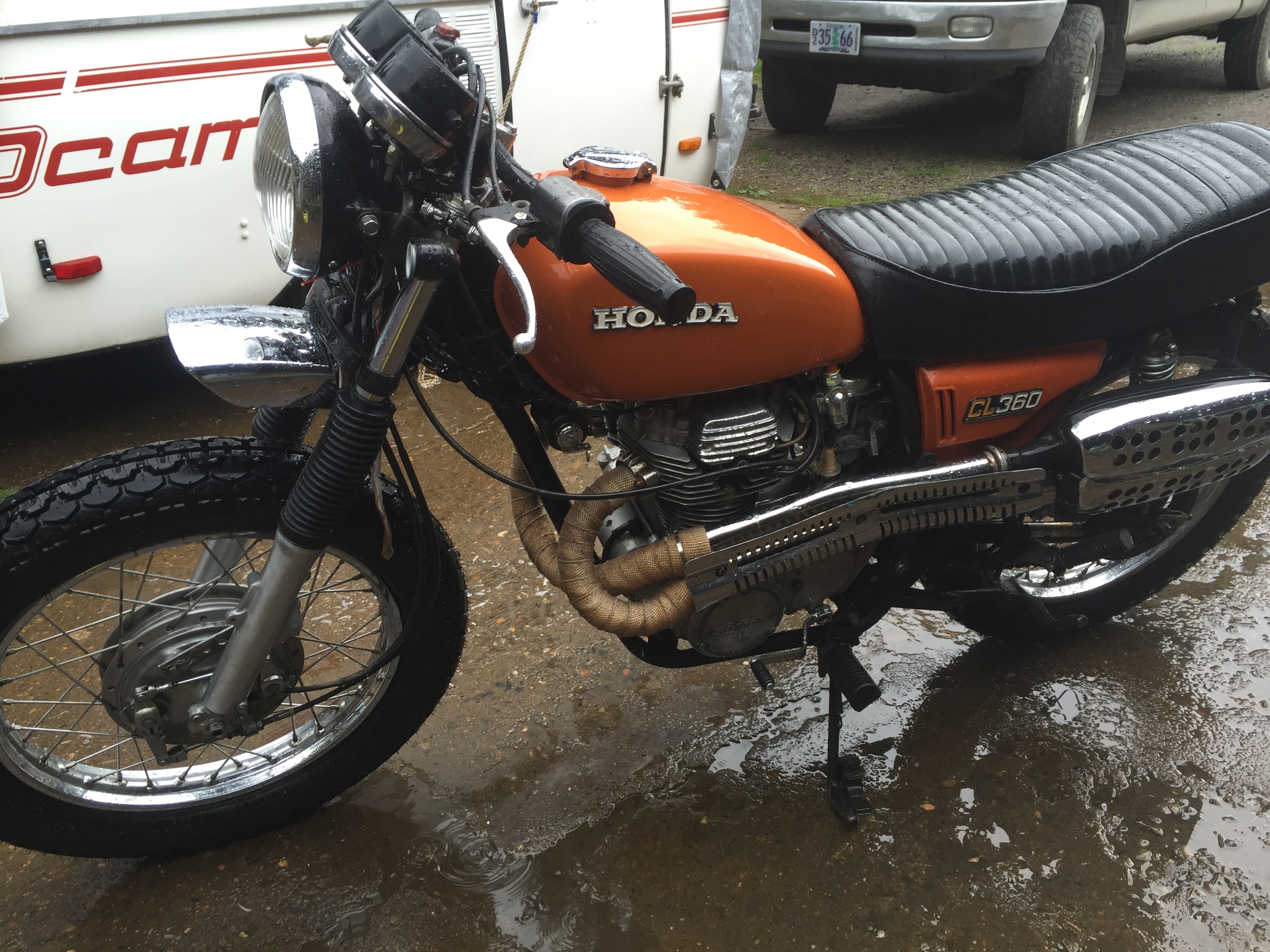

New Shoes
Photos of the new tires i put on by hand. Front rim is a little narrow and i most likely will get a wider rim in the near future.

Nice clean bike. Did the heat shields come w it?
Do what you want to it.
Thanks! Yes I do have the heat shield— however its missing the rear bolt mount from the exhaust. I think i'm gonna just float a metal bracket behind the exhaust and bolt it that way. I think i am going to get rid of the white exhaust wrap too, maybe paint it black so the chrome pops a little more.
I am kinda of in limbo right now— ditch the fat seat for something thinner and shorten it u, add a hoop. Or leave the stock seat and possible thin it down a little with some good memory foam.

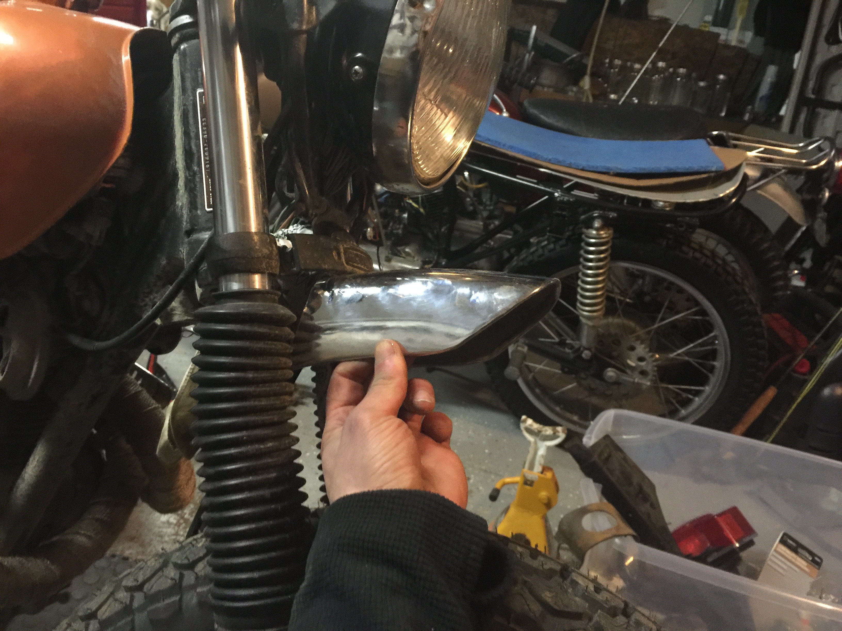

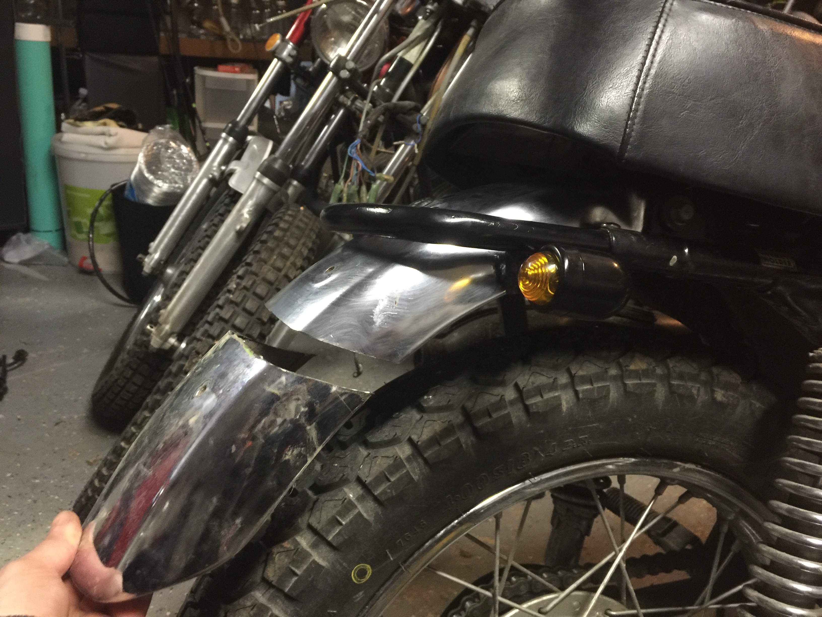

Trimming fenders

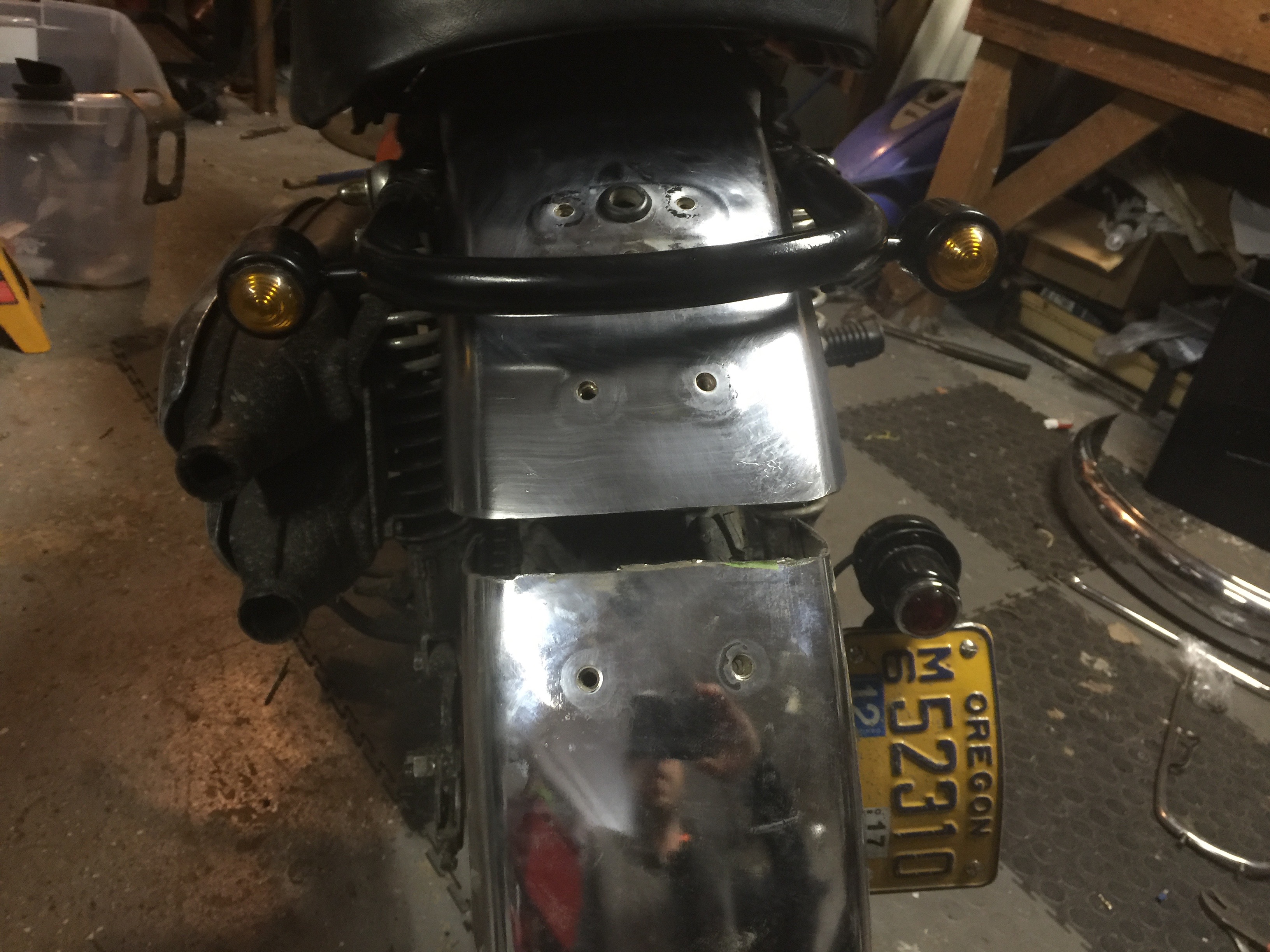

I wanted to ditch the use black light and after doing that the rear fender was just too long for me.
I thought it came out already there a few extra mounting hole that I am hoping to cover up with a smaller break light. if you guys have found anything similar to what I'm looking for please share a link.
after driving around a little i really need to get that front fender remount, I need to extend it somehow. Time to learn how to weld cause i really hate eating mud! for now i mount the extra piece of the rear fender to the front with an "L" bracket, it'll do for now. But that support bracket is a must for me.

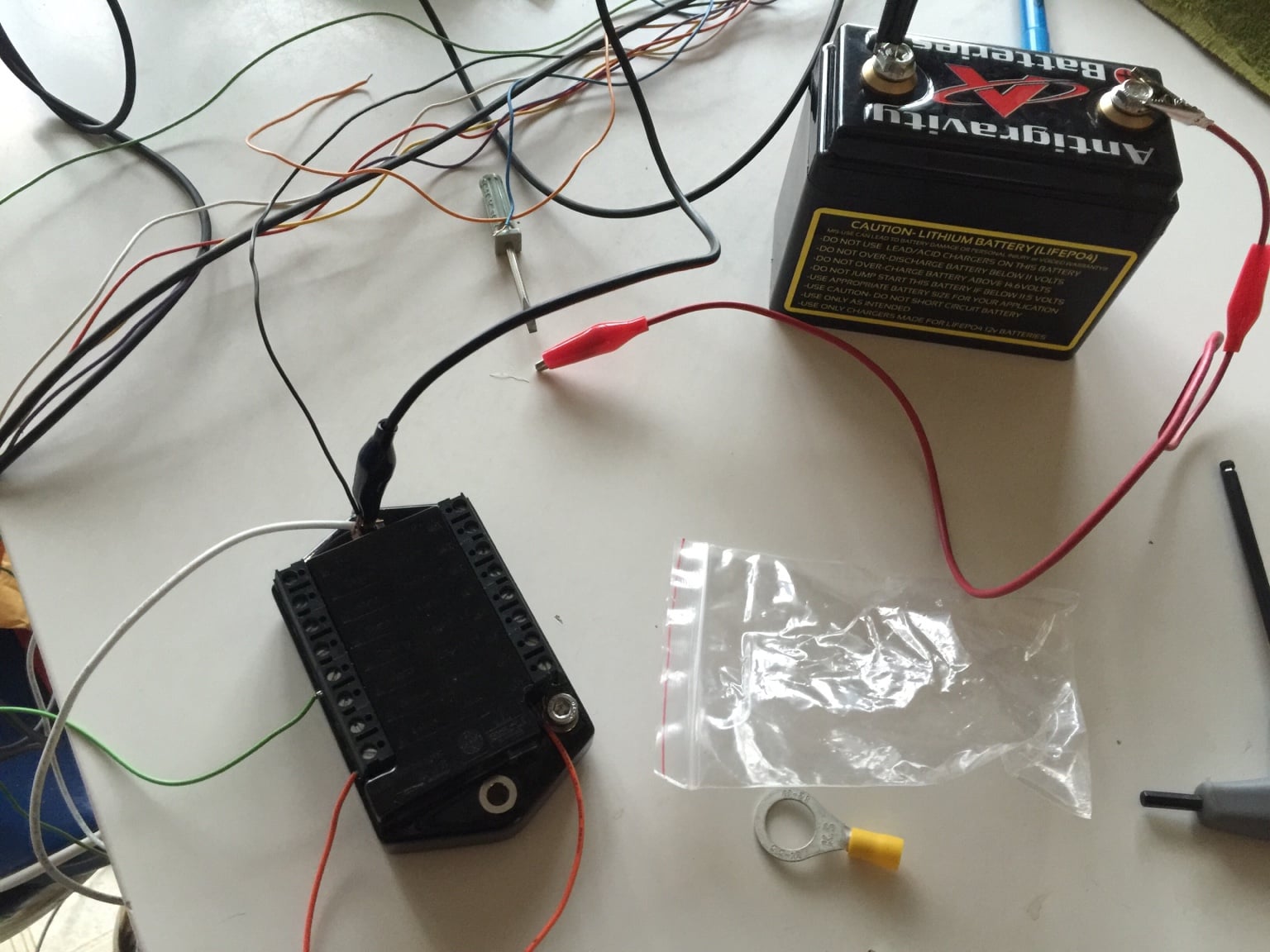

in the mean time still waiting on a backorder for all my Motogadget stuff to come in from Germany. I am doing some pre-wiring for the new gauge(s) indicator lights and headlight wires that will go directly to the M-Unit. The plan is to make these wire hidden as much as possible and clean. I bought a male/female connector plug kit from Radio Shack but i am not too stoked on the quality and its not water proof.

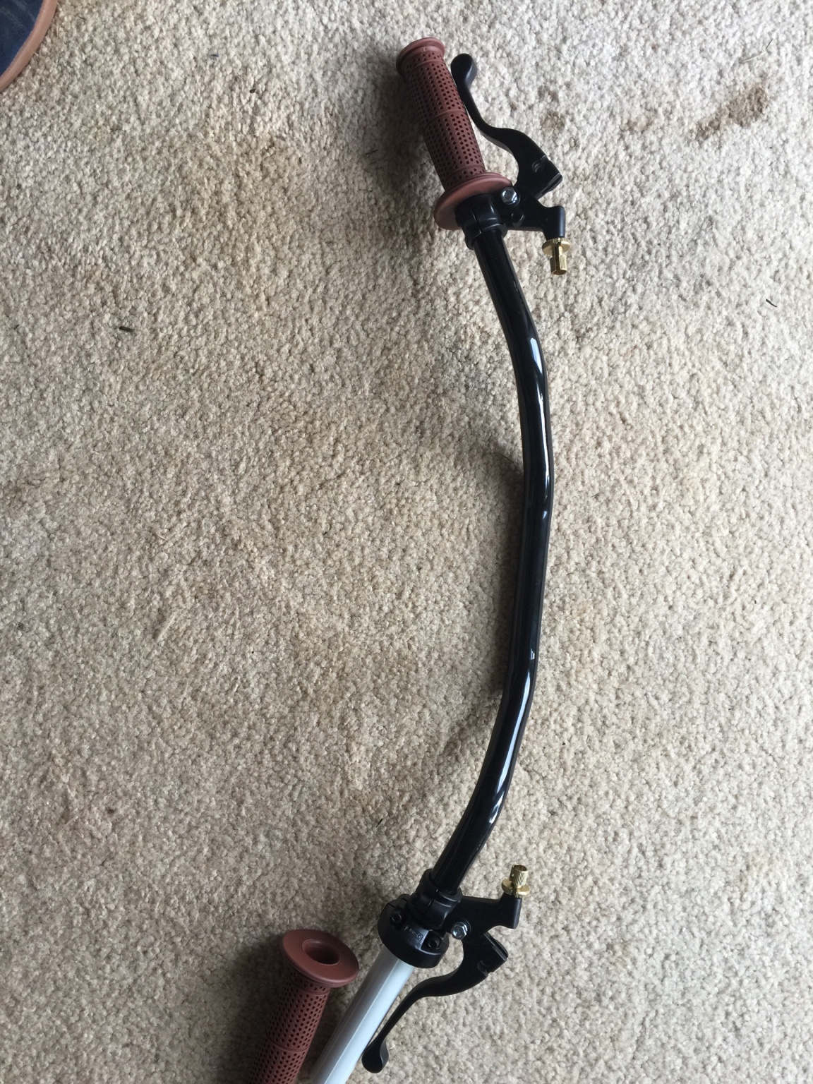

Started working on the new handle bars and electrical system. It's looking so sexy can't waiting to get this bars and motogadget items on the bike!

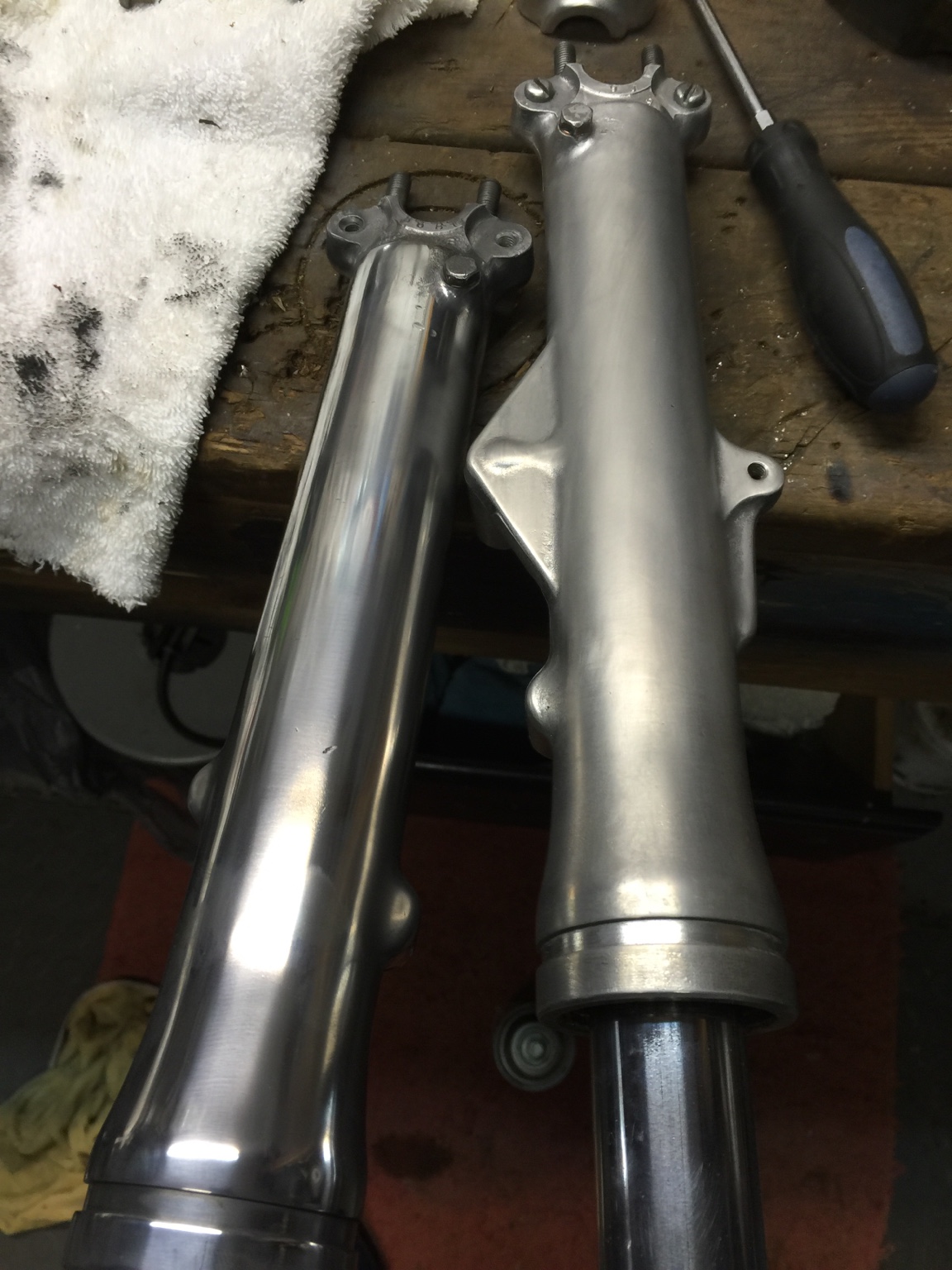

Got the forks polished and looking good still need to seal the aluminum. Installed new gators, hesdlight / mount, new DM gauges. Also installed my Moto gadget m-unit.
At this point I have every running. Still seems to be running on only one cylinder can't get it figured out no how many times I set the timing. Seem like the left bank points keep moving. Sonic waiting for a response from pamco and ditch the points all together.

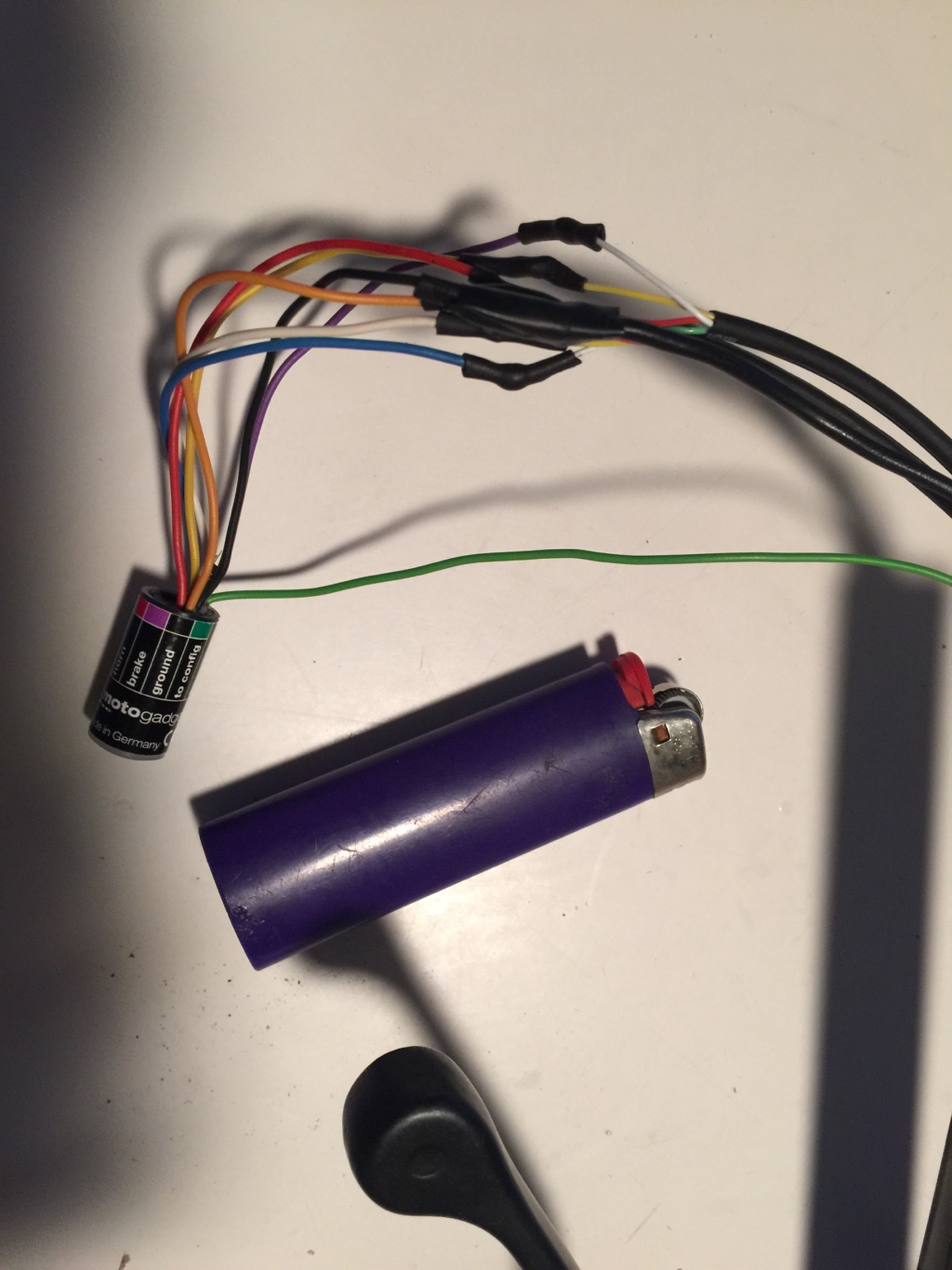

Started cleaning up the wiring for the m-unit. Almost happy with it think I will wrap it again with some plastic mesh wire covering to take it up a notch. Also got gas in the painted tray and it stripped it. Gonna powder coat he frame so I'll add that do the parts getting painted.
Figure out the neutral light and a ground wire of the neutral switch needs to come up to the elf rival box and use a extra wire I put in the hardness just in case to the gauge with the indicator light.

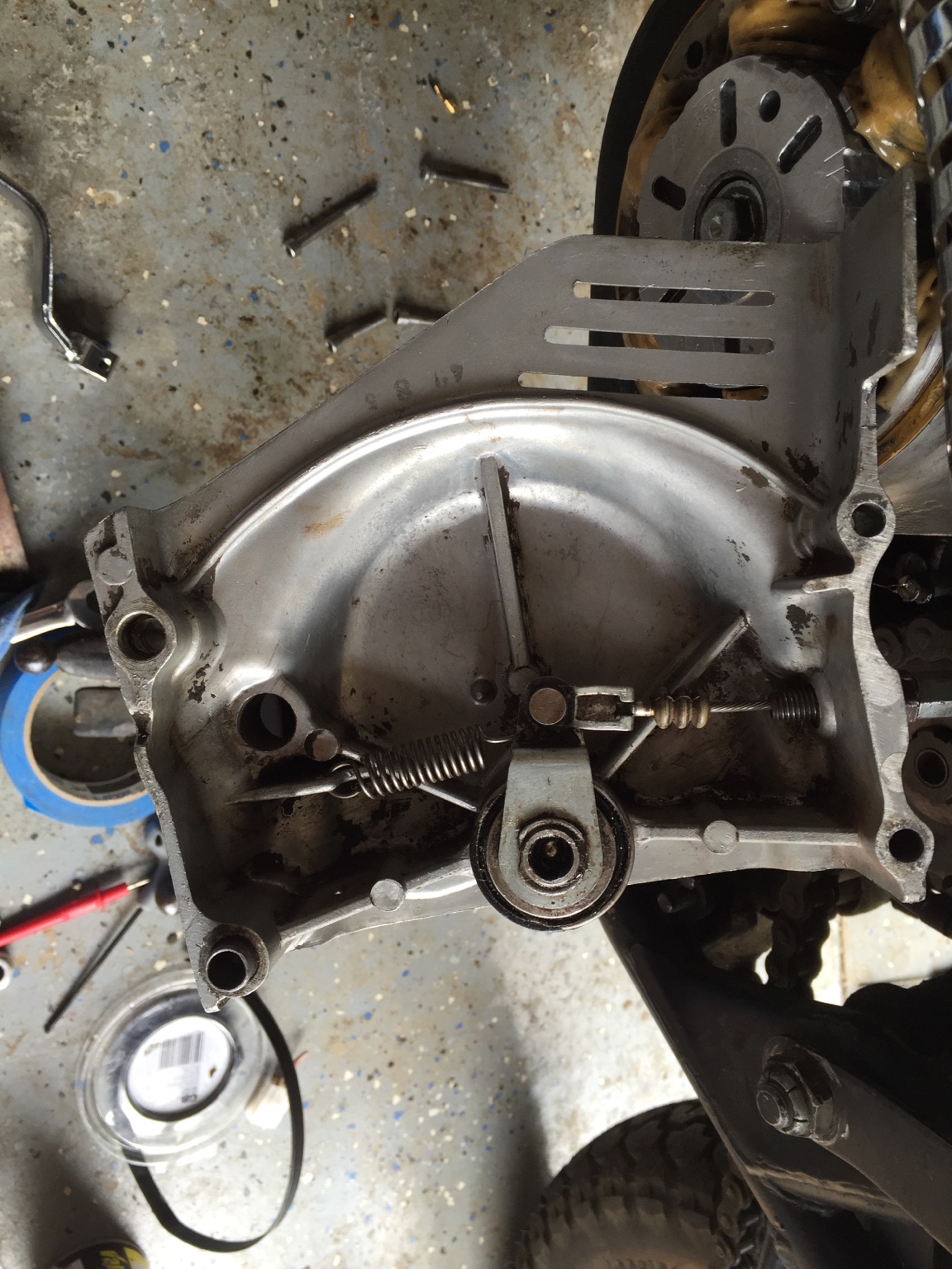

Having issues with the clutch assembly popping. I think the after marker clutch lever is giving me the issue. Gonna cut off half an inch of the clutch cable shielding and see if that enough slack for it
