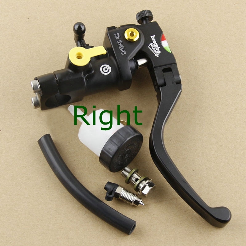

here's one:
http://www.ebay.com/itm/Right-19RCS-Adjustable-Radial-Front-Brake-Master-Cylinder-Motorcycle-Universal-/282031000764?hash=item41aa5b8cbc:g:dIEAAOSw4hdXH3bH&vxp=mtr
