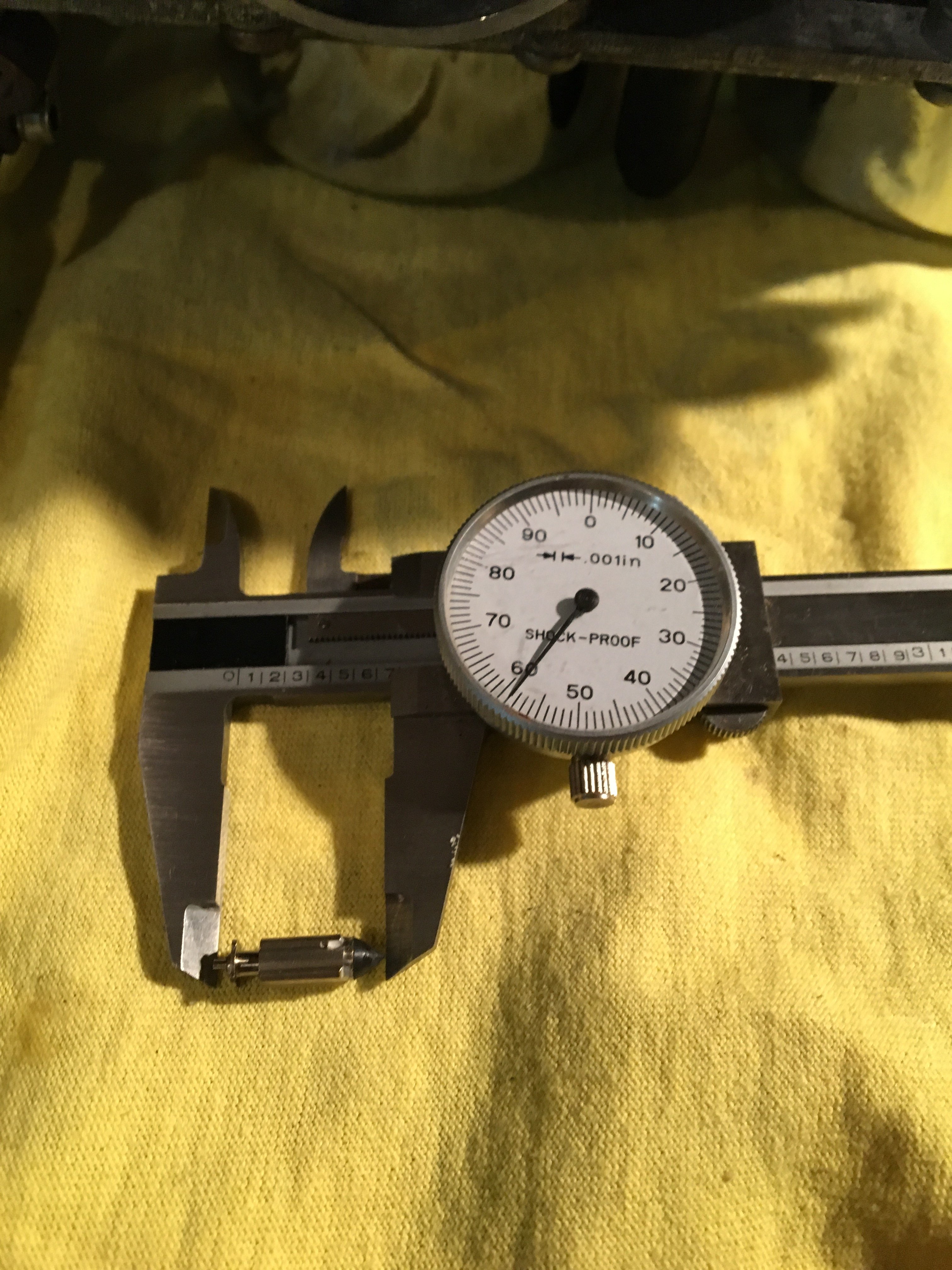

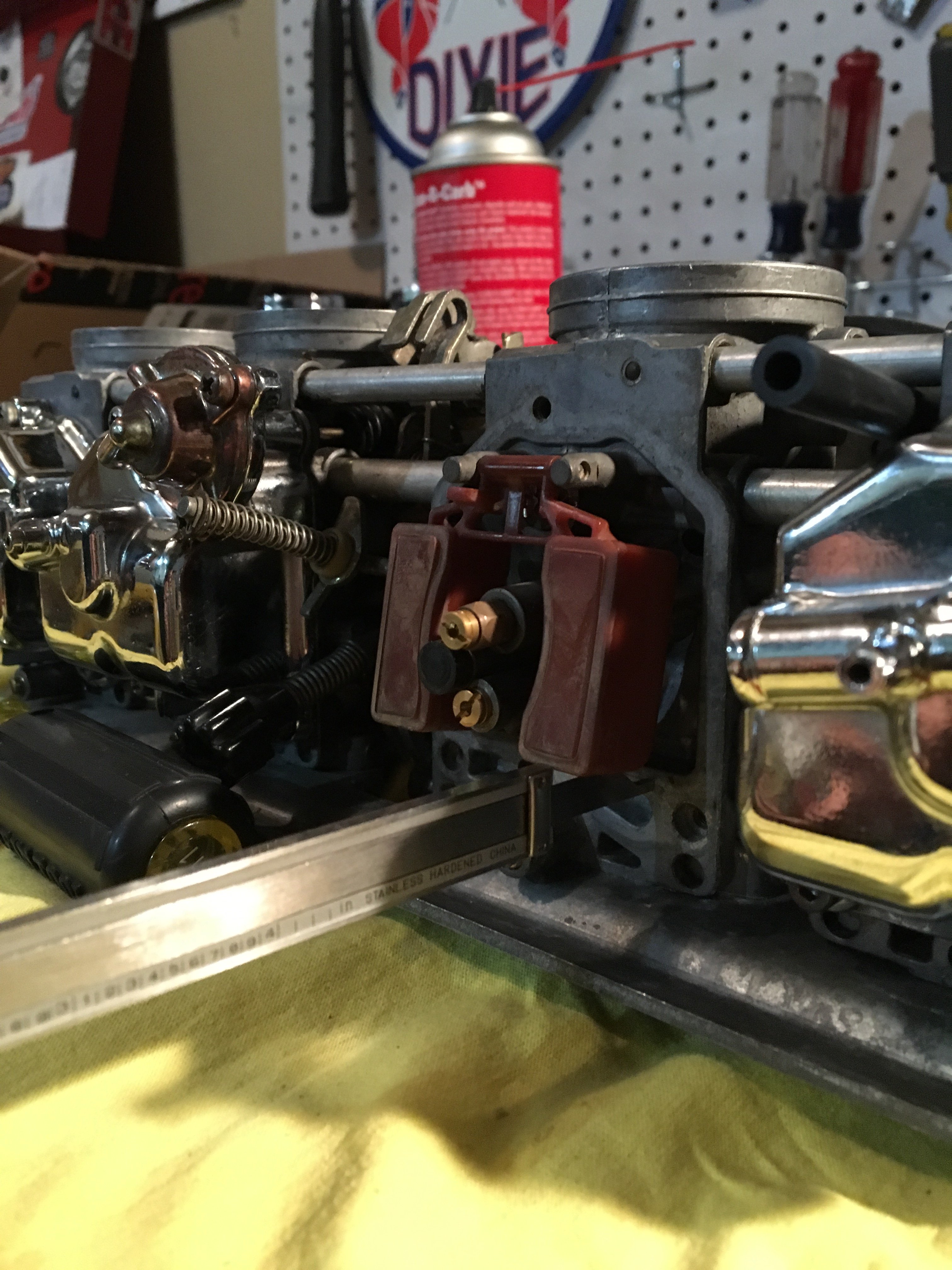

While interrogating my carbs, im noticing all of my floats are consistently out of spec. These are the plastic non adjustable type. Im measuring these with the floats hanging down. Honda says theyre 0.61" from carb base, mine are 0.8-0.9". Im thinking a possibility of incorrect float valves or is it reasonable that these are just old and their warped equally over time? The valves measure about 0.68" in total length. I'd hate to spend $100 on new floats to find out the same measurements. Please tell me im missing something here.

Float valves look good, no indentations or wear. When i pulled the hinge and look at the floats they dont appear to mis shaped in anyway. Im really starting to think ive got an incorrect (longer) float valve to make this thing stick up so much higher. Any shop guys or carb gurus with a few of these around take a measurement??? Mine are about .68" long.

Do the float needles have spring loaded tops? I think you might be measuring them wrong if they have - carbs should be at about 45 deg in most cases.

The first digit of the scale is on the base of the caliper (hard to see in the pics) The general measrument of these valves is 0.658" and yes they do have a spring loaded pin on top
You don't measure float height like that. Carbs should be set at about 70 degree angle so tab just touches pin of shut off valve.
They are adjustable but you have to be real careful not to break stainless tab off the plastic
