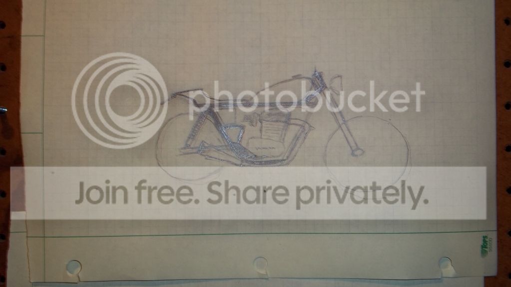

I sketched this up (actuall about 4 of them) to decide what type of tail section i liked. This one is the one I think Ill be making, still need to figure out the rear profile, but its a start.

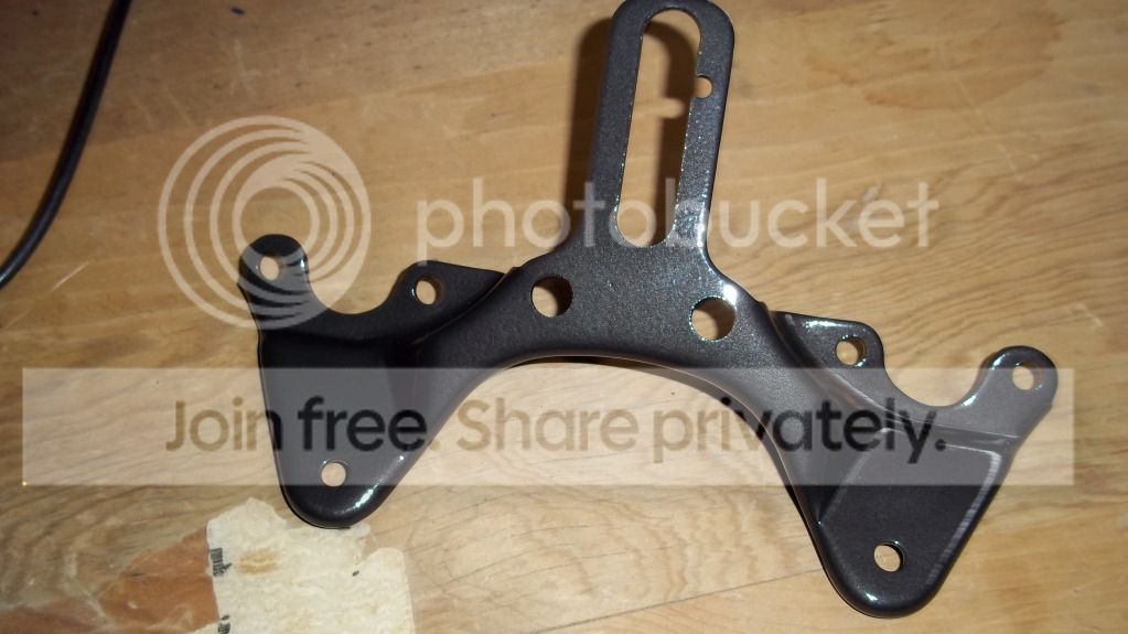

when my fingers were numb from pulling apart the harness and peeling of old tape I decided to start painting a couple of parts. here is the speedo/tach bracket... also painted the ignition switch and guage housings the same. all of the brackets on the bike will eventually receive the same. Its Rustoleum hammered metal finish. actually turned out pretty well, at least i like it!

Hammer Rustolieum stands up pretty well I have about 3 seasons on brackets I did in he silver and it still looks great. Some of the other paint I used, not so much. Your paint looks good to me. good idea to rewire, PO splices have a tendancy to crap out on you at the worst possible time.
