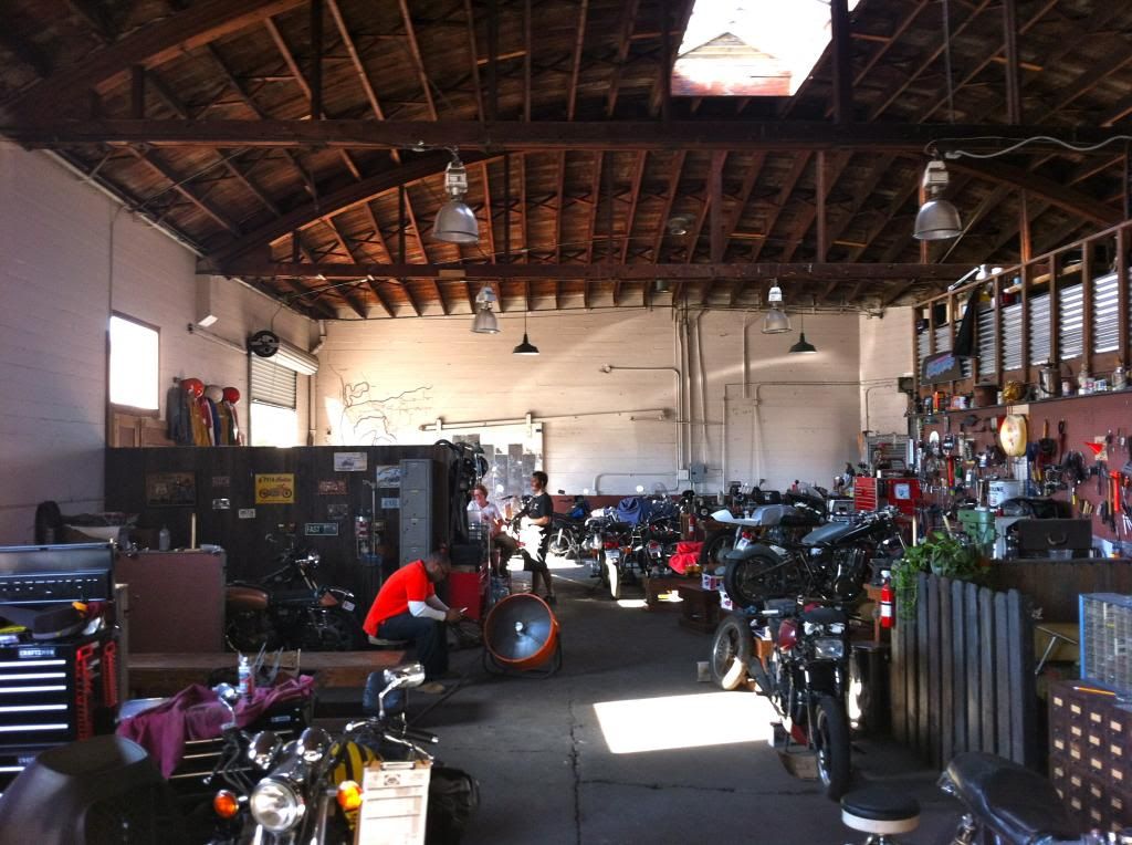

Cerberus Motorcycles in San Diego CA.

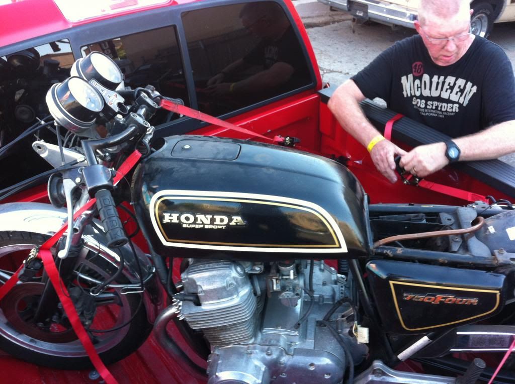

On the truck coming home
Home and ready to be changed for life.

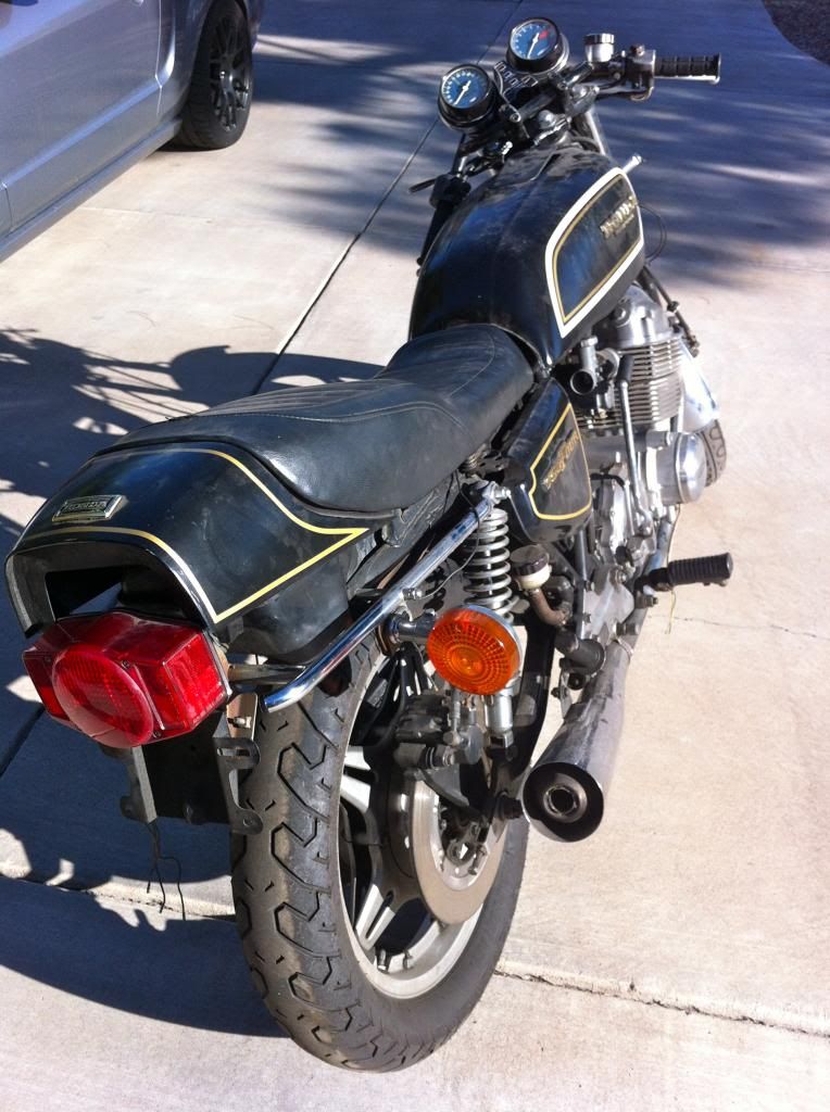

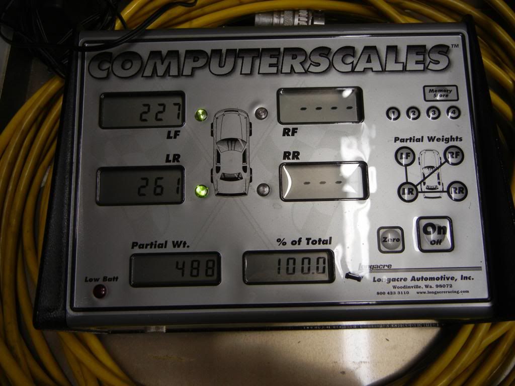

Scaling the bike.
She weighs in at 488 lbs

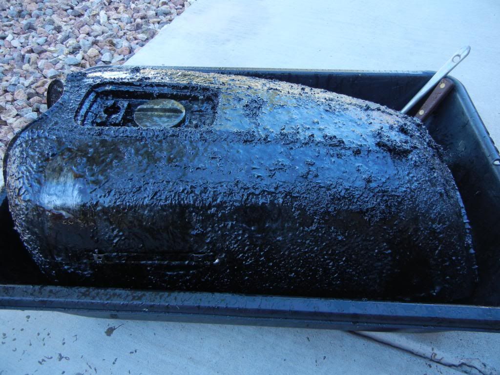

Stripping the tank with paint stripper.

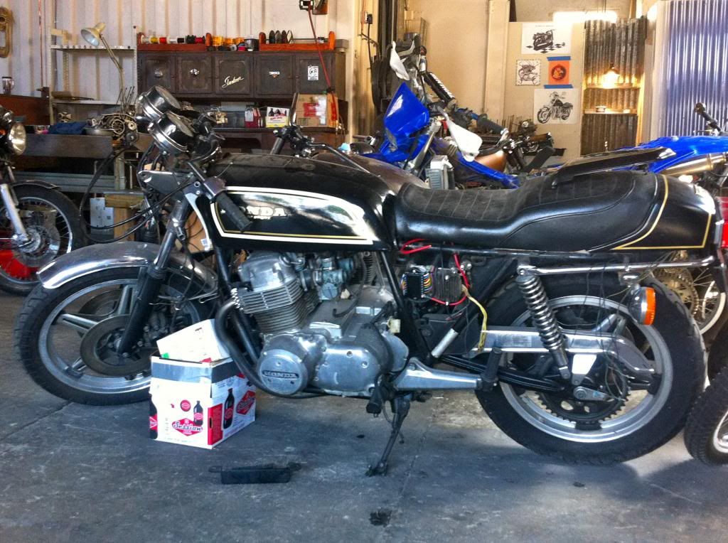

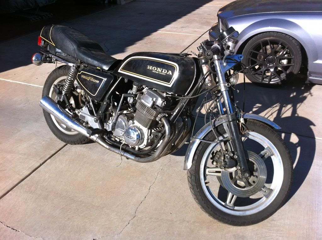

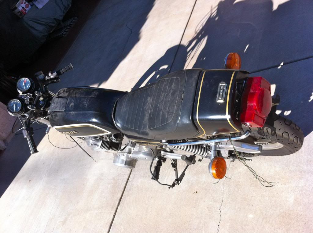

She needs some work

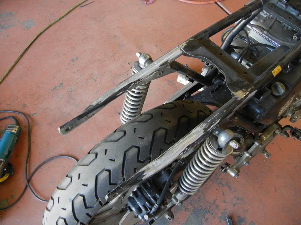

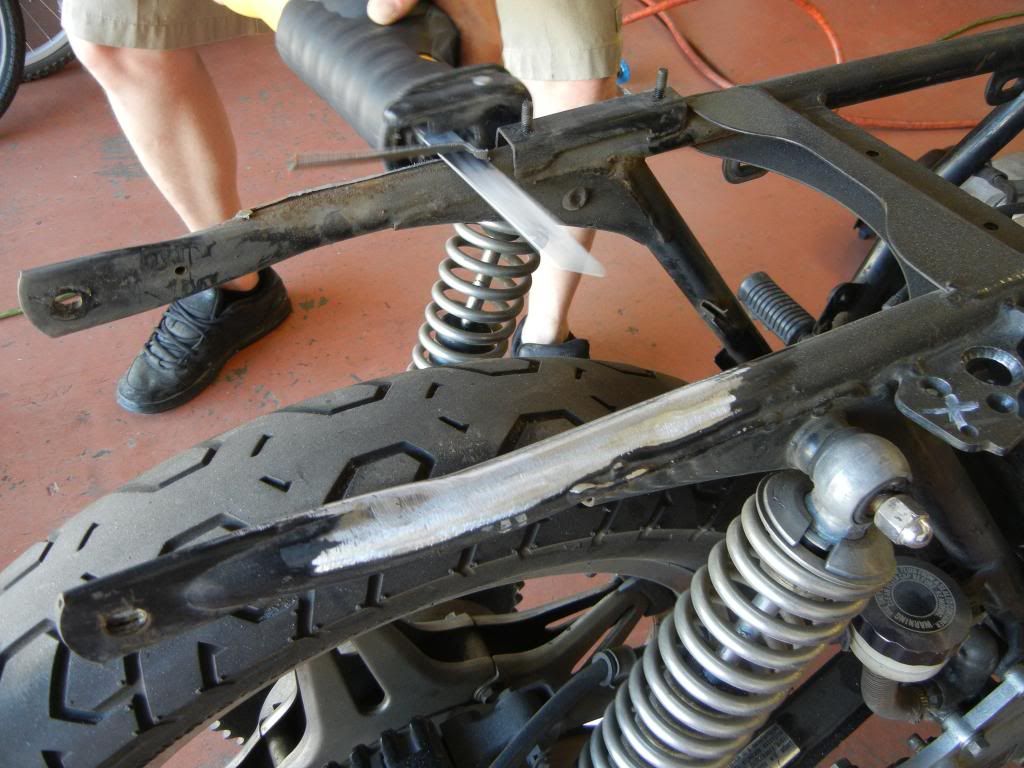

De-tabbing the frame for the new seat and tail
Clean frame

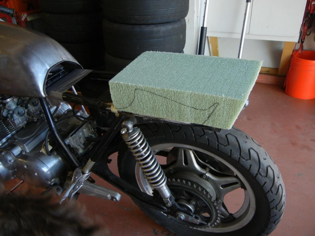

Arts and crafts time
Time to cut

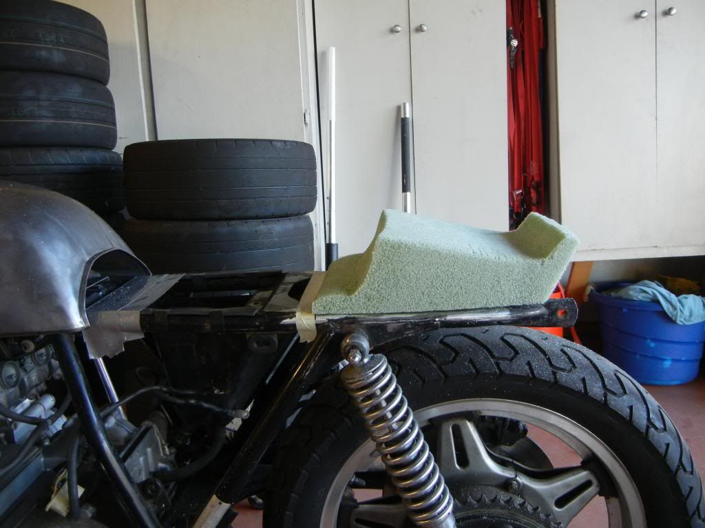

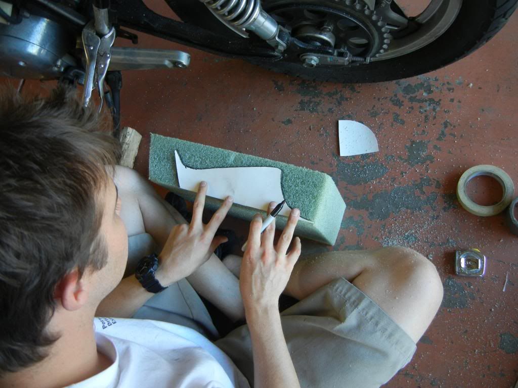

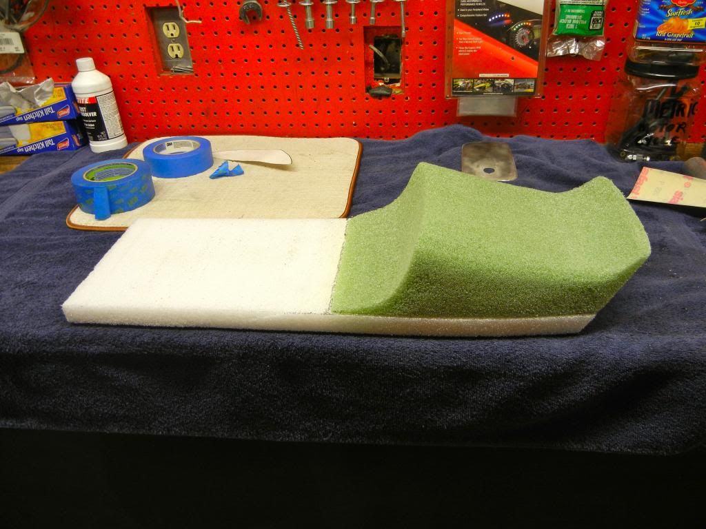

This is the start.  I need to fine tune the design.

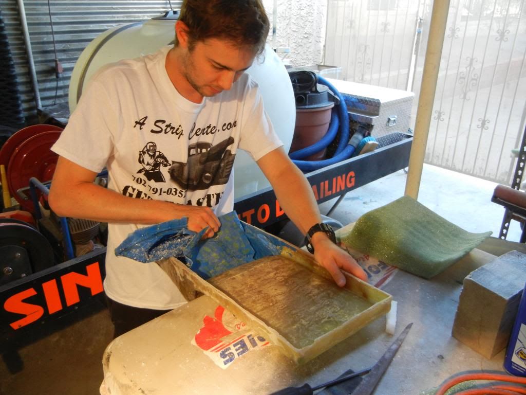

I designed my own tail out of foam. It resembles the Kawasaki tail with some flare.

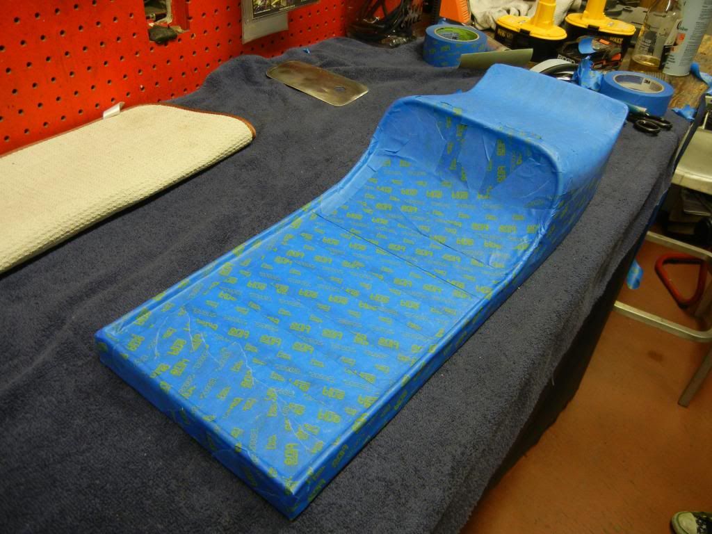

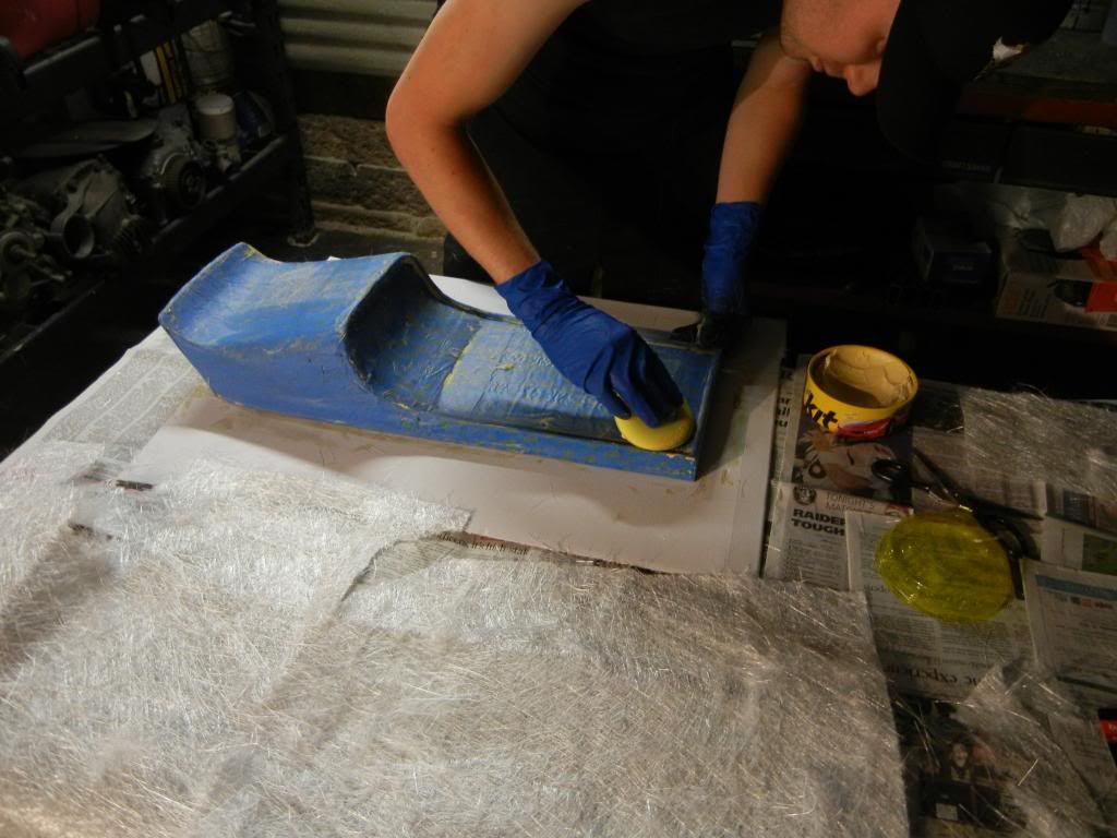

Taped and read to be waxed and fiberglassed. This took some time.
Prepping the tail with some cheap wax I found at the auto parts store.

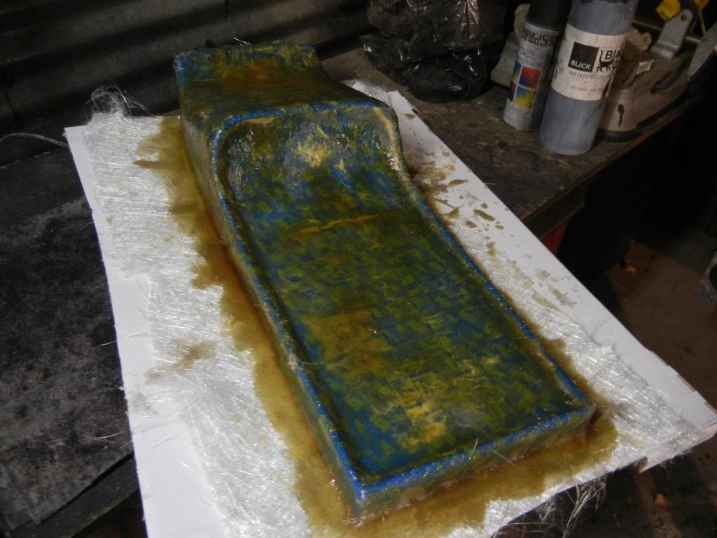

First layer of fiberglass.

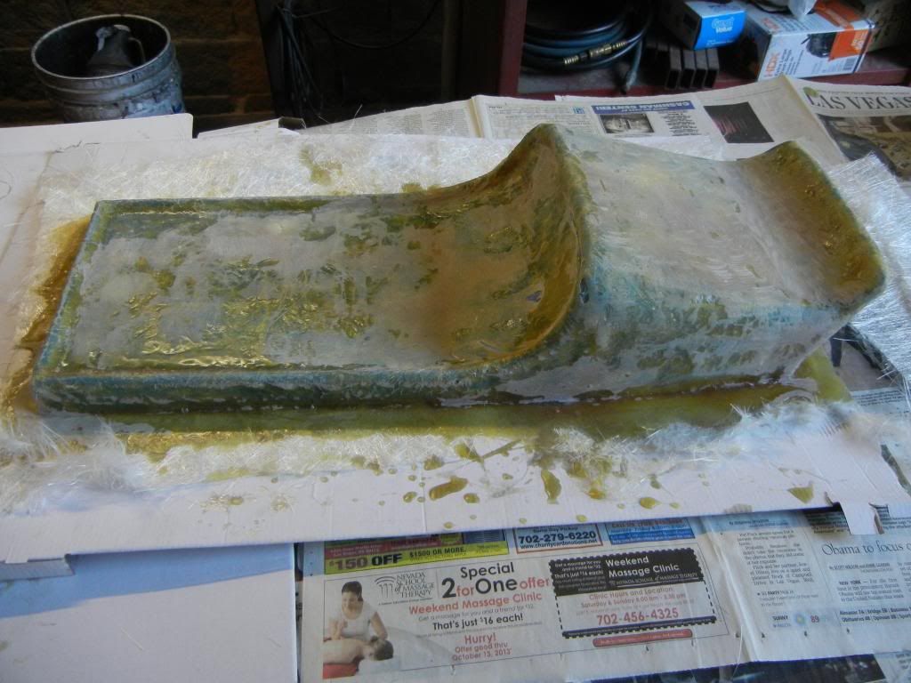

I sanded the first layer and added a second layer of fiberglass.  I have about 12 hour invested so far.
After 2 layer of fiberglass, I was able to pull the foam. It is very solid and ready to be sanded.
I spent about 4 more hours sanding. I then took the tail to my body shop guy to have him do the fine tuning and get it to primer.

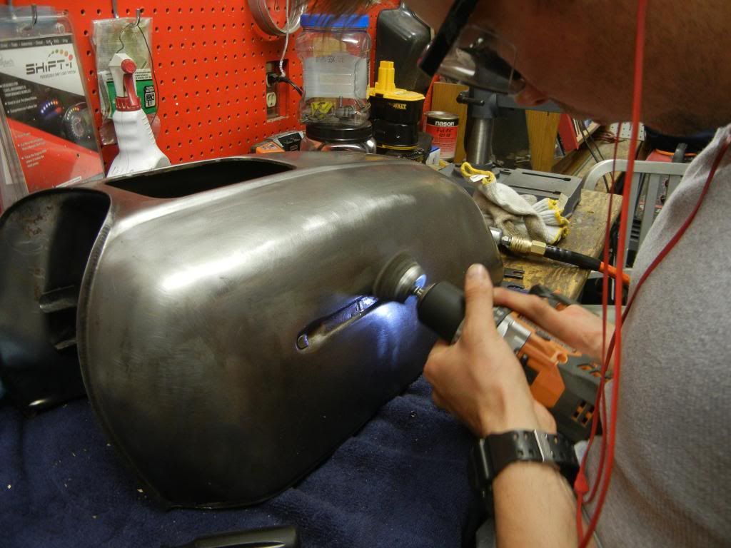

Wire wheeling the tank

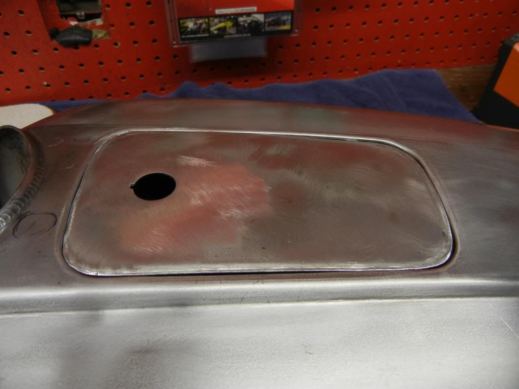

Filler panel for the tank.

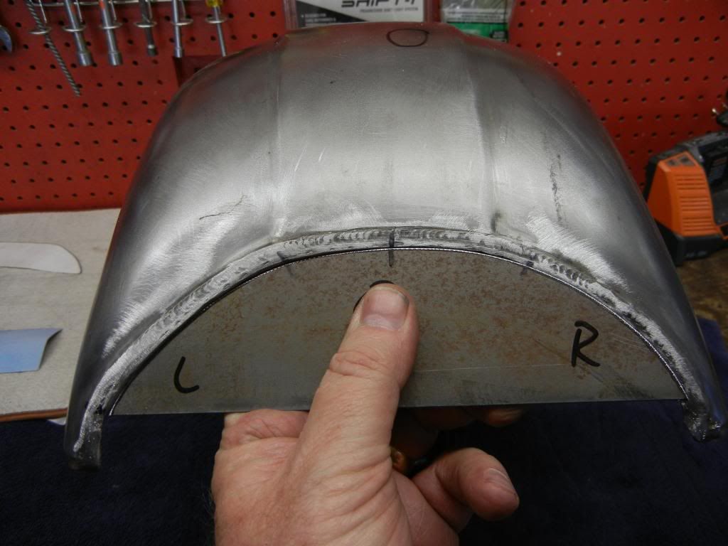

We are going to fab in a new brass fuel cap.

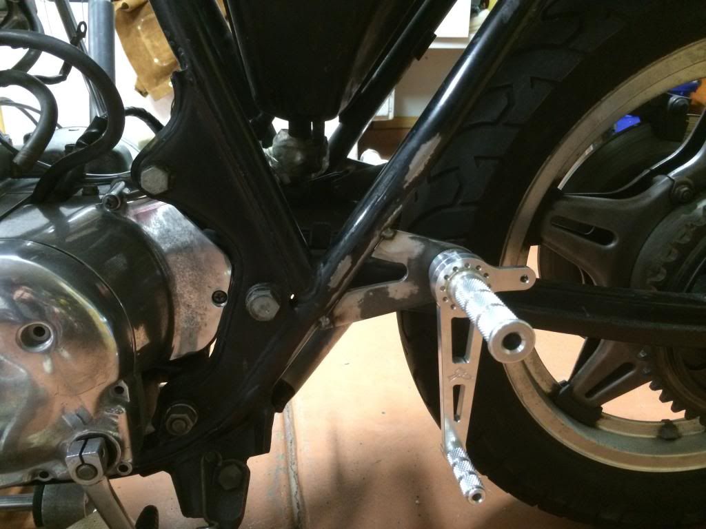

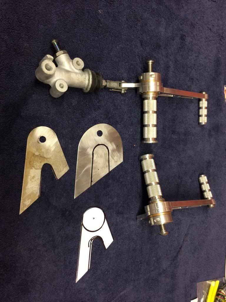

I was not able to find a rear set that fit the 78, So I made my own.  Dime City pegs, used the stock master with brackets that I made.

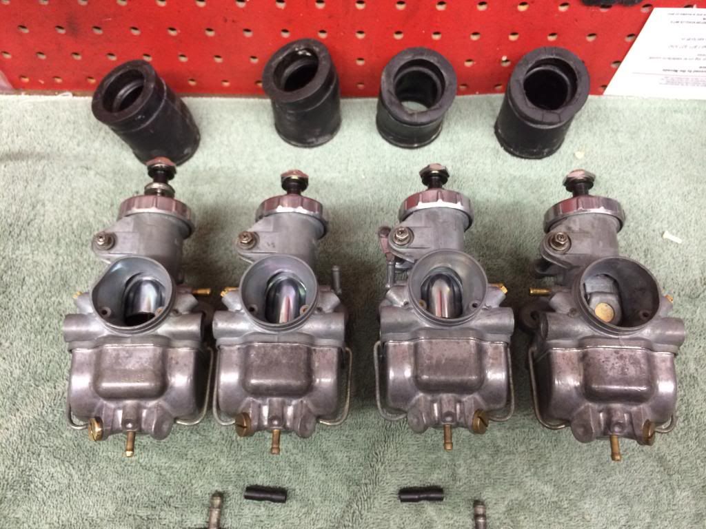

Did my own carb rebuilds.

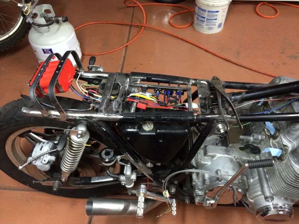

Wiring and switches

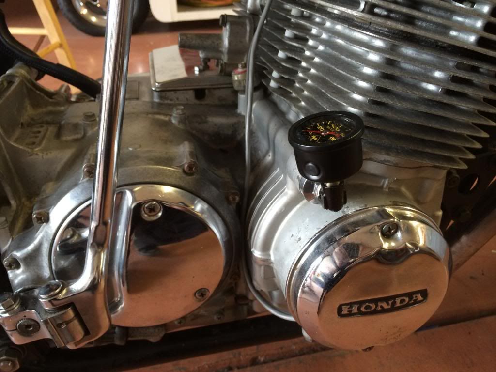

Oil PSI from Dime City

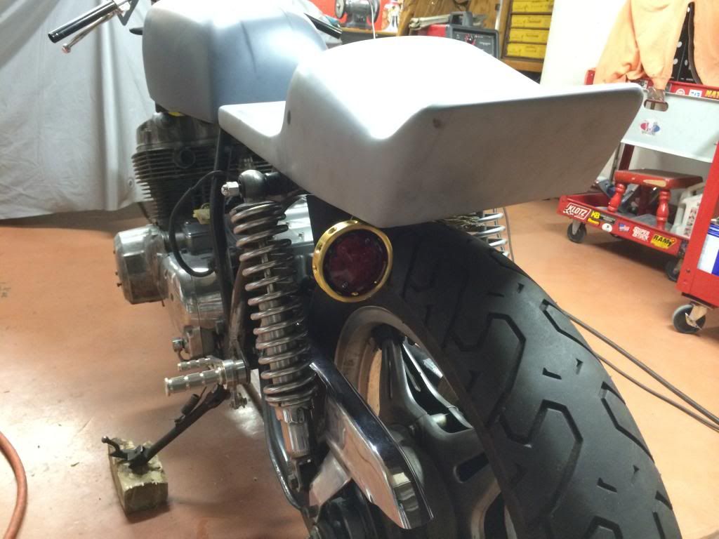

Tail light

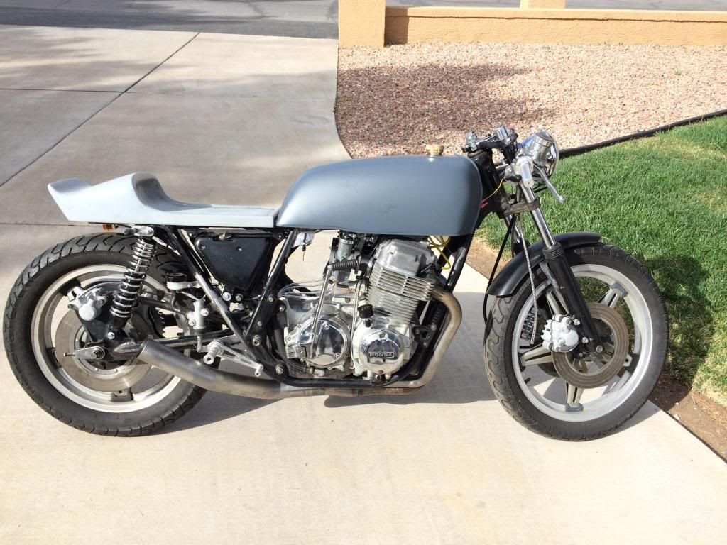

This is the bike as of 5/1/14

I've never used paint stripper myself.. does the old paint just wipe/scrape off easily?

mAd mOrdigan:  I thought so. But the tank had been repainted with some thick nasty paint.  I took a wire wheel to it and it balled up like gum.

We started on the tail today. It needs some fine tuning.  It will be awesome.  Im excited!
