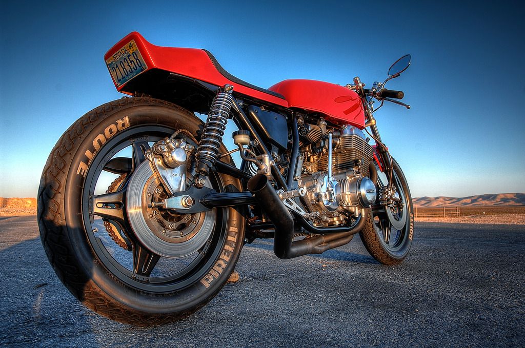

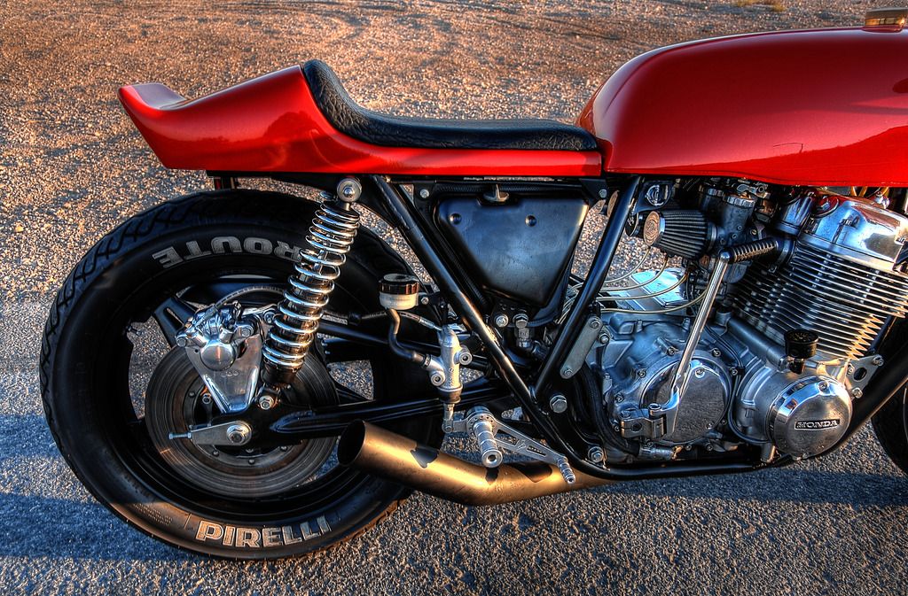

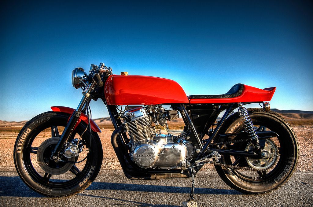

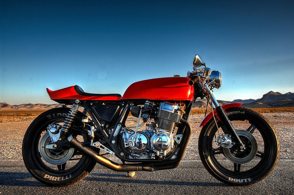

This is a update on the Cafe bike that I built.
Finished the Build in August of 2014.
It's first ride was in Sturgis, South Dakota for the 2014 rally. Sturgis is a life changing place everyone should go.
The bike has been a weekend riding bike. I recently had a child and it is time to sell the bike.  It will be going on the Mecum auction block June 3rd 2017 in Las Vegas, NV.
Cafe Racer built as a 70s period correct
A complete chassis up restoration, built only with parts and tools that were available in the 1970s
Original "F" chassis dual disk front and disk rear brakes
Custom original fuel tank with brass cap
Hand made custom fiberglass tail with hidden battery
Painted in a one-off red gold flake paint
Polished valve covers and side cases
Yoshimura 4 into 1 pipe
Electronic ignition
Electric start with hidden battery in the tail
K&N pod filters
Dyno tuned by Main Street Moto LV
530 chain conversion with 17-48 tooth sprocket set
Gusseted frame for handling
New Progressive 12 series shock and spring set
Hand made peg set with adjustable brake and shifter lever.
Complete Motorcycle frame and wheels are powder coated
All hardware is zinc plated
Patrick Vogel

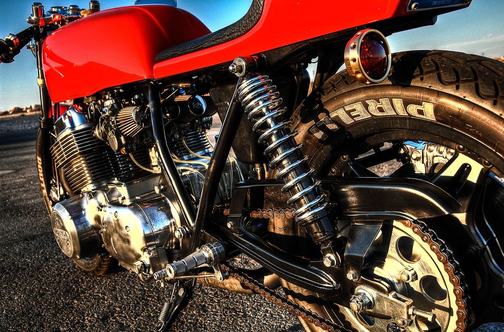

That came up really nice man, inspiring build.  Any clearance issues with the tail or battery?
Would lovvvvve to see a video running too, looks like it sounds mean
Half the fun's in the get there...
Offline PJs Garage
  • Posts: 20
Re: 78 CB750F Build
« Reply #19 on: May 20, 2017, 11:24:36 »
It's real close when you go over bumps.  I ended up trimming a small amount off to reduce the risk of contact of the tire.
