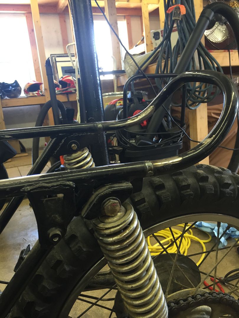

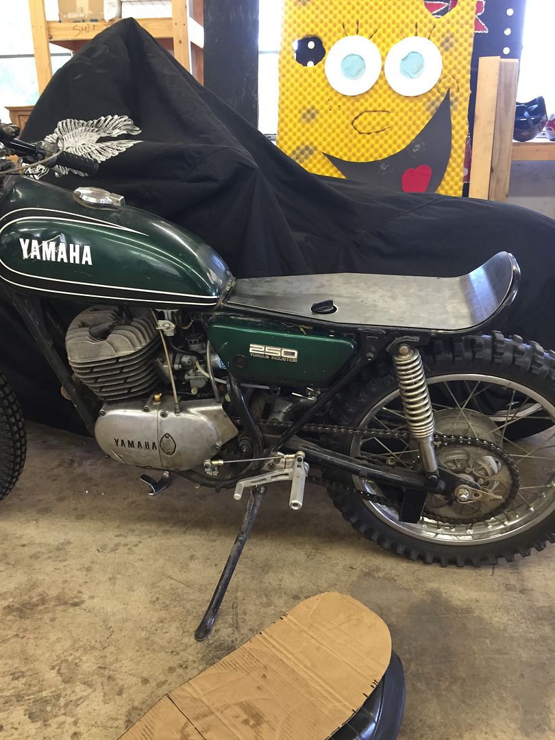

So pretty early on I shortened and detabbed the rear loop and bent up a seat pan for it(you will also see some crude rearset mounts but i ended up redoing those)

After that i put assembled some of the bike so i could do a little parts mockup and measure how much i needed to shorten the forks
After i shortened the forks

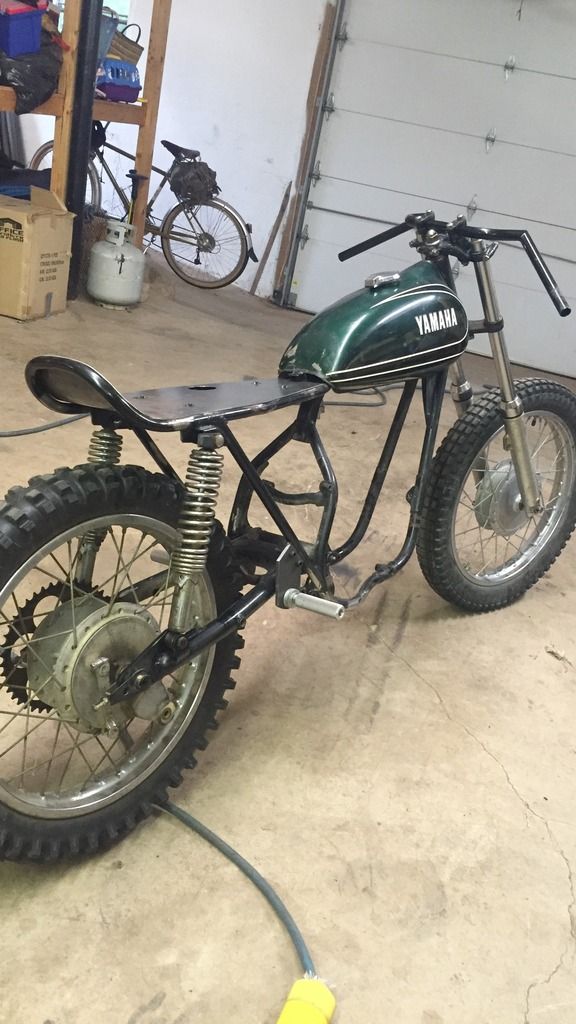

Fabbed up some headlight mounts and clip on handle bars

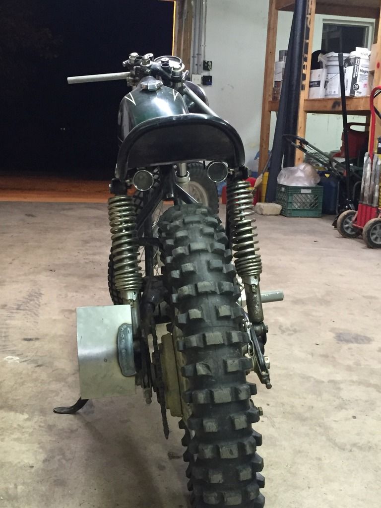

And mounted the turn signals and made up a license plate mount
