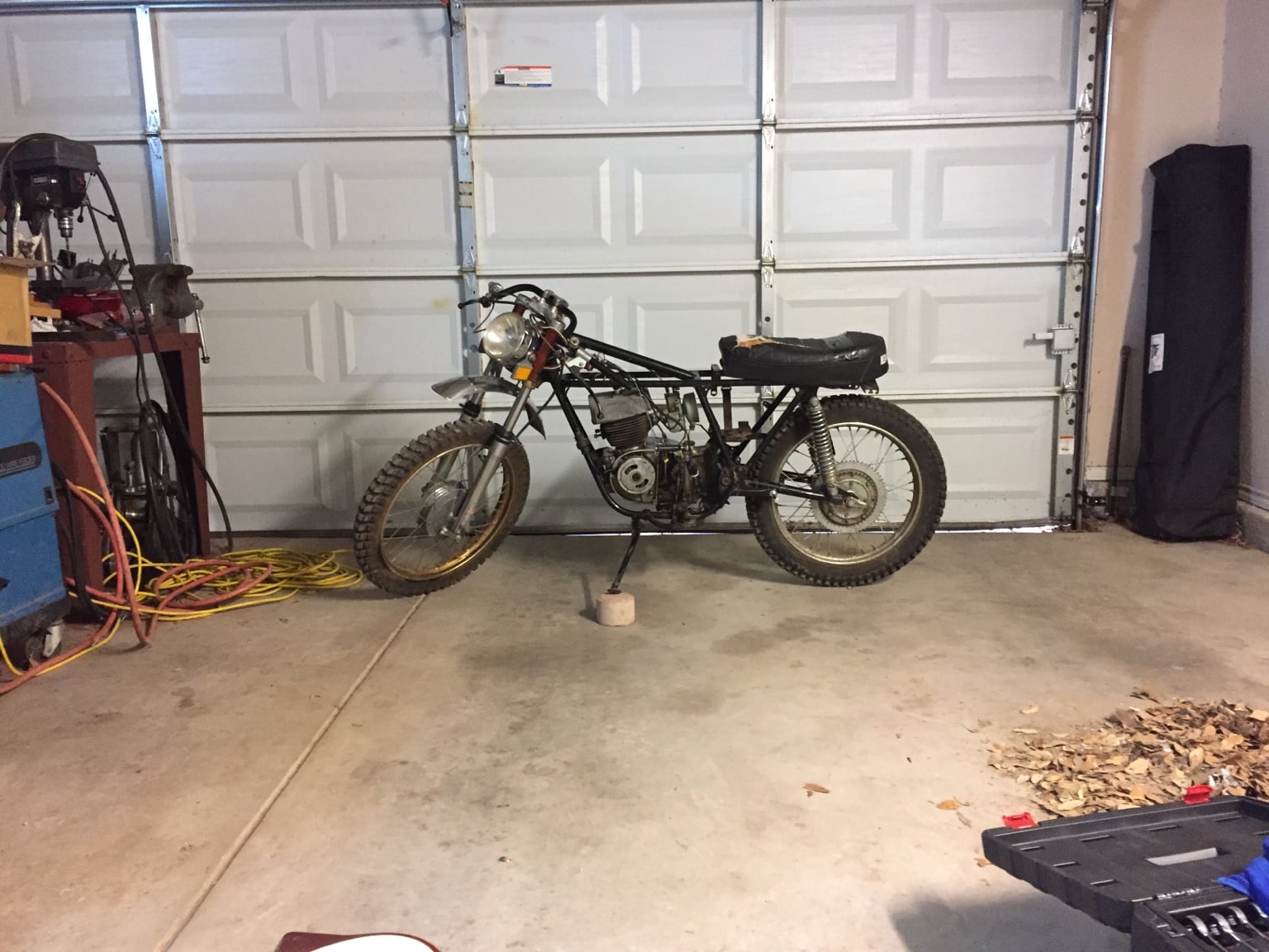

This is not only my first motorcycle build but also my first motorcycle. I've ridden others in the past on dirt and street but only short jaunts and trails.  For the last few years I've been interested in the cafe style bikes and various other styles that are related but only in looking at pictures drooling over others builds thinking,"eh I could never build one that cool, I'm a jeep guy."
A peculiar series of events lead me to owning this little beauty.  For the first time I could see past what a bike is to what it could be and decided to change from restoration to custom build.
Specs:
1972 Benelli 175 Enduro
167.5 CC 2 stroke single cylinder
4 speed trans
50" WB
32" seat height
The original tank is gone, as well as some other pieces. I've had no luck finding some of the parts that are missing and that's part of why restoration went out the window.
Plans: Benelli mojave style tank, dual sport tires(it is technically a dirt bike after all), clubman bars, rearsets of some sort, build a seat, remove a lot of the stuff out back like the cargo rack.  I might add a small 30 cal ammo can back as a single side saddle bag for oil and tools, it is a 2 stroke after all so I have to be able to keep at least some oil with me.
On to the pictures from acquisition to current. Don't mind the yellow tank.  It's some crap on there just have a something to hold fuel to get it running right.

its a cute little dirtbike would fun as a barrel of monkies except for what you are planning to do will make it less agile, extremely uncomfortable and very dangerous for a rider with little experience to ride competiting with traffic
you are putting style way ahead of function and being  a beginner you probobly have no idea that it is a huge but sadly common fail .that can kill you
have you had a riders safety training course with the local group ? do it and play to the bikes strengths agility
its not even a full size motorcycle its a very small bike and you need the bars high like stock ones so you can ride upright and be abke to see over around and thru traffic so you can be situationally aware of whats going on in that traffic
with the clubmans you cannot sit up to see at a safe eye level in traffic without locking out your arms or having them straight you cannot safely control any motorcyle with straight arms,and tilting back you head and that hurts after a short time besides limiting severly your ability to for instance checking  the blindspots when manuevering thru cages and it  is the best possible way to loose crucial control command of the motorcycle's manueverability,thats all
clubmans/clip-ons and rearsets are for the racetrack or very experienced riders,country/mountain rods with little traffic
your fist motorcycle  if suitable as this one may be if you are 150lbs or less should be ridden and enjoyed and used to learn tuning/maintanance  garner traffic skills in low speed city traffic you wont be taking it on any roads with above 45 speed limit anyway unless there are no cars cause they will just mow you down
the little trailbike cannot keep up with the cars of today
