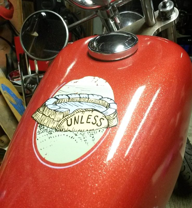

Well I scored a few things at a local Swap Meet @ Jay Roche's New Tradition Co. For this bike a complete 18" Borrani rear wheel and older Metzler tire, a bitchin Santee vertical hex oil tank ( that may be too tall) and a bitchin Sparkle tank with a hand painted Lorax dr suess theme. Also got a ton of factory take off parts for the Maroon bike I'm working on and another 77 XLH we got since getting the other too.

The tank had these stripes and fading repop amf sticker so that got the Easy Off treatment and looks fresh
Pretty ironic I guess to have this tank end up on this bike. The image is from the Lorax, the quote is 'Unless someone like you cares a whole awful lot,Nothing is going to get better. It's not.' which is sort've the whole concept of this build. If I didn't care about fixing the bike, it would still be in the mud on a broken HF bike jack with a fucking doorbell start button, next to a double wide in New Hampshire.
