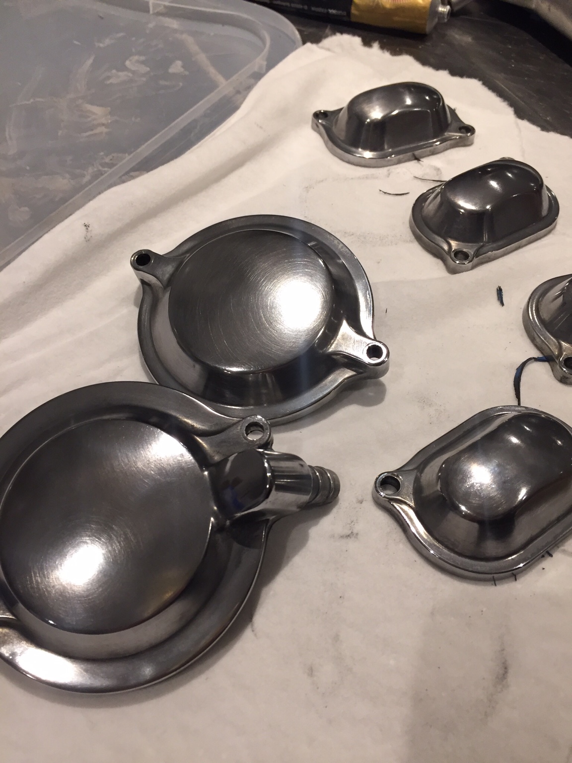

Some polishing and soda blasting
This is what the engine looked like before soda blasting
Blasting time
Result after blasting and polishing
Pretty happy with the result, im goilng to dremel the shit out of the engine to get it flawless, but im going to wait untill the rest of the bike go to the paintshop.

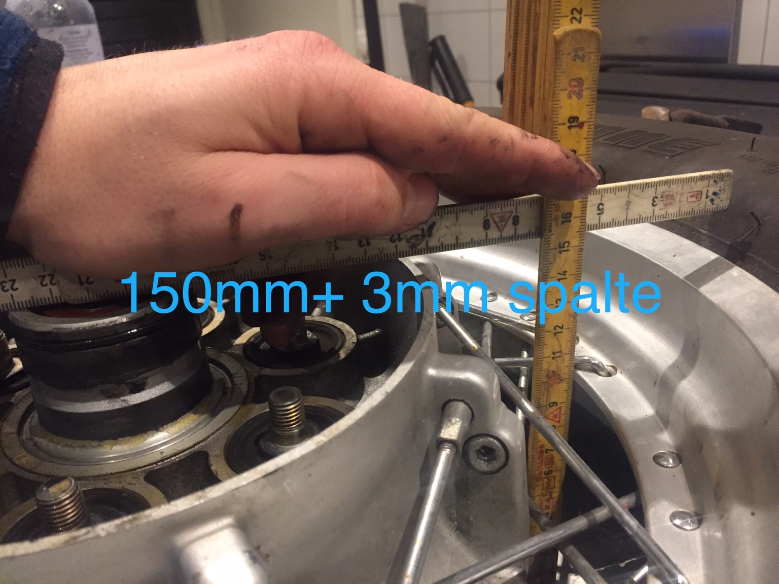

I have been collecting parts for a time now, And I was so keen on having spoked rims on my bike, so I managed to get a hold of some pretty neat rims from a 96 virago750. The only problem is that the rear wheel is shaft driven. And the xv 1000 tr1 has chain drive.
To the drawing board!
I messured the old rear wheel to find the correct possition of the sprocket, and started drawing a sprocket adaptor for the 96 virago rear tire
Here you see the idea
And here is it finished
It fitted perfectly into the wheelhub, could not be anymore happy

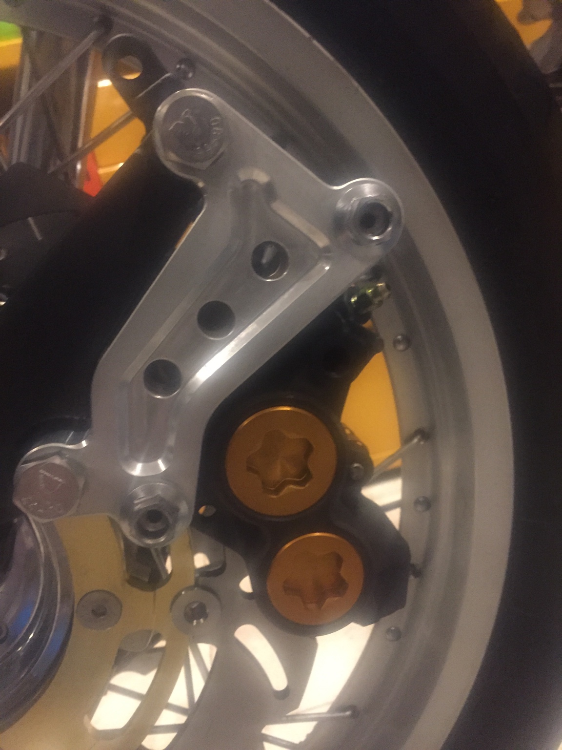

The front end is installed. And a new problem came up.
The calipers are hitting the spokes on the front wheel
Back to the drawing board again!
I found a sulotion that might work. The original virago brake disc has a Ø of 282mm and a 6 bolt pattern, i needed to fint a the largest possible disc and relocate the calipers nearer the rim. Where the spokes are more narrow.
After alot of research i fount out the 06 yamaha MT-1 had matching bolt circle and inside hole, and best of all the size is 320mm
Here is what i need to do:
Shim each disc 10mm out. I have now 2,5mm clearing from the disc to the fork foot on each side. (Is that stupidly small space?)
Also i need to make a custom bracket to i can relocate the caliper.

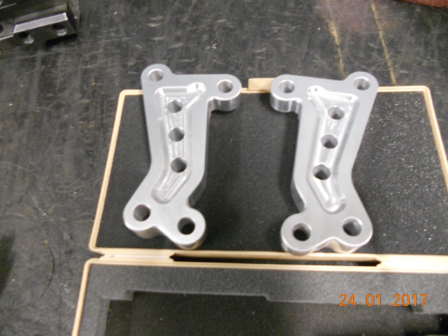

Making custom caliper adapter bracket
Here is the finished machined parts ready
Assembly time
It fitted perfect and i can now spin the wheel without the caliper is hitting the spokes. I have around 4mm distance on each side from the caliper body to nearest spoke,
its very satisfying to draw something, make it, mount it and solve a problem, thar cant be fixed with any thing else

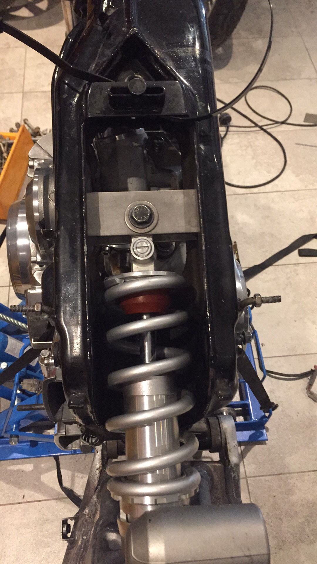

Fitting a R1 rear shock to the frame
Stock distance frame-swingarm
Made a simple mount for the rear shock

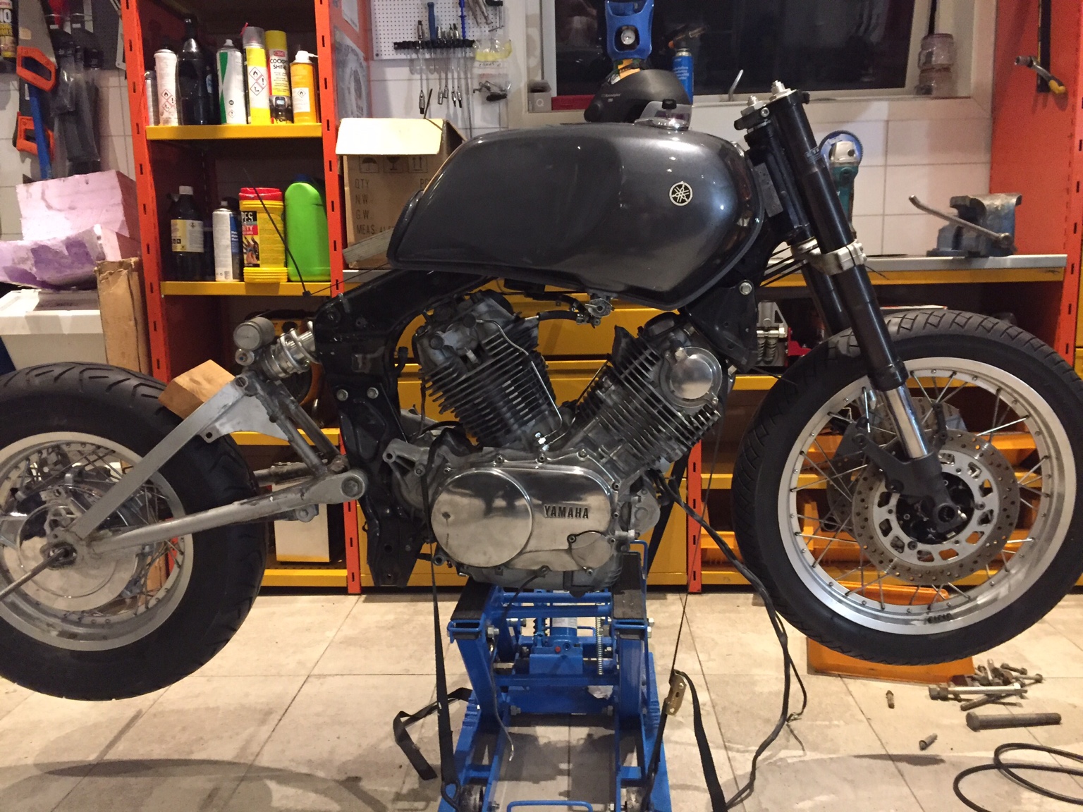

Im now experimenting with seat placement on the bike,
I also was considering using a protaper handle bar i had laying around
But i concluded to use clipons

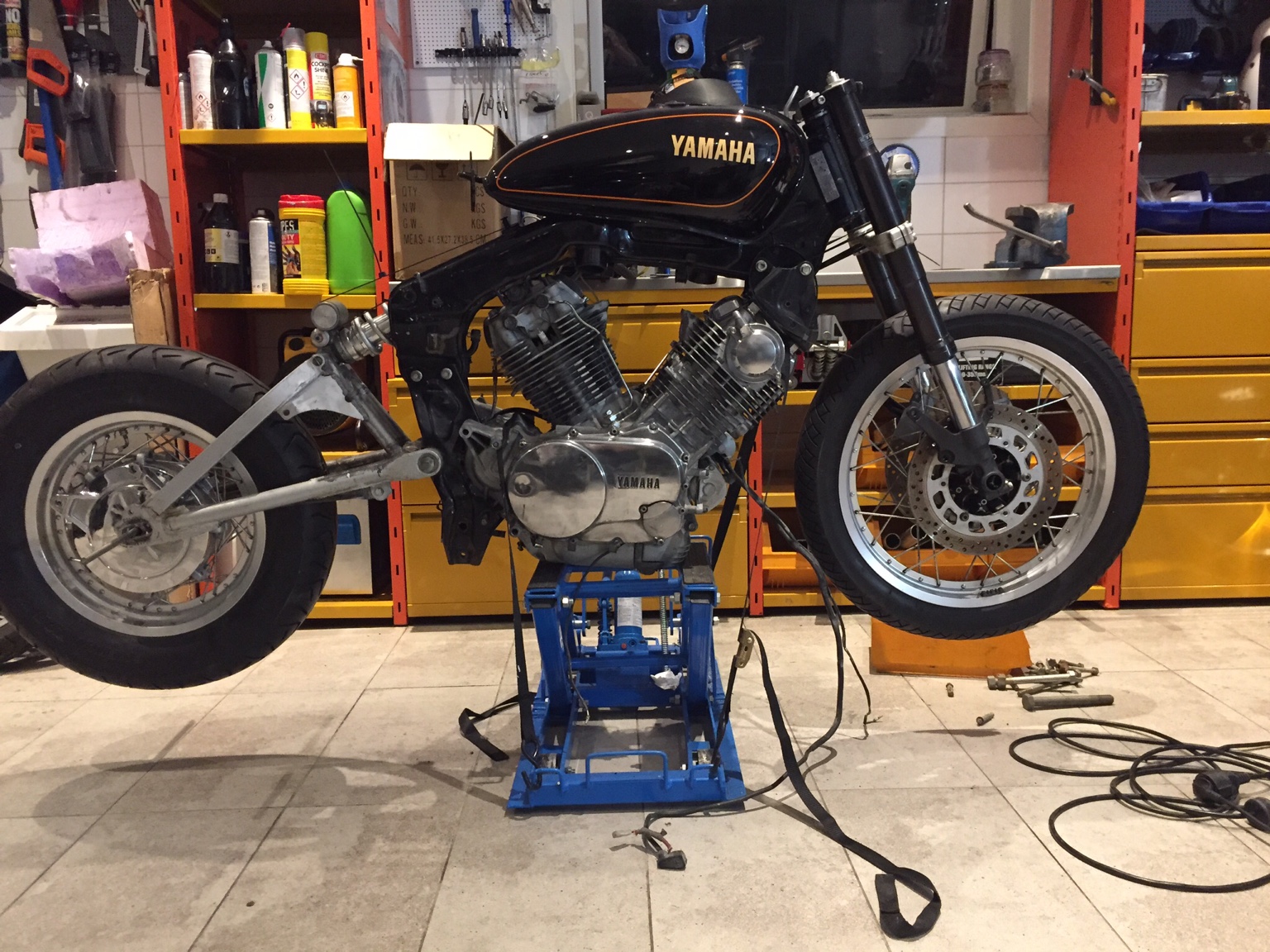

Tank testing again, soon i have to weld the rear shock mount, do decide the stance of the bike, and i want to have the right lines. Therefore i use alot of time and pictures to see what possibilities i have
Xjr tank
SR tank
Orginal TR1 tank (liftet 2cm on front 3,5cm near saddle
Stock placement
