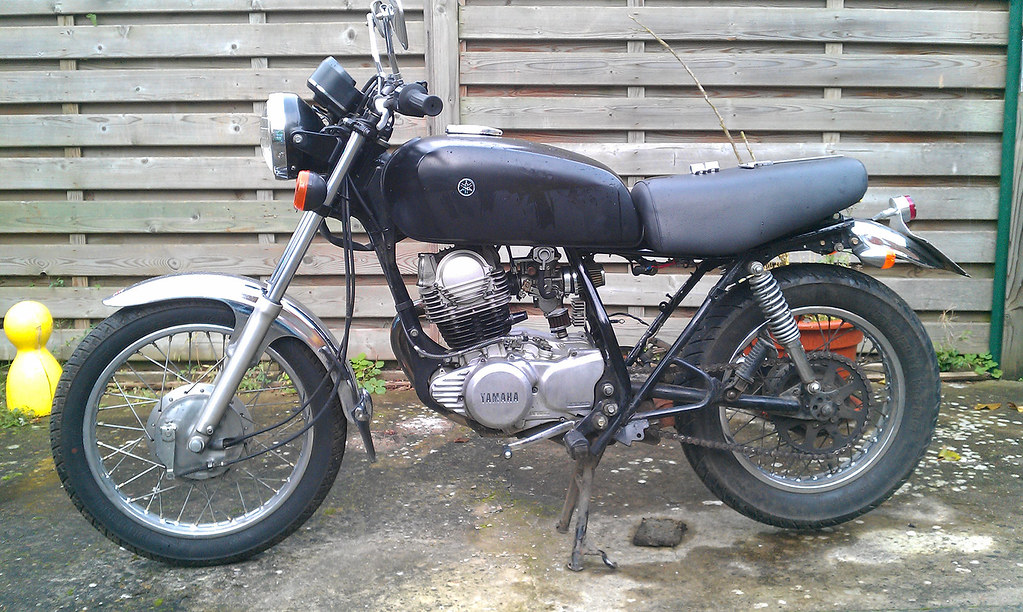

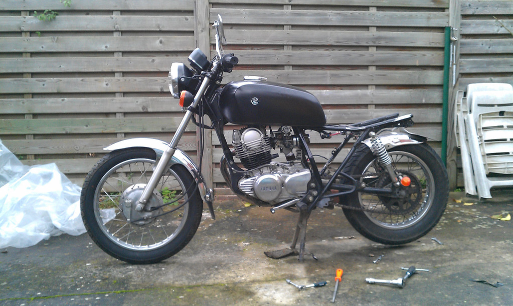

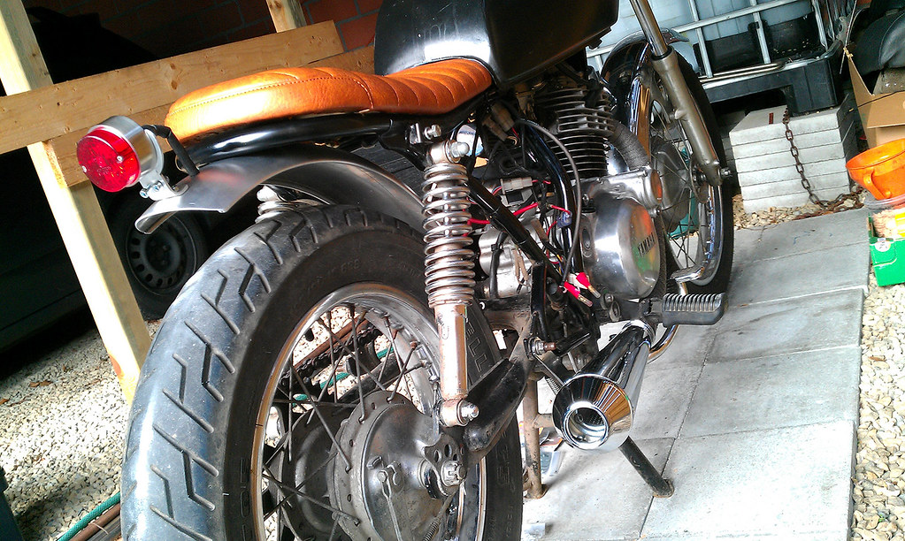

And this is where she sits currently:
Managed to fix (and break) a lot of things, and snapped a lot of pics in the process, so i figured it was time to give her her own build thread and get some creative feedback from you guys. Say, share, upload whatever you like in this thread. It can only benefit from it.

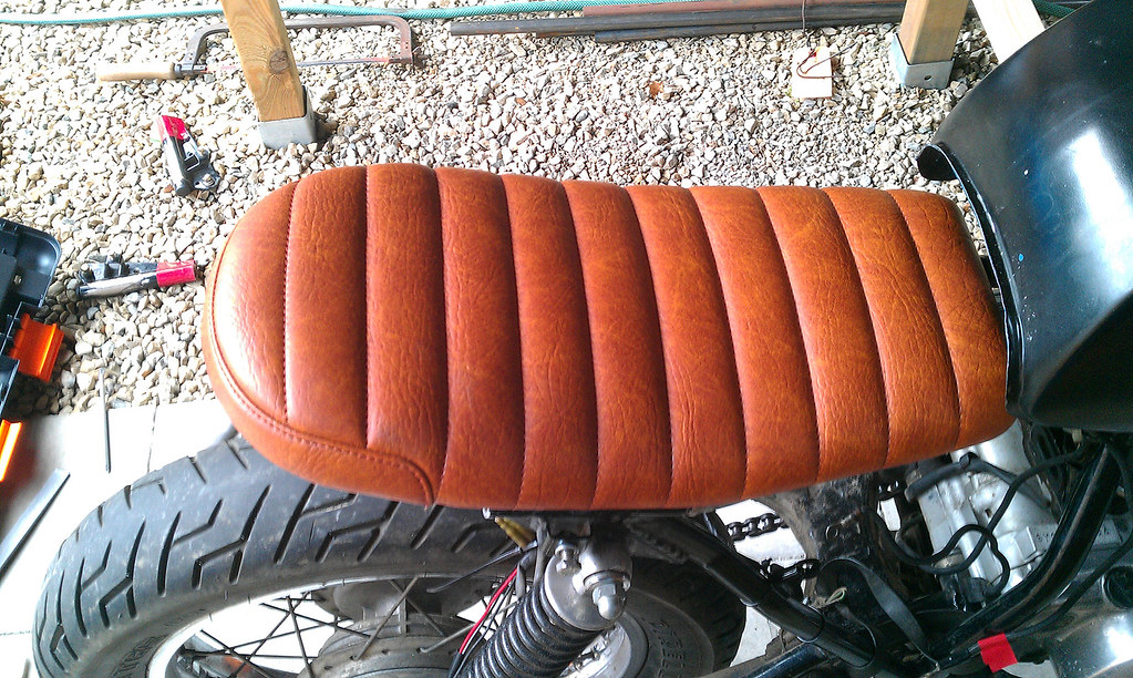

So, first thing i had to fix when i got the bike was the subframe. The previous owner removed the brace under the seat with a hacksaw and didn't even took the time to clean it up. Besides the reduced stability it also started to rust. Since i had to fix the rear end, i decided to do it proper and make a rear hoop. With the seat brace out of the frame, the rear would also be able to fit a flat seat instead of the cut up enduro seat the p.o. installed.
i read some blogposts and decided to build the seatpan out of multiplex, since i didn't have the tools to fabricate something else and i figured it would be easier to attach the foam and upholstery. The SR frames have a slight bend upwards, so the multiplex had to be steamed and bent. Didn't have a steambox or anything, so used a pot of boiling water to cook it…
…and bent it using the frame…
…then attached some foam i got from a camping mat…
…and brought it to a local upholstery shop. The owner had a look at it and basically told me he didn't want to upholster it 'cause the foam wouldn't hold it for a month, it would be too soft and rip too easily, so the leather would look like crap. The only way he would work on it was if i remade the seatpan out of metal (the multiplex wouldn't hold the curve of the frame) and let him shape the foam (and use a correct type of foam) and upholster it. He basically brought me down to earth and made me realize that taking a shortcut and having to do it all over again is worse than doing it right the first time.

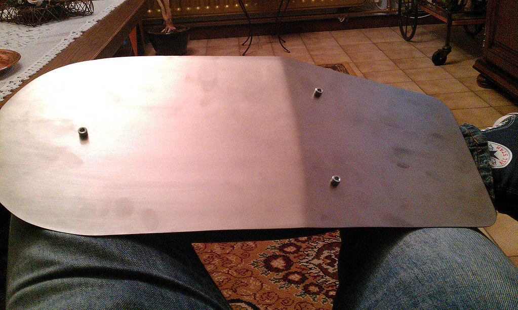

The new seat pan. Cut, bent, sanded and ready to weld some threads on:
Weatherproofing it with some satin black:
Semi-finished product:
Ready for upholstering:
Only thing left to do now was deciding on the saddle height, choosing the leather and searching for some pictures the upholsterer could use to build me the right seat. From the beginning i was inspired by Clutch Customs BMW R75/7, and wanted a similar style for the saddle:
(images from thebikeshed and clutch customs)

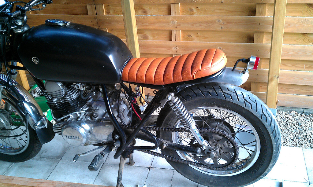

Had to wait quite a long time, but the end result was worth it imho. Again, it's not that orange…
(Still have to make decent pics though)

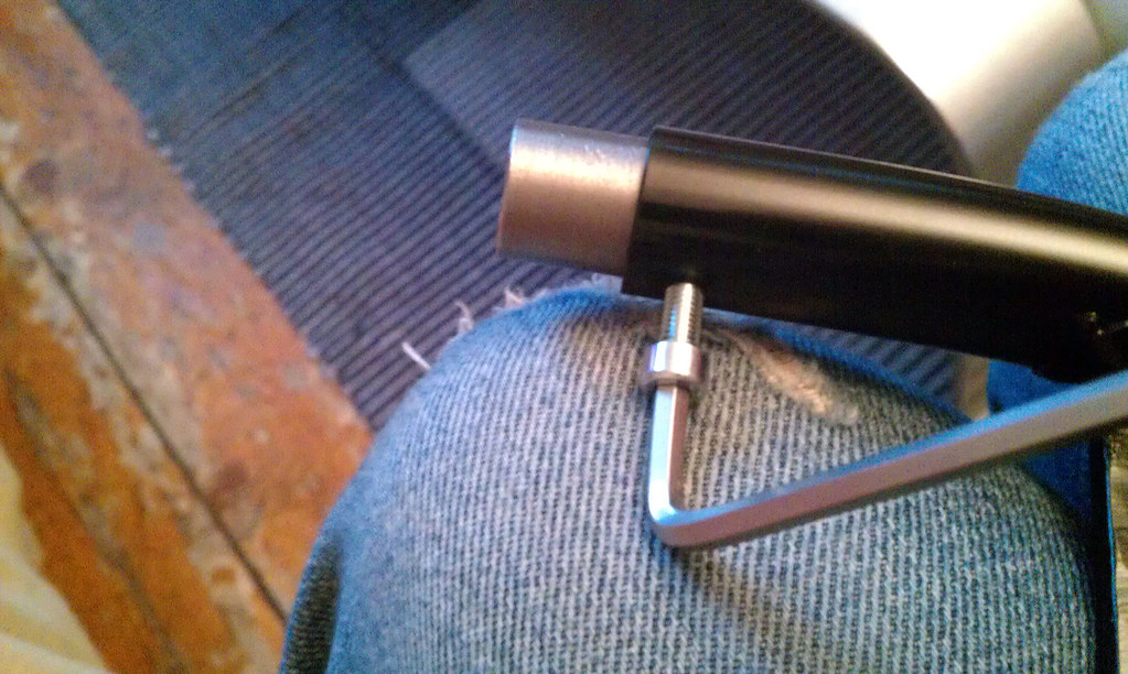

Also had to fabricate some hollow bolts for the new Daytona turn signals that arrived in the mail. The hollow bolts weren't provided, and ordering would take at least 6 weeks since they had to come from Japan. So i searched for some similar ultra fine threaded M10 bolts (P1.25) and decided to have fun with my drill press:
(Original on the left, drilled and sanded on the right) They fit perfectly.

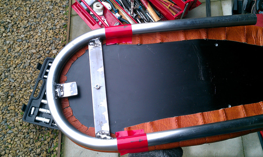

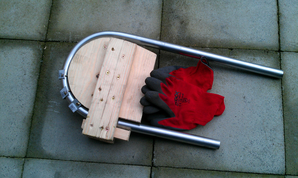

The upholsterer finished the saddle, but i still had to fabricate a rear hoop. Didn't know anyone with the correct size dies, and it would cost a couple of hundred euros to have one made, so i researched some other ways to bend tubing and stubled upon the oldschool ways: Filling the tube with sand and bending around a wooden die. I actually filled mine with salt, which was easier to come by.
Got to work on cutting and fabricating the wooden die. It had to be as smooth and curved as possible, sturdy and besides the perfect fit have a bit of extra bending room to compensate for the tubing springing back:
After about 1,5 hours of bending (didn't have anything to fixate the die):
To my own surprise it worked out pretty good.

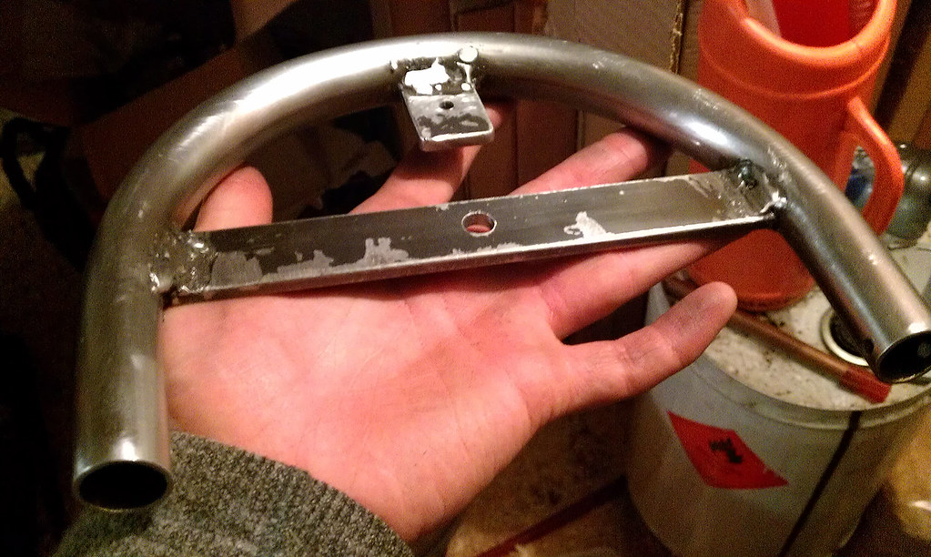

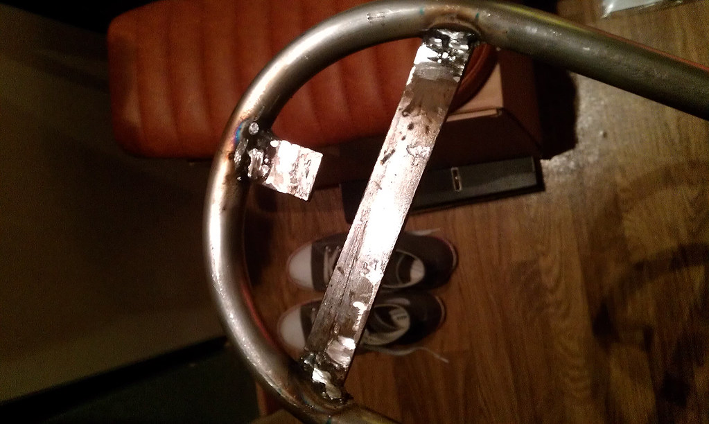

Got my grandfather to help with fabricating and welding brackets for the hoop:
These aren't the cleanest of welds, but i don't think they are ever coming off.

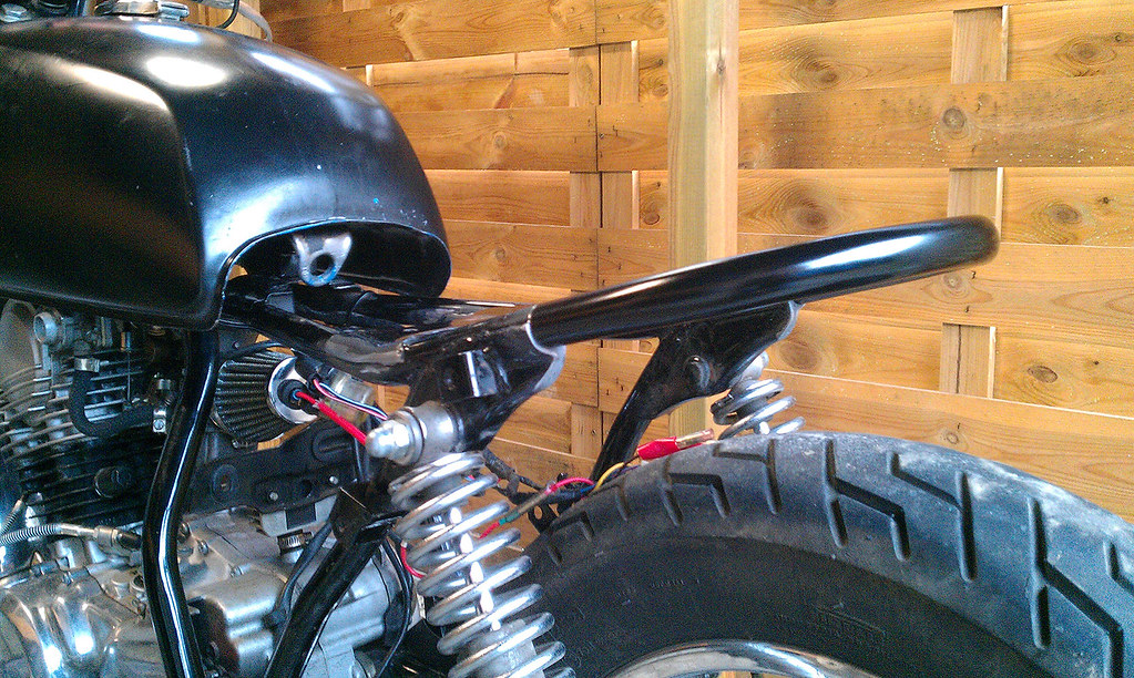

The small tab will hold the rear fender, the large bar will support the seat and add additional stability to the rear end:

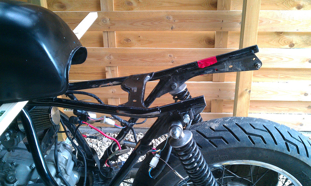

Had to shorten the subframe to make the rear hoop fit with the curve of the saddle:
Measure, measure, measure, …
It fits!
The empty spaces in the cut up subframe would be filled with some metal-paste, sanded and painted.

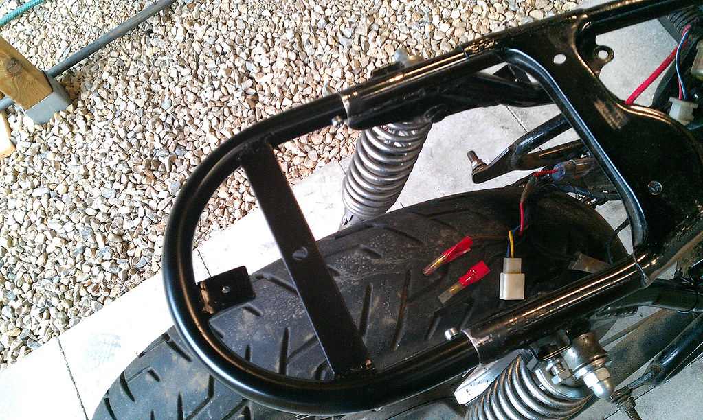

The rear hoop had to be welded on, but since the bike wasn't moving, and i didn't know anyone who could weld it on, i decided to bolt in some metal plugs that could be left in when i would let someone weld it in the summer.
Pre-drilled and threaded:
Painted and ready to bolt through:
Plug and play:

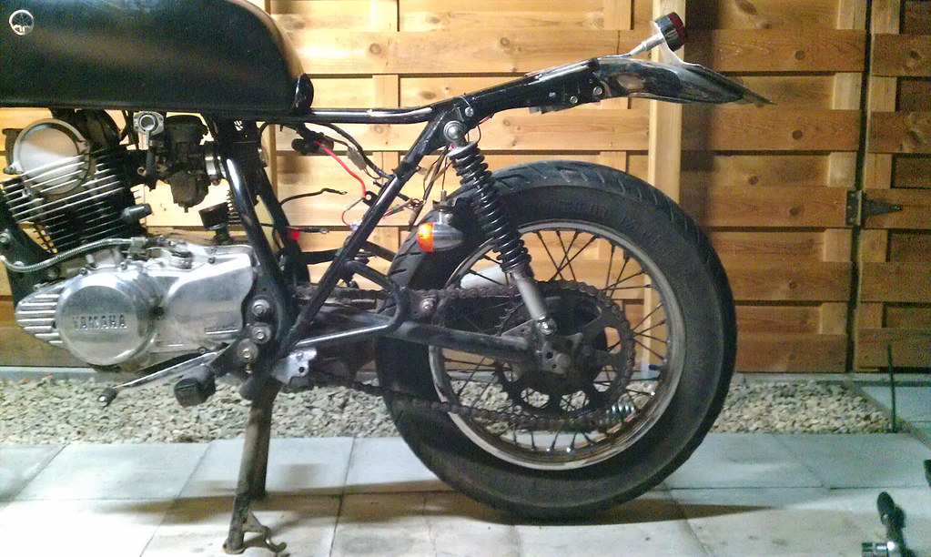

Sanded and taped the rear end:
Drilled and cut the rear fender, soldered the rear light, fabricated a brakelight and license plate holder, and bolted everything together.
Ready for the first test-ride:
Wrapped exhaust and new muffler:
Battery box in place:
Unfortunately, after 15min into my first ride i pulled over and saw the carb overflowing through the pod filter into the crankcase. I suspect the float was stuck and couldn't get it loose. On top of that, the vacuum operated petcock wouldn't shut off, so had to drain the full tank into a bucket. Next job would be cleaning the carbs, and revising the vacuum operated petcock…
She's starting to deserve her name.

Had to order the tubing from a metal-working factory because i wanted the same dimensions for the tubing as the factory frame used but couldn't find it anywhere else. If i remember correctly i had to order 6 meters (factory minimum) of DOM 22x2mm steel tubing (diameter x wall thickness). I guess it equates to DOM 7/8"x.079". Also had to buy 6 meters of round bar (20mm dia.) to fabricate the lugs used to fix it to the frame. Since i didn't have a turning lathe i used a drill press and two hand files to get a couple of millimeters off.

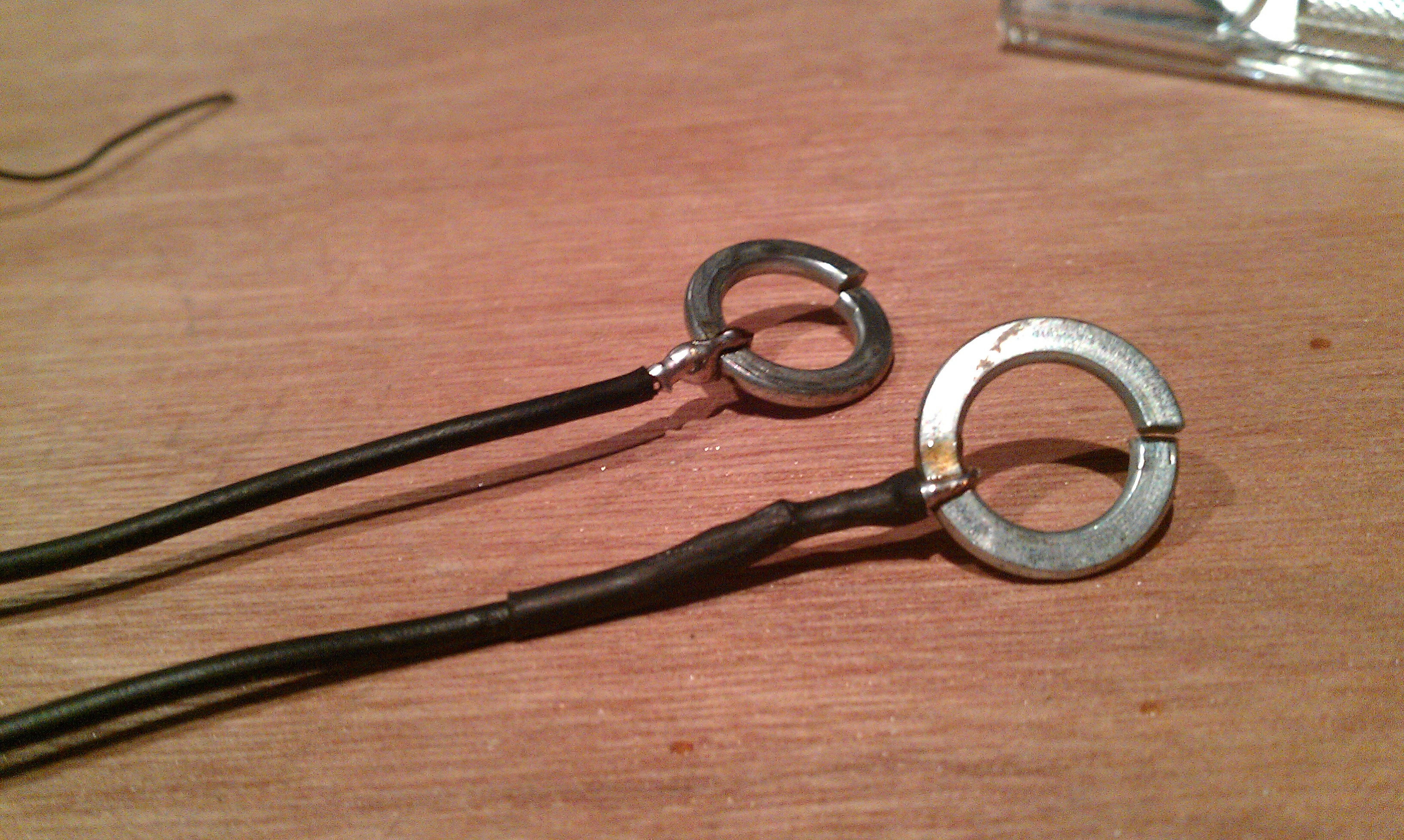

Soldered ground connectors:

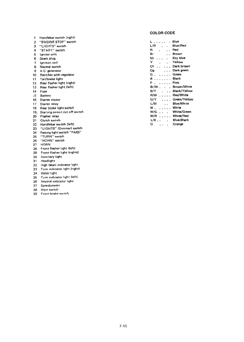

When i look at the schematic, i can see they share some of the same parts from the wiring harness, so i can understand this problem is related with some of these parts, but i can't see any solution. I double checked the wiring inside the head light. The turn signals are hooked up correctly, according to the schematic, and i can't find any loose or false-grounding wires, as far as i checked…

Some schematics for my bike: (first one uses the same wiring for the front signals, auxiliary light and dash lights)
