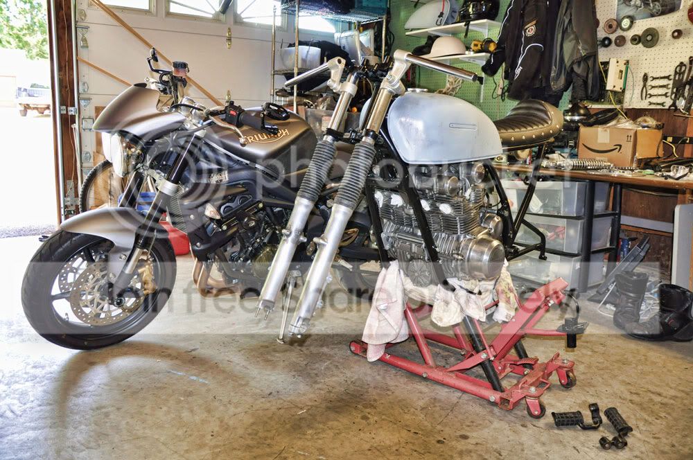

This is my Winter, Spring, Summer, Fall, Winter, whenever I get time, etc. project. So far...
Started out as a Suzuki 1977 GS550 in pretty good shape:
The tear-down starts:
Making aluminum bits shiny:

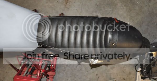

Give me your thoughts on this West Eagle seat:
Will likely fill the area under the seat with a cateye taillight.
How we mounted the seat:

checking out headlight bucket from KZ440:
View from behind:
I'll be installing swingarm this weekend and get the back wheel on if chainring shows via UPS.
Nice seat! I have been loving the same style on Doc Chops Virago, and finally realized who is selling them. Unfortunately it seems like they need an American distibutor. I have a friend with warehouse space and would love to get 100 of them over here!

....and we have a roller. Won't stop or run, but we have a roller! Needs chain, battery, lights, tank painted, clubman bars, controls, front caliper and master cylinder rebuilt, fenders, carbs rebuilt and jetted for pod filters... good thing it's a hobby. Hobbies don't require sticking to any kind of budget or timeline... I need a tool organizer for that wall, FOCUS MAN, stay on track here.
