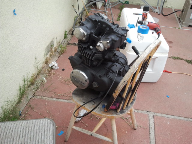

What to do with this frame?
cb450cf
Powdercoating isnt an option because of the $$$ so how would you rattle can this?
Look into "brightside Topside" yacht paint. Great stuff
PC might not be as much as you would think
Strip it, use a strong degreaser, dry, prime with self etching primer, dry, wetsand, high build primer, dry, sand smooth, lay down paint, dry, clear coat (use 2K clear).
Vonyinzer suggested the best option. The "self etching primer" is called Veriprime if you need another name for it. If you take your time, you will have an awesome paint job following those steps.
