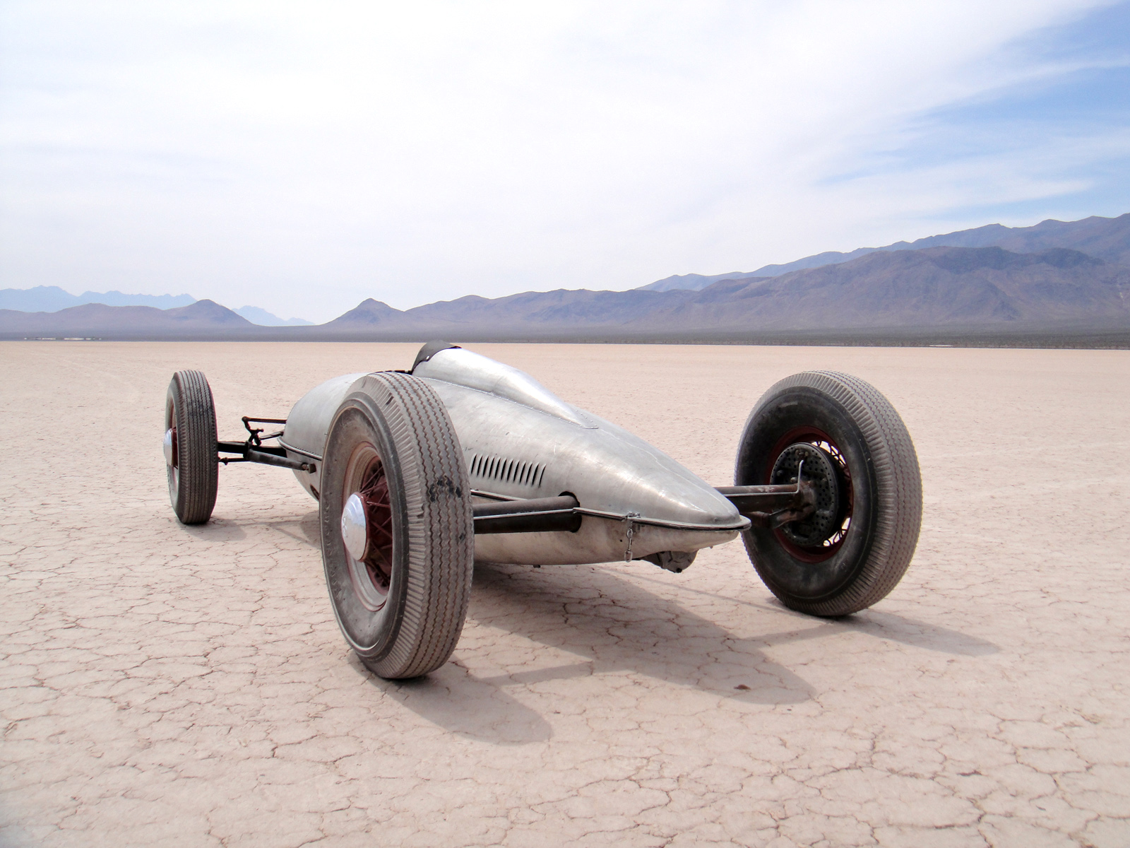

I'll leave you with a little bit of my visual inspiration…
