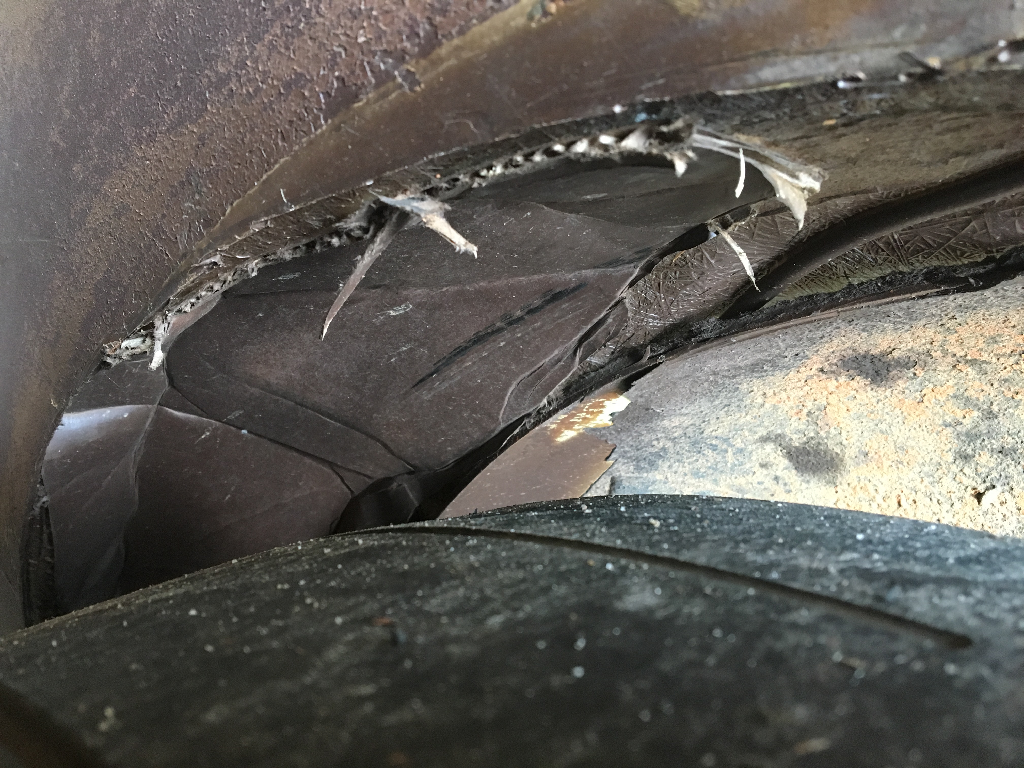

Something else to note that will come into play more later: As in a previous post, the rear fender wells were trimmed out in the front.
This crappy epoxy cardboard job here:
It was necessary to cut out and a little forward of the fender well to make room for the 31" street slicks. The rear end is 72 Chevelle, and the VW body mounts with its stock locations to the Chevelle mounts. I figure that's the biggest driver in the decision for where to place the rear end(axle). However, this also allowed the engine bay to remain fully in tact, left room to mount the JAZ fuel cell, and it gives the car a smaller wheelbase. All this make it a little more difficult to run fenders, even if i wanted to.
