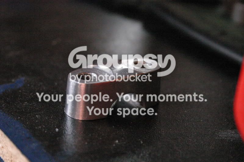

I just bought some myself...it's in the mail. Until it gets here, I'll do some flange polishing...
Top is almost done, bottom is how they started.
Might as polish up some other stuff too...
Nice! i will do the same if I go with a finned clamp. Let me know how your wrap works out since you will have yours before I get mine. ;D

Now that I've wire wheeled the shit outta my flanges, should I put some kind of clear coat on them?

Well first of all, the wire wheeled flanges should be cleared in my opinion since they are steel based and could rust. If they are aluminum then don't worry about it. I bought some wrap and plan to check out that thread. Thanks for the heads up, I know I saw it before but did not know where on the forum it was. Thanks again!
