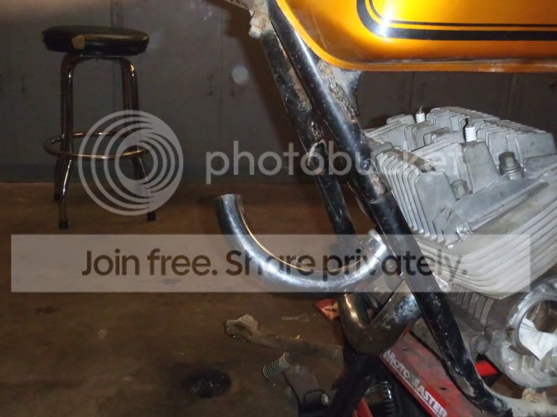

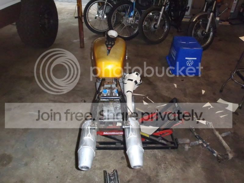

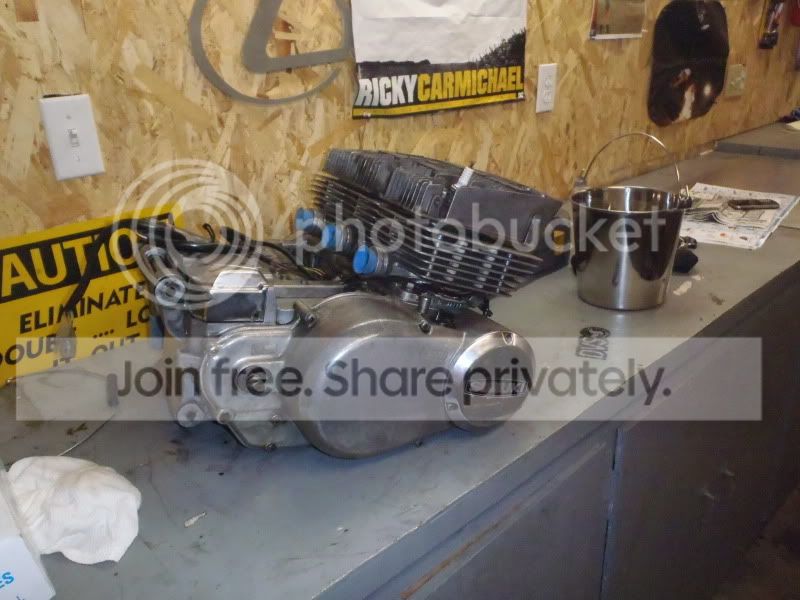

Here are my two options for the pipes. i think the one tucked in looks better but will take a some metal work to get them to cross past eachother. the other way where its sticking out would work without any mods. it wont interfere with tire either but i dont think it looks as good.

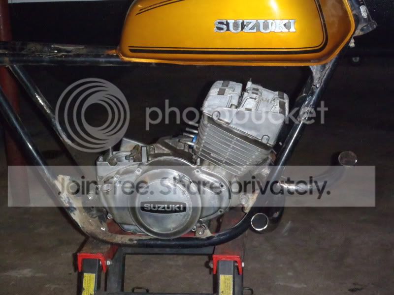

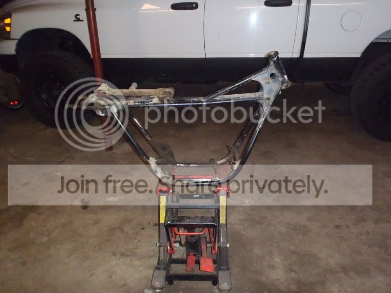

frame tabs cleaned off

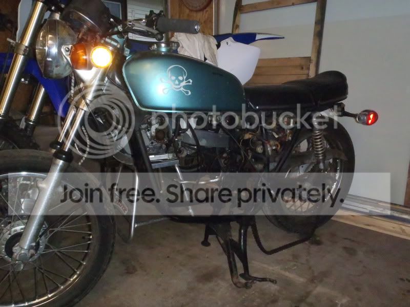

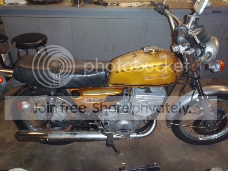

Heres the 380
Not too sure what to do with the 380. Fix and sell or hangon to it?

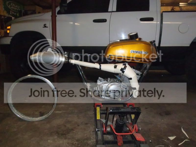

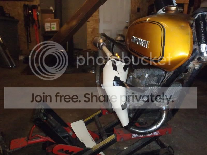

Thanks bert, The 380 is complete so no real point in putting it in the 250 frame other than cheaper insurance. plus the triple of the 380 wont really go with what i want to do with the pipes. Speaking of pipes, quick mocked up my idea to get a visual with some construction paper. Any pipe builders out there with tips/tricks on bringing these pipes to life? This is the only thing im worried about having to farm out and im sure custom built chambers wont be cheap :eek:
