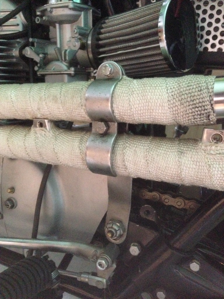

You are misreading the image. All Cl350 exhausts were the same except for the early models with the single black "suitcase" muffler. I believe the header mounts were all the same though. Here is the header mount on my CL350 without any shields and no sidecovers/airboxes.
As you can see there is a little bolt at the top to connect the two halves of the mount together around the headers. I think that is what you are seeing in the photos you posted.
To mount the headers take the shield off and separate the headers. The bottom pipe will slide out of the muffler but the top won't - its welded on. These need to be separated because the angle of the exhaust ports relative to each other are obtuse and you won't be able to cram both headers in properly without a lot of force. once each header is installed you can slip everything back together, reconnect the bottom header to the muffler, place the collars and tighten up the finned joint to the studs, and then secure the mounts.
