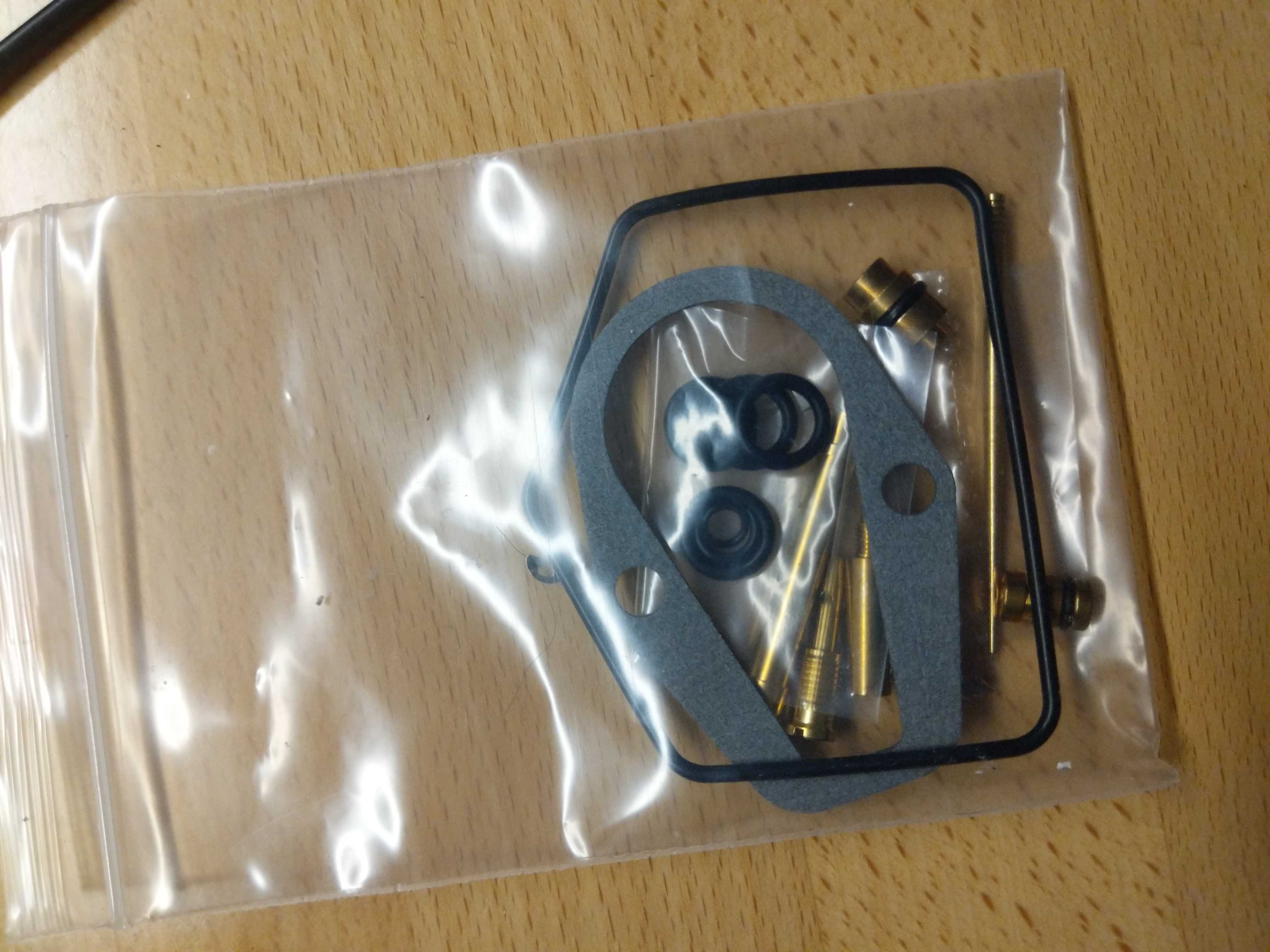

Good advice so far guys! Just got my rebuild kit in, with the specially shaped o ring. Note, last time I replaced the o ring, it was with the kit from DCC that comes with the circular o ring, which I suspect is the problem since it's leaking from that spot.

Unless those are all Keihin factory parts, they are likely junk and will cause more issues than solve. Its pretty widely understood that there is no reason to replace brass unless broken, and to only do so with OEM parts. Gaskets may not make as much of a difference but often are made from cheaper grades of rubber and will swell or dry out quickly.
Ive used the unshaped o-rings. They work fine, use some hondabond to keep them in the channel for installation. The formed ones are obviously easier to install but they both do the same thing. The round o-ring is just easier to pop out of the groove during installation and get pinched.
Other than that, as stated make sure the floats are sealed and your needle and seat seals properly.

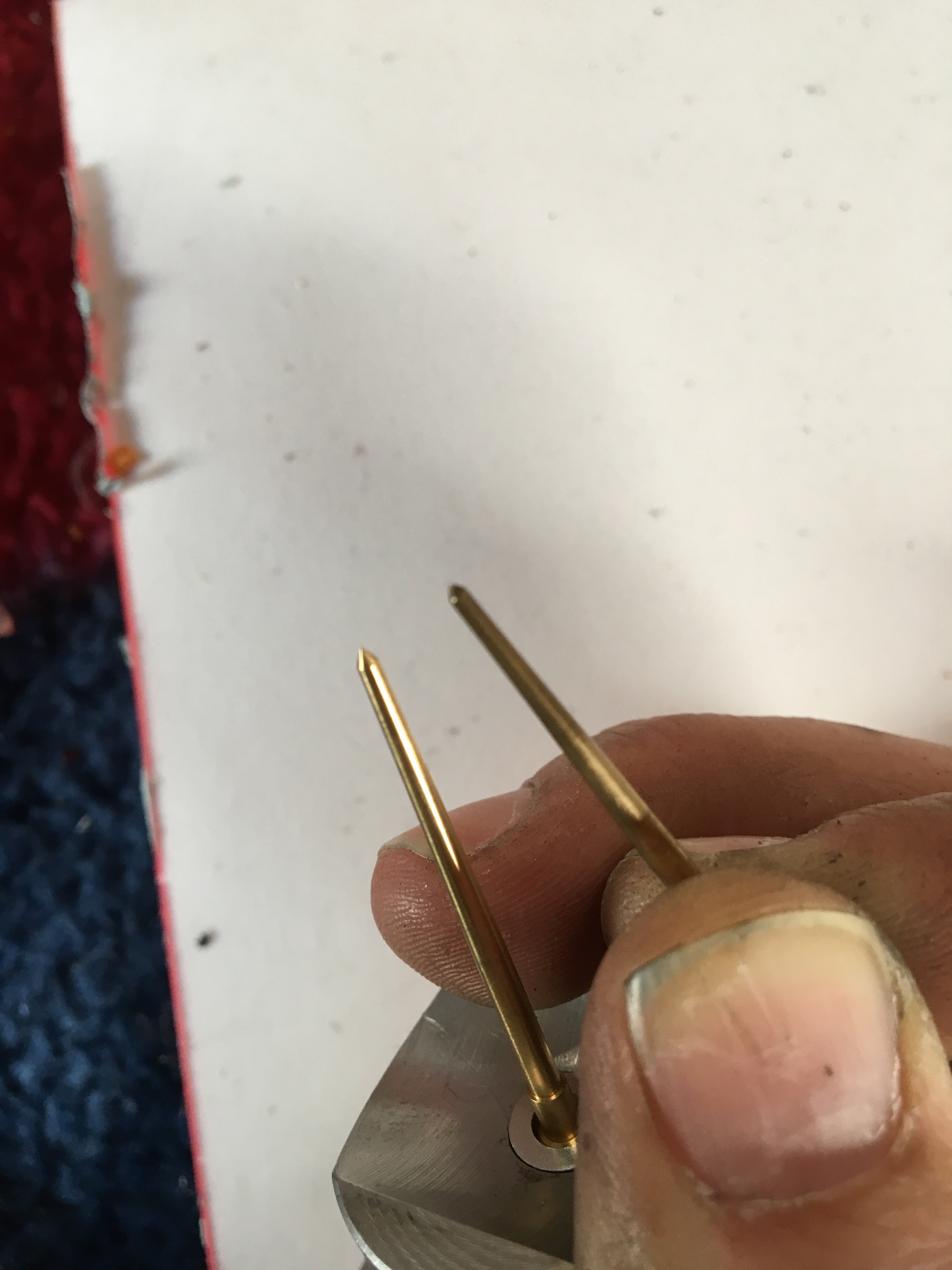

+1 on using genuine parts. I recently got a rebuild kit from 4into1 and the jets and needles are way different (different/missing holes and different taper on needles). I ended up tearing back into my carbs to replace the pieces that are different after playing the trying to sync the carbs.

When comparing jets and needles, confirm the numbers on them are the same as well. Your old parts may have been changed at some point to modify the fuel delivery, or the rebuild kit might be for a slightly different specification.
The carbs on a 40+ year old bike are not always original either, and they changed from year to year in some cases.
