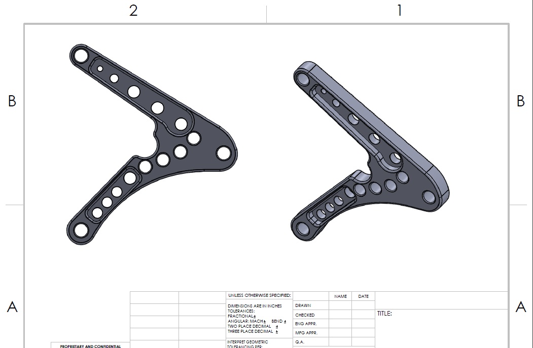

Well I am so hard headed, I decided to built my own brackets using the italian ones as a reference. I will try to make them as much universal as possible. so others could used them in the future.
I still have long way to go but my brother who use solidwork all the time will help me make it happen.
Does anybody has blueprint of the frame bolts and sizes and distances ?
This is a very rough plan, I need to re measure everything. I didnt not had a caliper with me last week end. so my measurement are might not be perfect and my bike is 75 miles away from me so I cannot re take them until next week end.
I think I might need more offset, maybe an extra inch... it would need to be ~2" from the frame. not sure how strong it will be ???

The offset needed is my major issue. Then you have the right side bracket that is different.
A lot of material must be remove on the uppper bolt if you dont want to run a longer swingarm bolt. Once you solve all this you need to fab all the linkage. Shifter is pretty straight forward. Brake is a different animal. Keeping or no the spline shaft.

you can use and print this as a model on 8.5 X 11 regular sheet of paper.
I use frame blueprint dimensions to craft this bracket. It is real size and fit perfectly .
the shape is not right but the distance between the holes is.

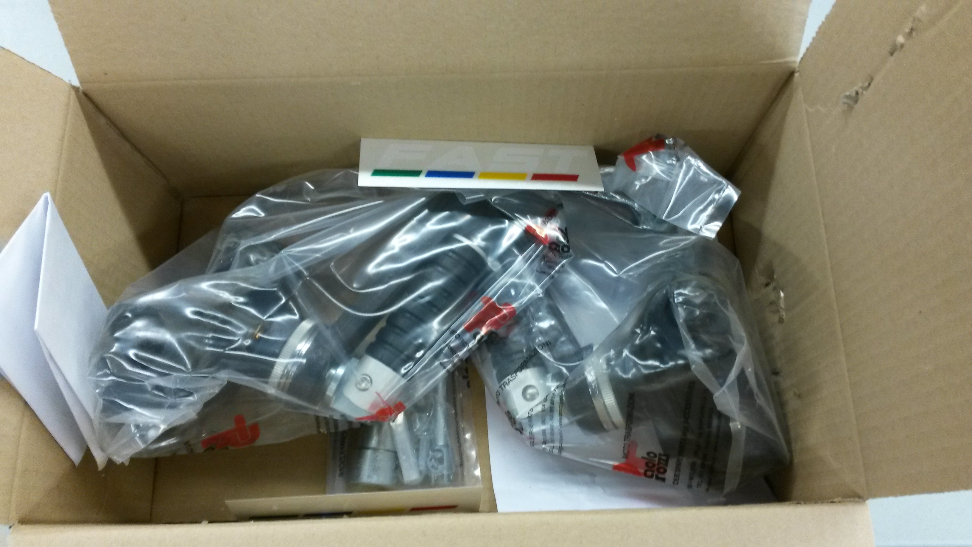

This is what $479 CAD get you
Sometimes you have to bite the bullet
