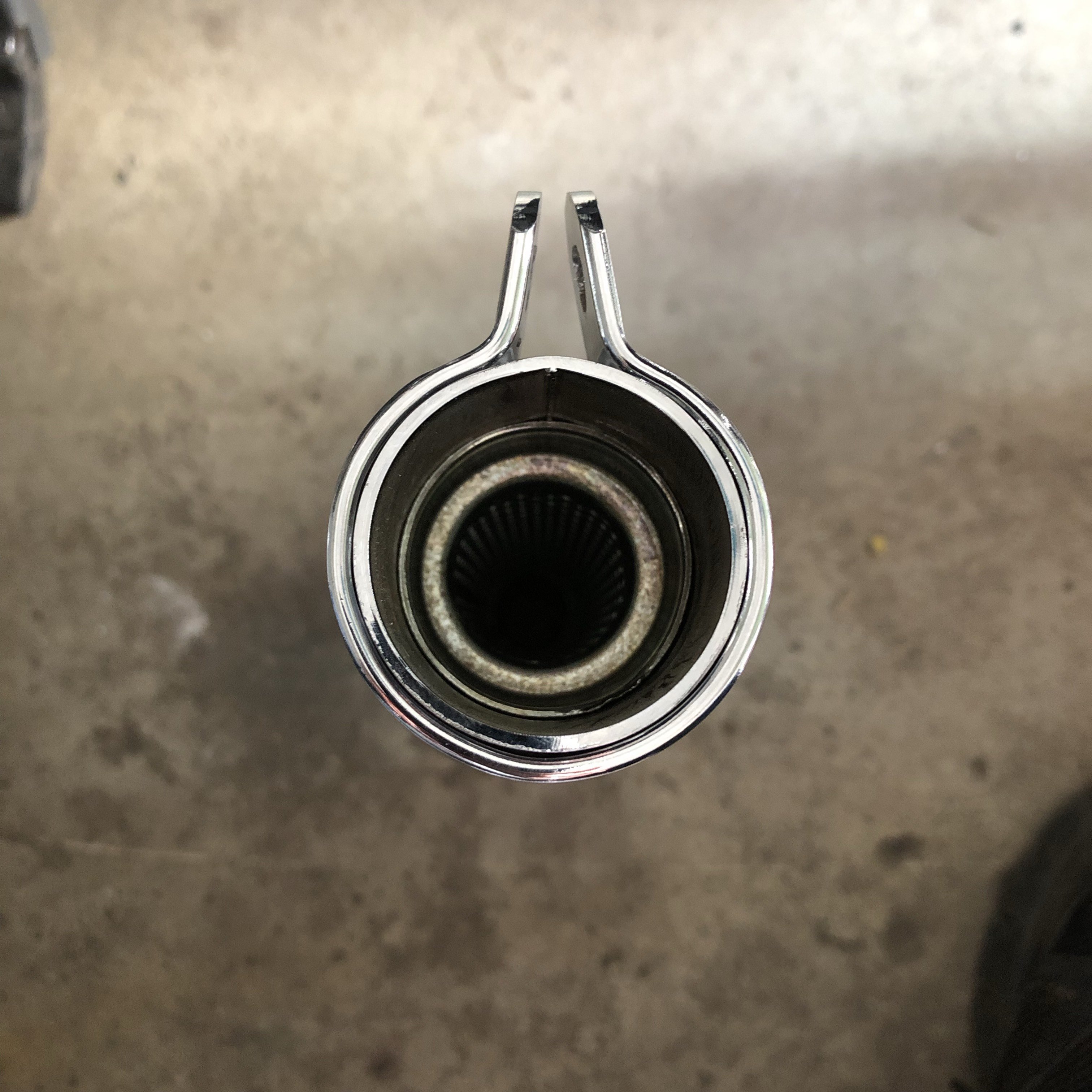

I've never worked with exhaust before so there may be a super simple answer here but the exhaust on my 75 CL360 is 1.5" outside diameter. The mufflers that I bought have an inside diameter of 1.5". When I slip the mufflers on they are very loose. I've broken 4 bolts tightening down the 1.5" clamp but they still won't tighten up to the exhaust.

You will need to cut a slit in the muffler end
https://images.app.goo.gl/KyQPXDz6vomfZYpcA
and/or use a reducer adapter
https://www.ebay.com.au/itm/Set-of-2-Exhaust-Pipe-Muffler-Adapter-Reducer-Sleeve-Adapters-1-5-1-5-8/172515770786?hash=item282abdc1a2:g:KNgAAOSw4DJYll8A&frcectupt=true
Two slits even better. Not too long! Don't cut them so long ghat they extend past the end of the pipe you are clamping to. Only about one diameter.
You can also buy a muffler repair kit from an auto parts store and use a thin strip or two to wrap around the pipe to make the muffler fit snugly.

Thanks for all the suggestions. I wrote Dime City where I got the mufflers who said they are made of steel and do not compress. So how do they normally tighten onto the exhaust? Or do they all need to be cut? Seems strange.
I'll try the can shim trick before cutting them but if all else fails...

I was able to tighten them down using shims from scrap metal, thanks

Any muffler that's meant to clamp down but doesn't have slots in the outer tube is built wrong. Seriously. It's riduculous to think you can get a good seal with a band clamp and two tubes with no cuts.
