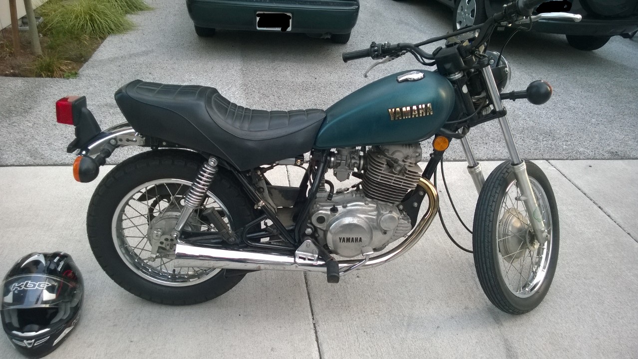

Anyways here are some pics - Day 1 when bike bought -
So far i have changed the handlebars and removed the chrome around the seat. Total Spent so far $1600 (approx)

Looking forward to watching your project unfold! Bike looks in excellent condition, I'm currently starting on my own SR250 tracker build so as always it's interesting to see what people come up with.
In regards to cutting your front fender, just make sure its secure and you have a good pattern, don't try cut exactly where your line is and just carefully round it off with a good flat file! Speaking from experience maybe don't take too much fender off the engine side of the wheel, the previous owner of my bike did this and it barely helps in the wet ;) (Maybe something more like this http://3.bp.blogspot.com/-46T-G-gtI_I/UQaXoirkQNI/AAAAAAAAFTw/h2t5Lk9VsTU/s1600/sr250%2Bmexico.jpg)
Good luck!
SR250's are a neat little bike, cheap to run and modify. I did a quick look around the web before replying to your post and there are a lot of modified SR's out there to get ideas from.
Regarding a replacement seat, if you post or send me some frame photos in the seat area with measurements - lay a ruler or tape measure over the frame when you take the photos - I'll see what dirt track seats I make that would fit your ride.
Alternatively, go for more of a brat-style flat seat pan and if someone has given you a price of $250 for a one-off, padded and upholstered seat that's made to fit your bike, I'd say, "Go for it".
I'd ditch the side panels and make or buy flat or oval side covers (make it look like a number plate). I did rectangles on my tracker and makes a huge difference in the look. Don't know if I'd put "racing numbers" on them though, some of the DTT members get into a right lather if they see them on a street bike LOL.
The tank sits pretty high in the front - like a chopper or something. If it is within your budget, look for something else or lower the front mounts a bit if you can. If you pull the tank off and measure the length of the frame from the forks to the seat and the width of the top frame tube, I - and others - might be able to make a few alternate tank suggestions for you.
Your stock tank looks pretty good in the photos and you may be able to sell it and at least partially defray the cost of a new / other tank. A couple of SR's on the web use the smaller Honda CB tanks and something like that may appeal to you and not break the bank.
I like the black bars you installed and you've already said you were clipping the front fender (and I gather the back one too?).
Unless you've already bought the larger width tires, I'd suggest sticking with the 120 and 90 - the SR's have pretty narrow rims and you might find the wider tires "squirm" a bit when you're riding. You could look for a more aggressive tread in the narrow tires and still have a good tracker look. I'm using a pair of Duro DOT- approved tires on my tracker and they look like the same tread pattern as the Pirellis (MT53's) we used to dirt track on about a million years ago, but I don't know if they make them in your tire sizes.
With your budget, going to an 18" rear wheel is probably out of the budget and the narrower 120 X16 doesn't look too "chopperesque" to me anyway.
Have fun with your build and post a few photos as you make the changes.

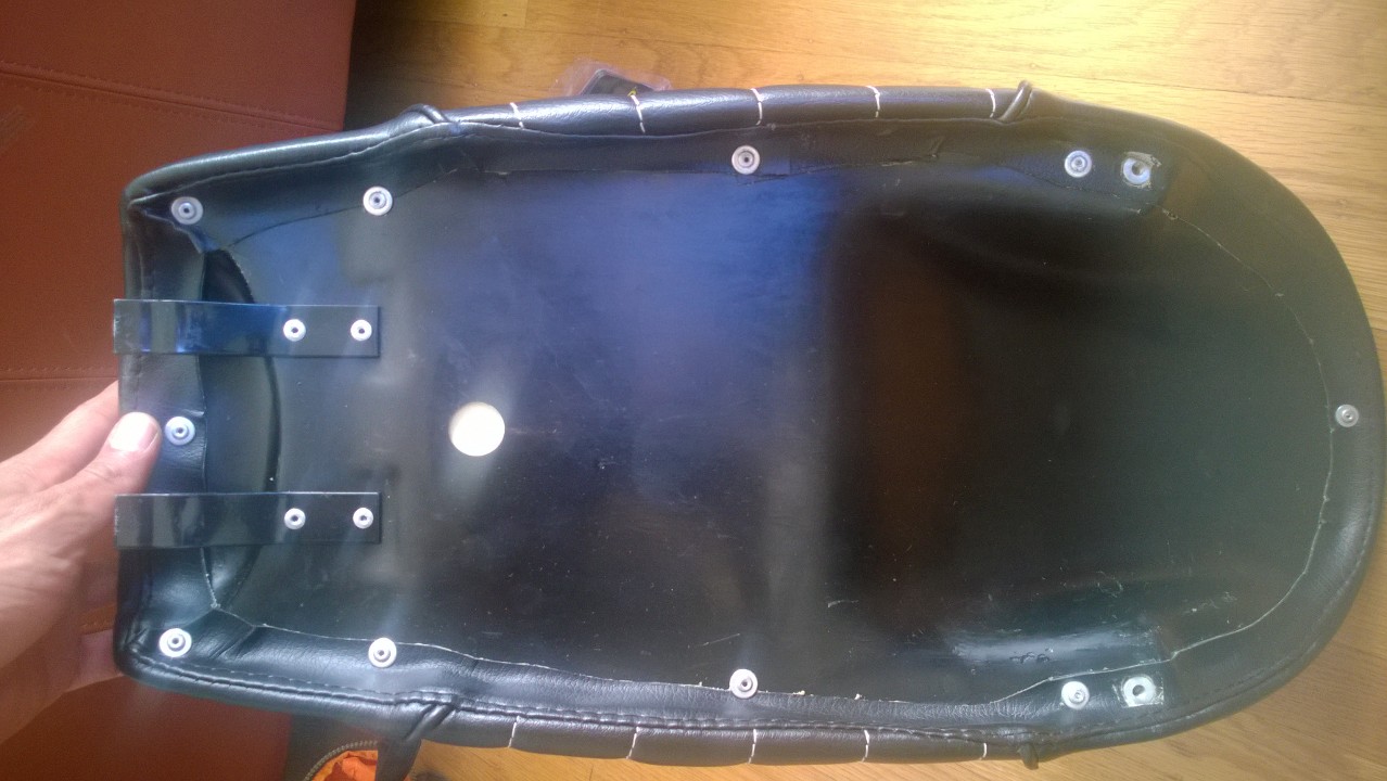

So i got the Seat from MotoLanna and it would be tricky to install it on the bike. Anybody install it yet ?
Basically the two metal pieces have no where to go under the fuel tank and i will have to cut them (in width) in half to get them to go under the tank.
I also have to drill two holes in the frame of the bike to make room for the two screws that goes in the back of the seat. I will also have to drill the holes at an angle cause the holes dont really sit right on top of the frame.
Any tips on how to best install this seat ?
On a separate note i really do love the seat its black seat with white stiching. Goes really well with the bike.

There is no way to install the seat without fabricating a mount front and back along with an undertray of some sorts. Look at my build thread and you'll see how I did it.
I did and i cant figure out how u did that :/

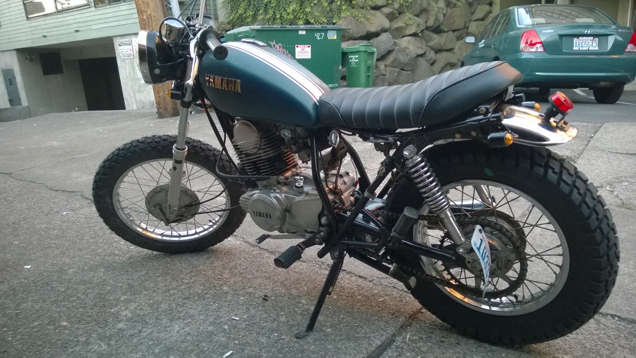

Slow but steady progress as i can only work on the bike on the weekends. Still fidling with the seat but was able to get it to mount on the motorcycle, i will likely need to re-rivet the little bars on the seat to make them fit better under the seat. Installed a little angle at the back of the seat and put a screw through the end of the frame for the seat to sit nicely. But will need more work to fit securely.
Cleaned up the electronics under the seats, shortened the wires, relocated the solenoid to under the seat as well. The antigravity battery doesnt seem to be holding too well and needs to be recharged manually if the bike sits for a couple of days. Wondering if its not being charged, gonna test that out. Any body else have any experience with these AntiGravity battery.
Also moved the rear fender up and under the seat without cutting it which was great.
This concludes all the major updates so far
Blinker lights changed
Handlebar swapped
Front Fender removed
Rear fender shortened
MotoLanna Seat install
Airbox/Battery replaced
Wiring cleaned up
New Speedo
New Tires - Went one size up to 100/90/18 (front) and 130/90/16 (Rear)
Next step will be to clean up the bike and look at a Paint Job - Although i dont mind the current paint scheme all that much either.

Hey Asfi
I like this build. I'm planning on doing some work on my SR250 over the winter. Of course I was considering the airbox removal, but I'm not sure since I'll probably be riding the bike a lot in the spring so I'm curious about the longevity of it. How did you find the airbox/filter swap to work out after riding it for a while?
