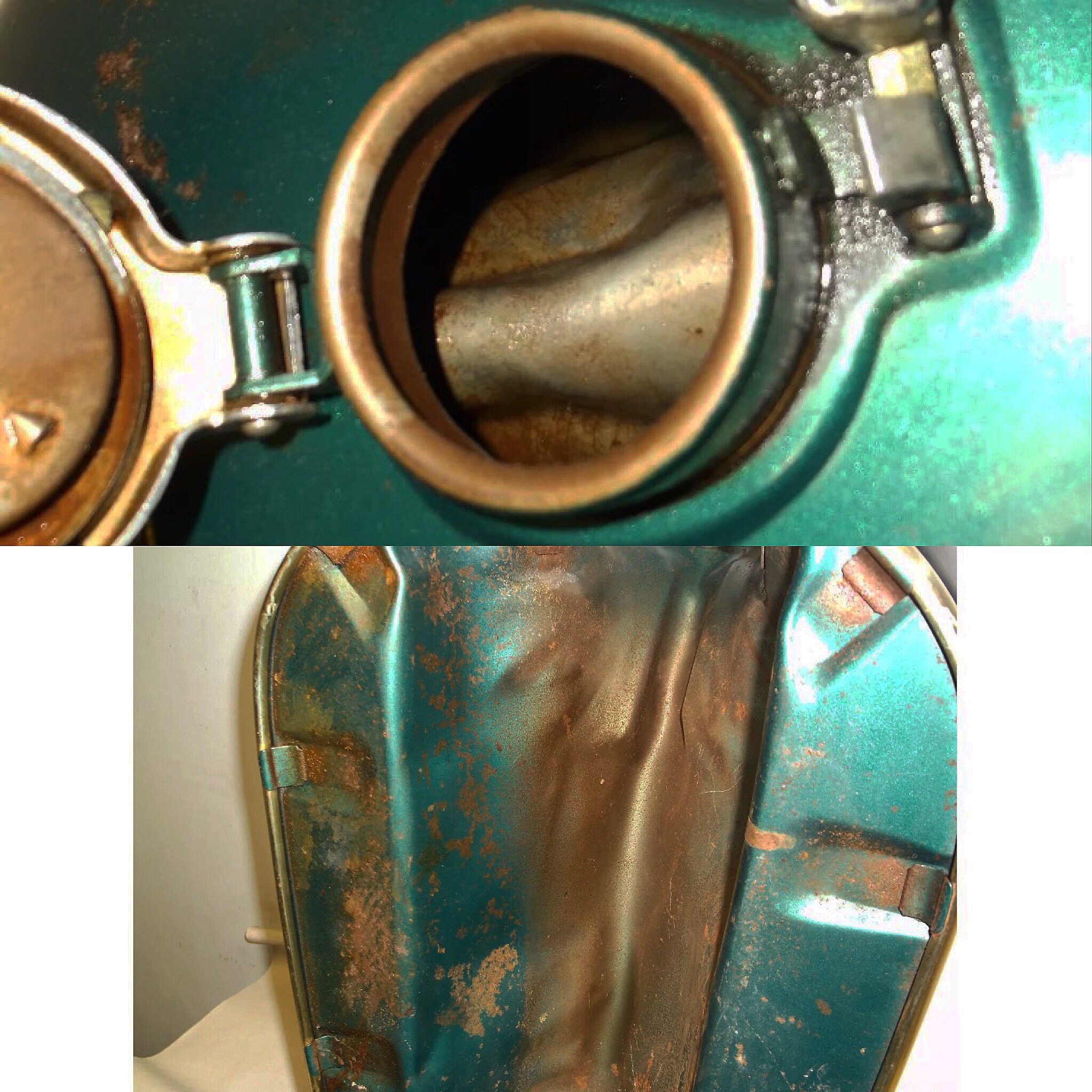

Eyeing out a tank that's got some pretty serious rust inside, and I am not sure whether it's really good for anything other than a paperweight. Thoughts?

To answer your question... All of it. Won't KNOW if there's useable metal underneath until it's clean.

Not necessarily. Feel around the tank, particularly around the bottom where liquid settles, if you can push in spots by hand, I wouldn't mess with it.

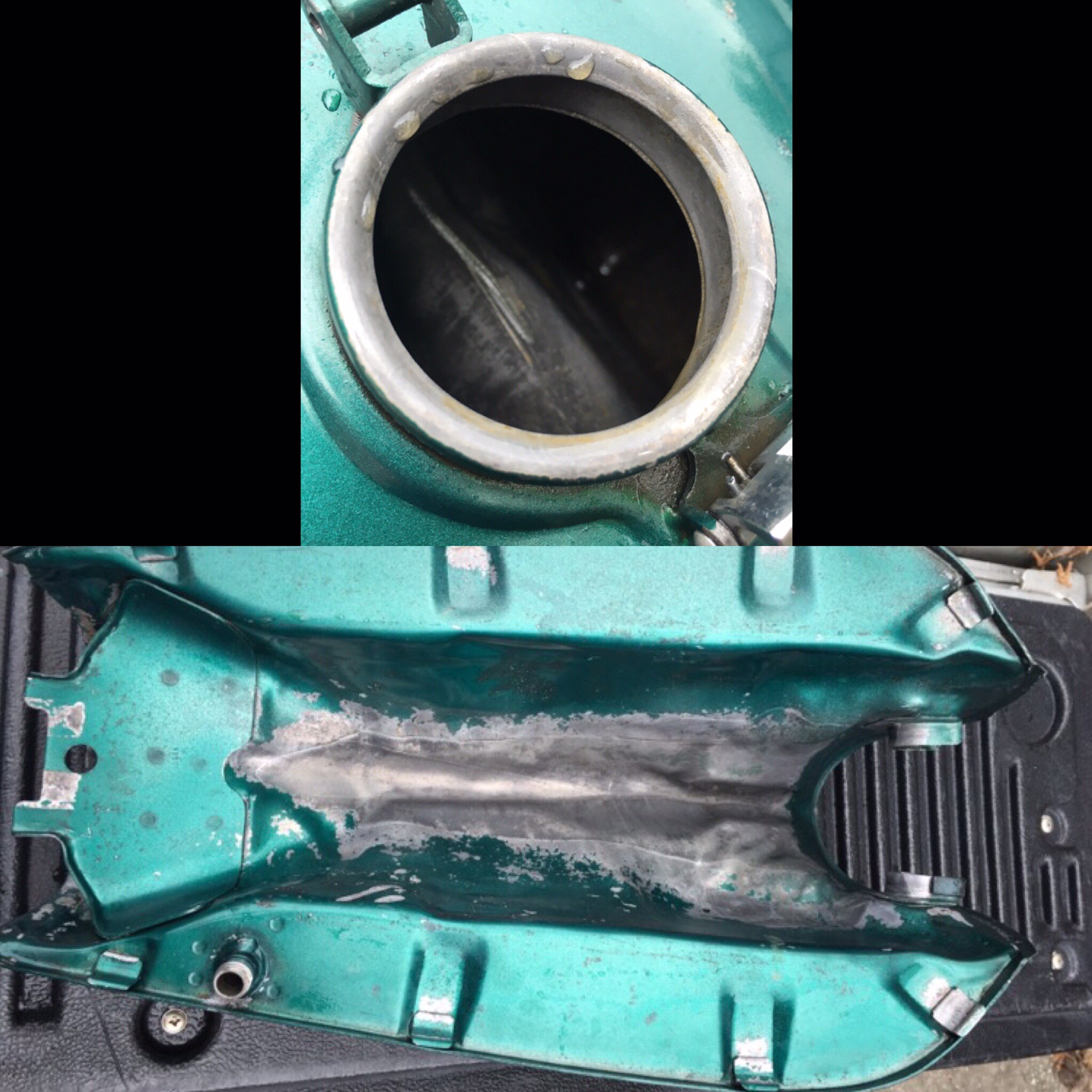

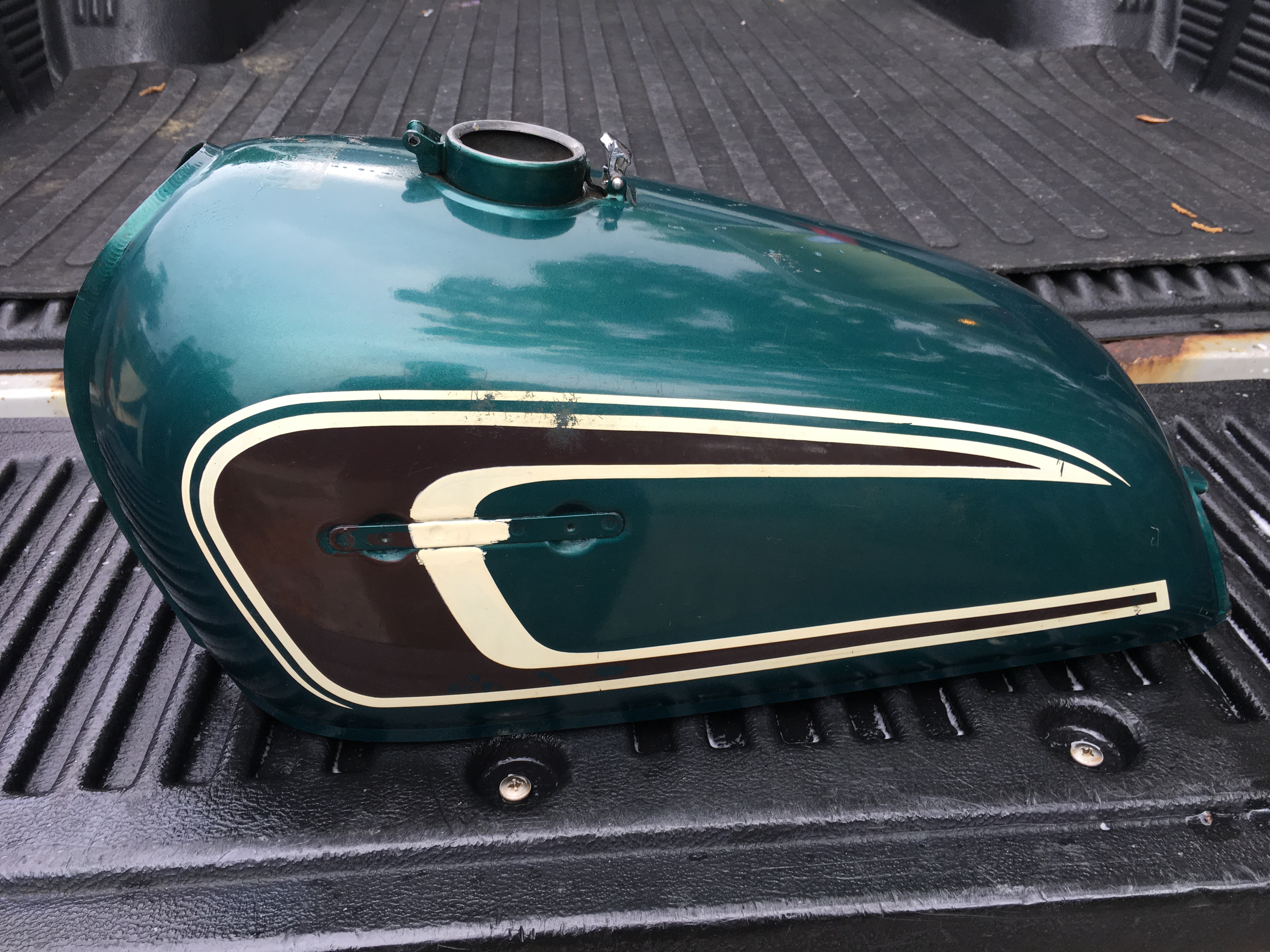

The tank was rotated with a few gallons inside over 24hr period. The underside of the tank was submerged for around 12hrs. As you can see the outside paint wasn't damaged at all(only the rusty areas pulled the rust up and lifted the paint off)

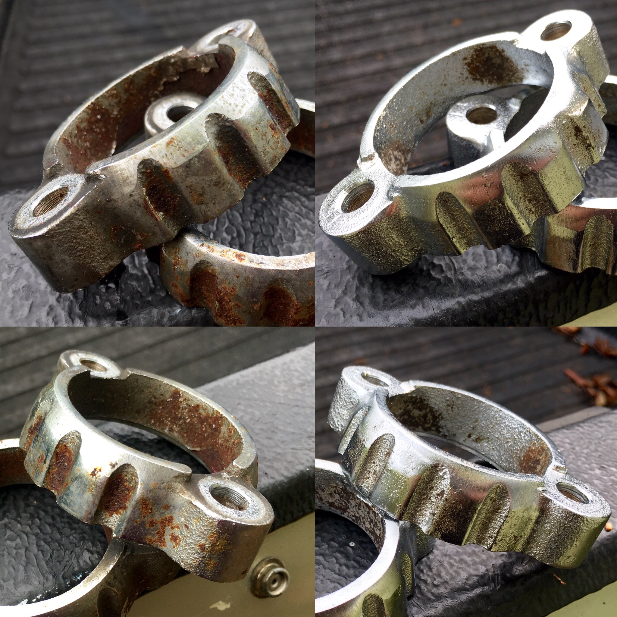

The exhaust rings were only soaked for a few hours in metal rescue that had already been used. It lasts for 1 year after opened and you can strain it with coffee filters or a cheese cloth to remove debris.
