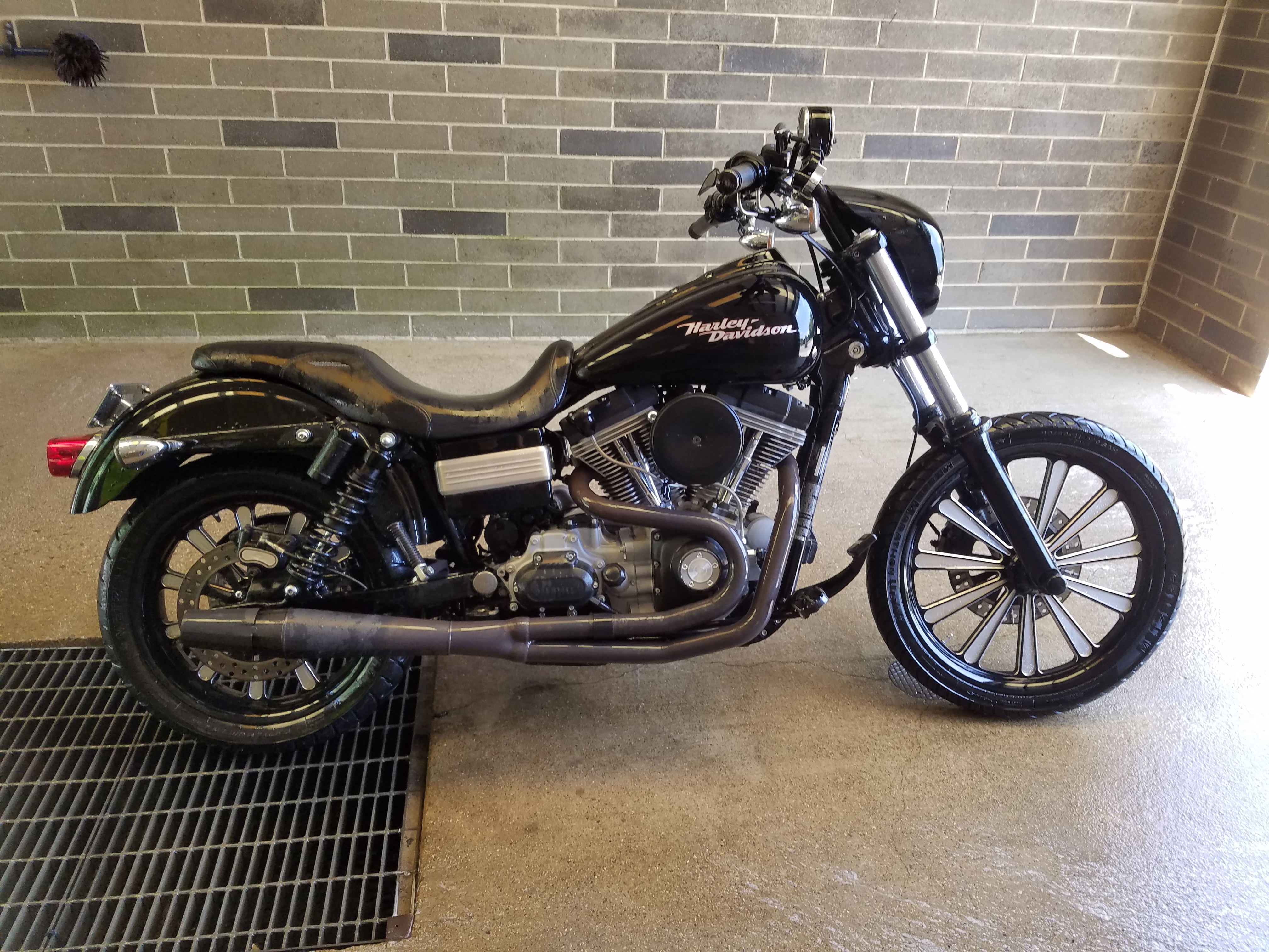

Not much progress on sidecar or 750. Got the engine back from rebuild and seat pan built.. my 08 dyna blew out the crank bearing and had to rebuild as soon as we got back from Europe. 7k or so all said and done so that kinda drained my 750 sidecar build
