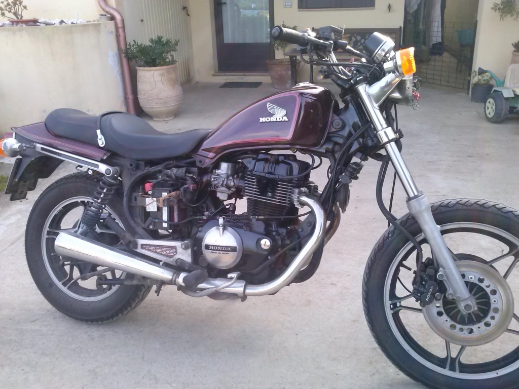

hi,
i have swapped the entire original front end (fork and wheel) with a front end of GL650. it's a good job!
best regards
