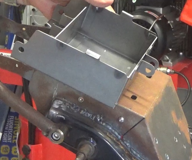

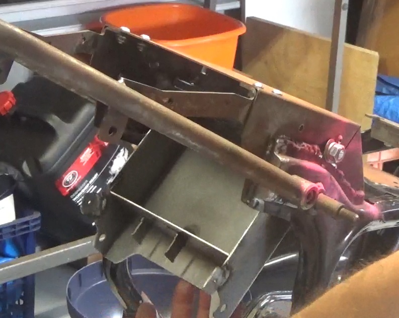

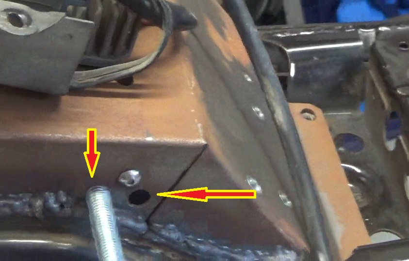

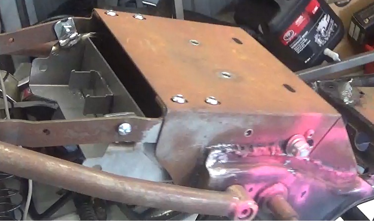

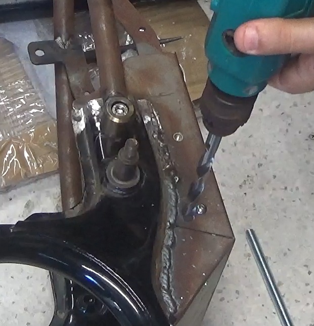

The battery box.
This is one supplied by CRK, and it's designed to go under the engine in place of the H box. It's designed for a Lithium ion battery which can be turned on its side, and has a bracket for the started solenoid rubber mounts.
My knees are not as good as once were, so I'm trying to keep things that may need service access as high as possible.
There is a bit of room under the seat support, so I decided to modify the box to fit there instead. In either case, I'm going to have to extend the leads to the starter motor and find a new route for the secondary loom.
I'm drilling some holes in the seat support, and will use a threaded rod with nuts on each side for the rear mounts in the battery box. This will allow box to swivel down and give access to fit battery.
But then I realized that the box ended up too deep under the seat support, and did not allow placement of started solenoid in bracket.
So I made another hole. What's the saying?......measure once, and cut twice?
That's better. I also welded some tabs to allow back of box to be fixed to existing holes in loop frame.
It's not invisible....but it ain't ugly.
