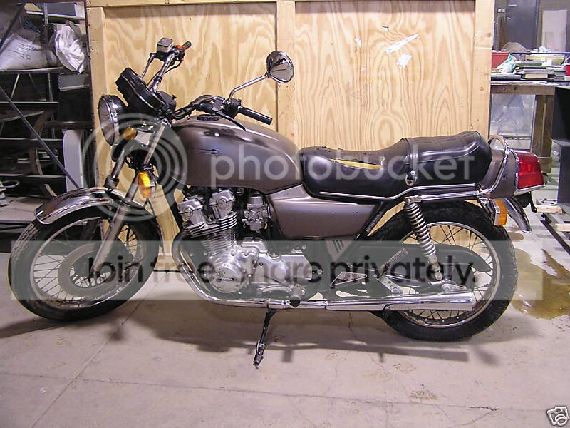

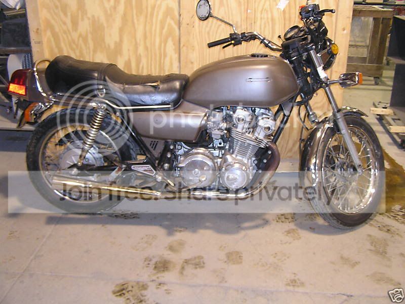

An ugly thing with lots of potential! I drove 300 miles to get this bike. 10k on the clock and runs like a Swiss watch.

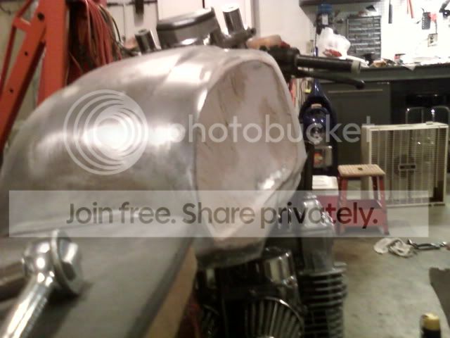

Mock up of seat...

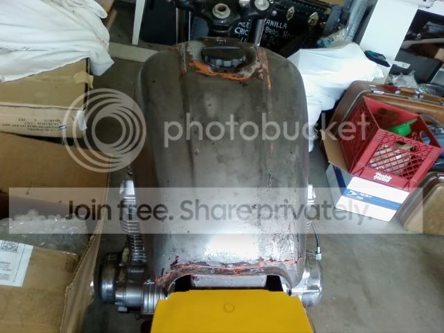

Got tired of stripping the many layers of paint... so I set it back on the bike to admire it

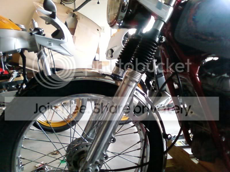

Scored some fork boots. I bought a set of dust seals and used contact cement to join them to the boots. Made for a nice finished look. I want to shorten up the fender, bob it in the rear, and make it a hugger. I made one wheel out of three bad ones! Learned how to lace a wheel via youtube though it took me about 4-5 tries. Got to have the patience of a bass fisherman. Wait, I am a bass fisherman!

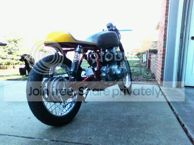

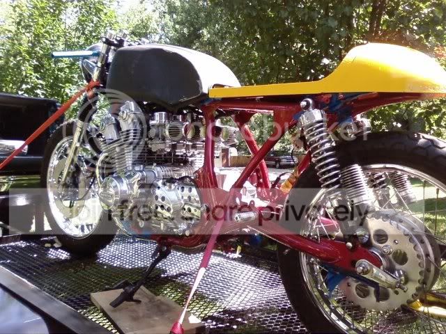

Took the big CB to a shop to get a quote on paint and perhaps some mods to the seat pan... $2200.00 US!!! I stood there like an idiot. I don't deal well with sticker shock. That was so over my threshold of pain! At any rate, the bike got to go on the road for a couple of days! Trailer queen!

Thanks! The only thing I'm worried about is the problems I could encounter using pod filters. My mechanic friend says it is just a matter of proper jetting. Some posts on other forums insist these CV carbs absolutely can't be tuned without the stock airbox. I admit aesthetics take precedent with this build and I would hate to see that ugly thing placed back on the bike.
that is a two way street. The guy that dyno's my builds for me is going to help me tune my CB350... he said that with some lolly pops, and longer pipes, setting the lolly pops early in the tube after the bend they will tune in no problem (with V stacks) so that is what i am doing, got some long fish tails for mine. dont know though, he says it is not going to be a problem but i know that the one my buddy had in college we tried jet after jet and never got it to run SPOT ON wiht his pods and stock pipes... but it looked WAY better so we left it, just got a bit of back fire every now and then down shifting... i just wish i could remember what jets we ended up leaving in there!
I have a 4 into 1 header and planned on fitting a resonator tip, again for looks (flame on, dudes). The can is not a free flow design, more a "silent megaphone" exhaust pipe. When I test fitted it, a couple of dudes passing by the house asked if it was a drag bike. Not the look I was going for! Think a shorty pipe will really f-up tuning???
i do. not sure more about it but you never know till you try. i wonder if you where to make some brass or PVC elbows off the carbs and then put filters on the ends of that if it would offer enough resistance for the pull of the motor to help tuning. but i do not know. i wish someone would make a 2-1 manifold so that we could just run 1 carb and call it a day!
