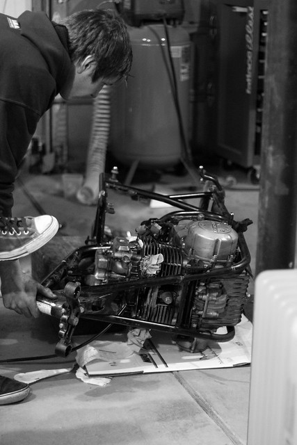

ok so got quite a bit done this weekend. Mounted the tires and put them on to see how high the hoops gonna need to be, got some uncracked carb boots off of another kz we have here at the local junk yard, and got the motor out and cut off all the useless tabs on the frame. Next up on the list is make battery mount, get the rear hoop welded on and get the frame ready for powder coat. While the frame is at powder coat i get to start polishing motor pieces and start doing filler work on the tank.
My friend came over who is really into photography so all i really have are some artsy fartsy photos lol, kinda wish i had just regular pics but oh well.
Tires mounted
and the motor out and ready for cleaning
