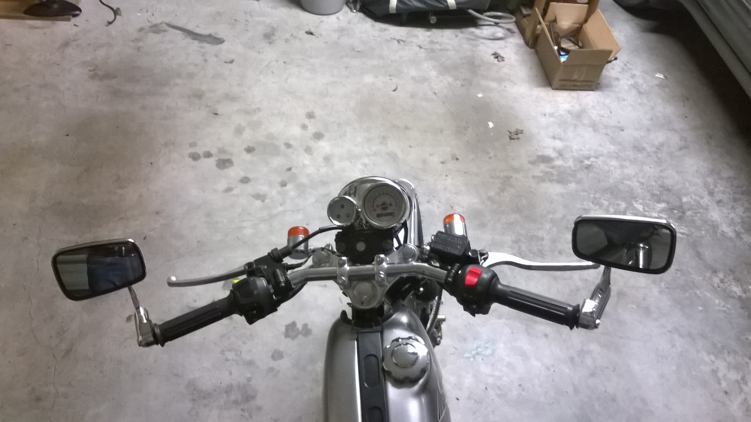

I got on and did the mirrors tonight. Was very easy, the weights did not need much persuasion to move. Slightly more on the throttle side and slightly more work needed with the dremel throttle side to make sure the expansion style mirror connection didn't foul the throttle sleeve or rubber.
They have about 5 positions that they can easily click between. Will settle on what I like best over the next few days.

I bought some bar end mirrors very similar to what you have, visibility is so much better now!
Bry
Yep the mirrors made a huge difference. I had two goes on the throttle side to get it right. Sorted now, all tightened up and fixed in place.

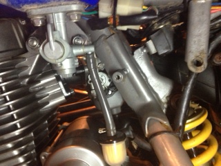

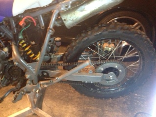

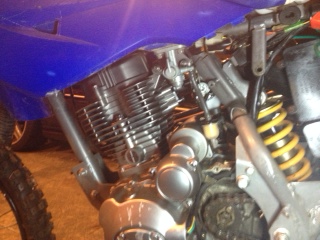

I have a chance to scavenge parts from a 2007 Sktyeam ST150 dirt bike. Just 20 hours of usage. A mate bought it for his kids but it was too heavy and has just sat in his garage.
Thinking about
Engine or just head, cylinder piston etc to do the 150 upgrade?
Carb CARBURETOR (150CC)(Keihin PTGM34BTGaST) How do I figure out if this is better than current stock one?
Rear hub and disk brake (would need relacing to my rim and an appropriate sprocket as the ST150 rear wheel is 16 inch)
Parts list here
http://www.skyteamcanada.com/st150y1_parts.htm
Any thoughts?

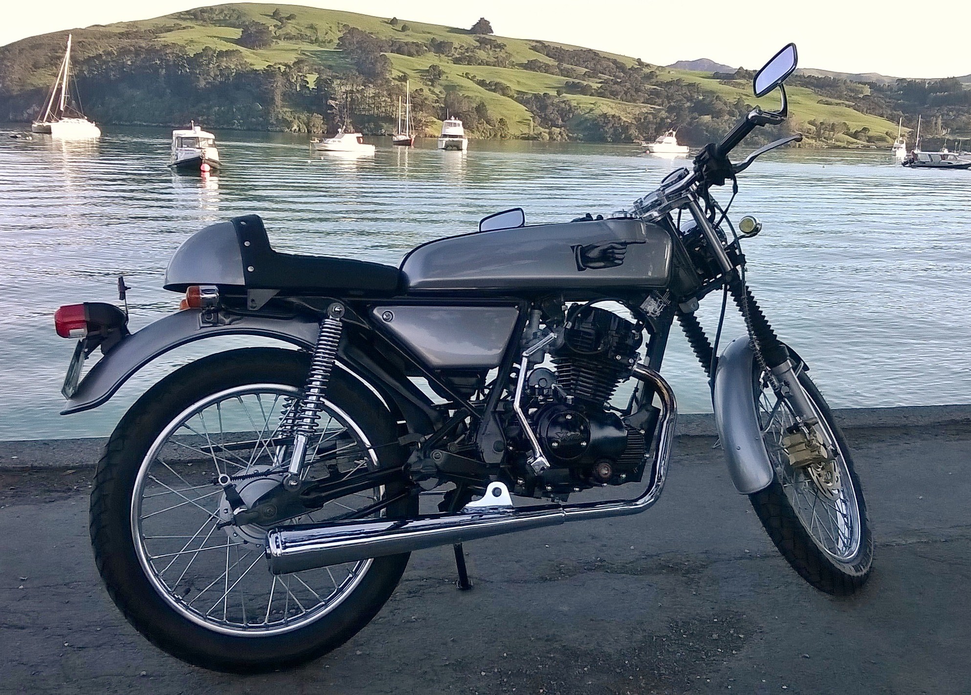

Had great fun in hilly twisty parts of my run to Akaroa and back for the weekend.
Confirmed the lack of oomph at full revs in top gear. Ended up trickling along on the straights at 75-80kmh. Will do the spark plug chop test when time allows.
Just a new decal since last pics.
