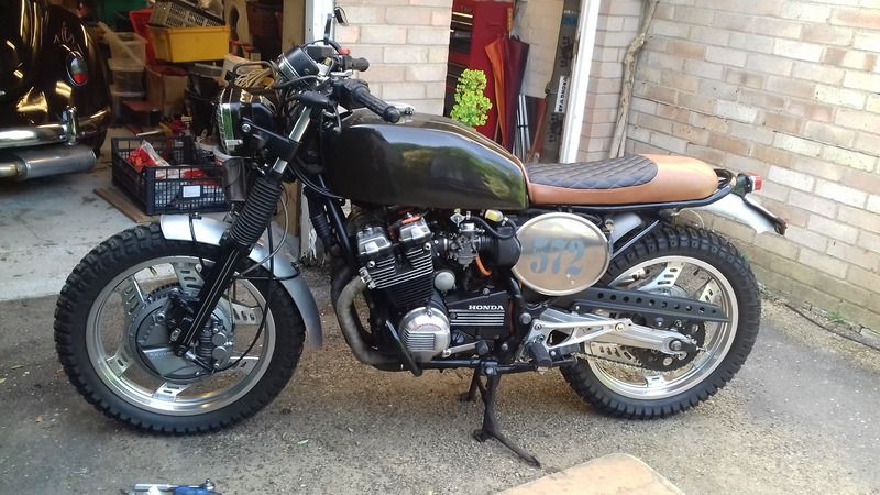

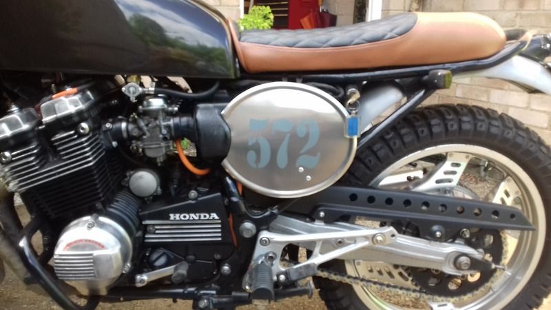

« Reply #259 on: May 21, 2017, 17:19:50 »
When you decide not to go drag racing but spend time tinkering, ready for a London bike event next Saturday  ;)
I fixed a few jobs:
Weeping petcock - new fibre washer
New fuel filter - old one had loose pipe connection...yikes!!
Oil topped up - not ready for a change just yet.
Clutch cable adjusted
Two plugs changed for new. Two are uber tight and don't feel right putting any force on the socket....hmmm? (Not chancing it before the event)
Fitted the side panel number roundel and decals. They're to be detailed...more anon ;)
Firmed up the numberplate fitting, nice n solid now.
Lowered the headlight circa 40-50mm, liking the lowered look, ready for a new feature...;)
Quick road test coming up. - Just done it...wow, adjusting the clutch has made it so much more responsive and the gear/clutch change is snappier :)
