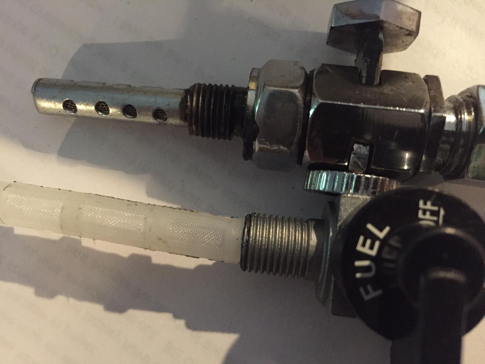

I picked up two that look like this from eBay . They work but dont recommend them. One leaks and both requires hammer to turn off/on. And no reserve. Real crap.

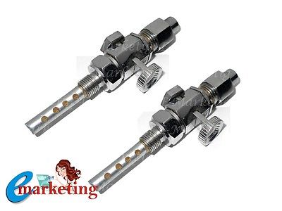

Since I wasn't sure, I ordered a pair from the seller in India. The threads on the petcocks I received are about 60/100" in diameter. One leaked badly and when I eventually got a replacement, however, it was different threads again ( about 70/100" ) and did not fit. So I ordered a set of 10mm ones from Ebay and they do not fit either. They are about 80/100" in diameter.
BTW, the hardware store had nothing that fit my bung... so I ordered a pair of 10mm one and they came today - They dont fit either. They are about 80/100" in diameter. So the only thing left is NPT. However, do I look for 1/8 or 1/4 NPT? Or will a 1/4 x 1/4 also fit? Really need help here...LOL
Here is the ebay item that does fit, but is so poorly made , I need to replace.
http://www.ebay.com/itm/NEW-FUEL-PETROL-GAS-TANK-TAP-PETCOCK-1-8-x-1-4-BSA-TRIUMPH-NORTON-AJS-MATCHLESS/171595586318?_trksid=p2047675.c100010.m2109&_trkparms=aid%3D333008%26algo%3DRIC.MBE%26ao%3D1%26asc%3D36895%26meid%3D0fb03fd1a4934ab6ace6068a2c224710%26pid%3D100010%26rk%3D1%26rkt%3D13%26sd%3D171211144891
also pictured is the 10mm one that doesn't fit next to the leaky one from India
