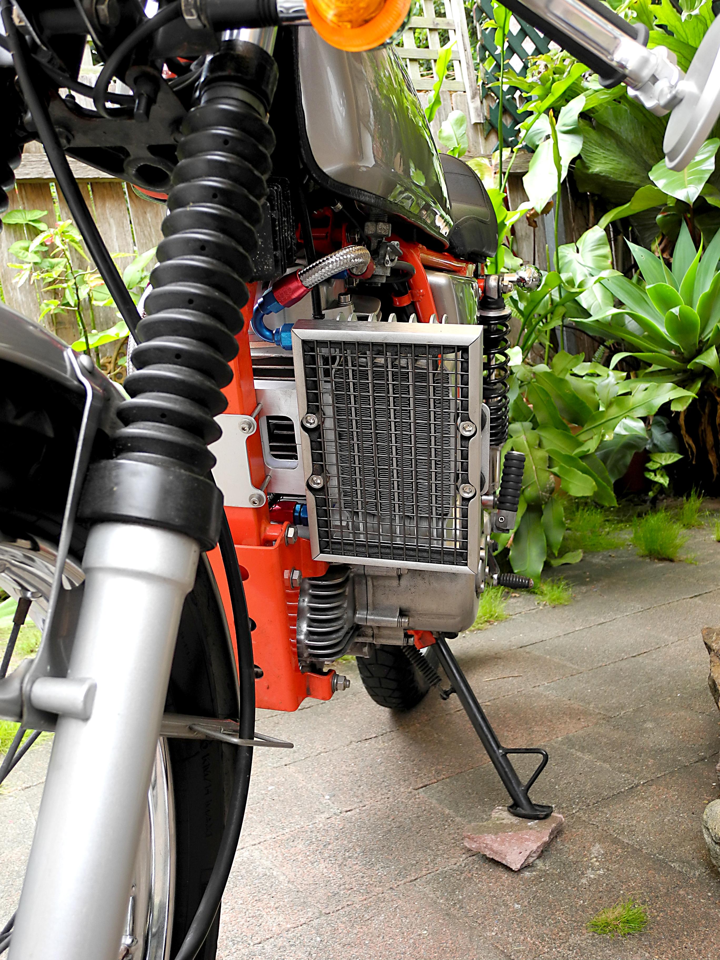

As i have an Ace 50 i have to flog it to keep up with traffic,and am worried about oil temp. Has anyone fitted an oil cooler and what fitting/cover would i need .
Hi Paul,
OO Rracing in the UK have a heap of different coolers, so maybe ask them what you need for the 50.

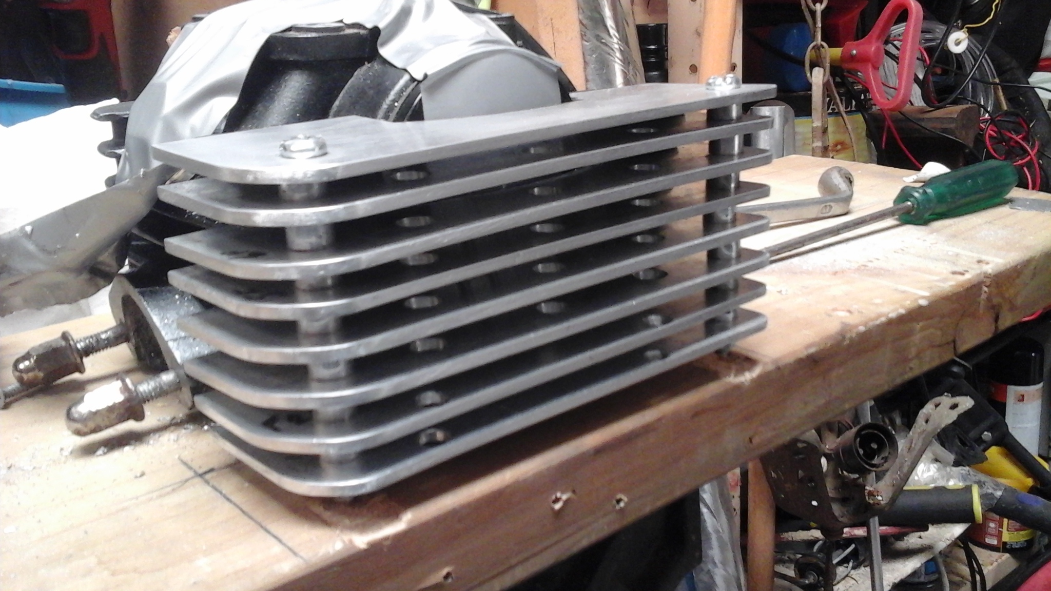

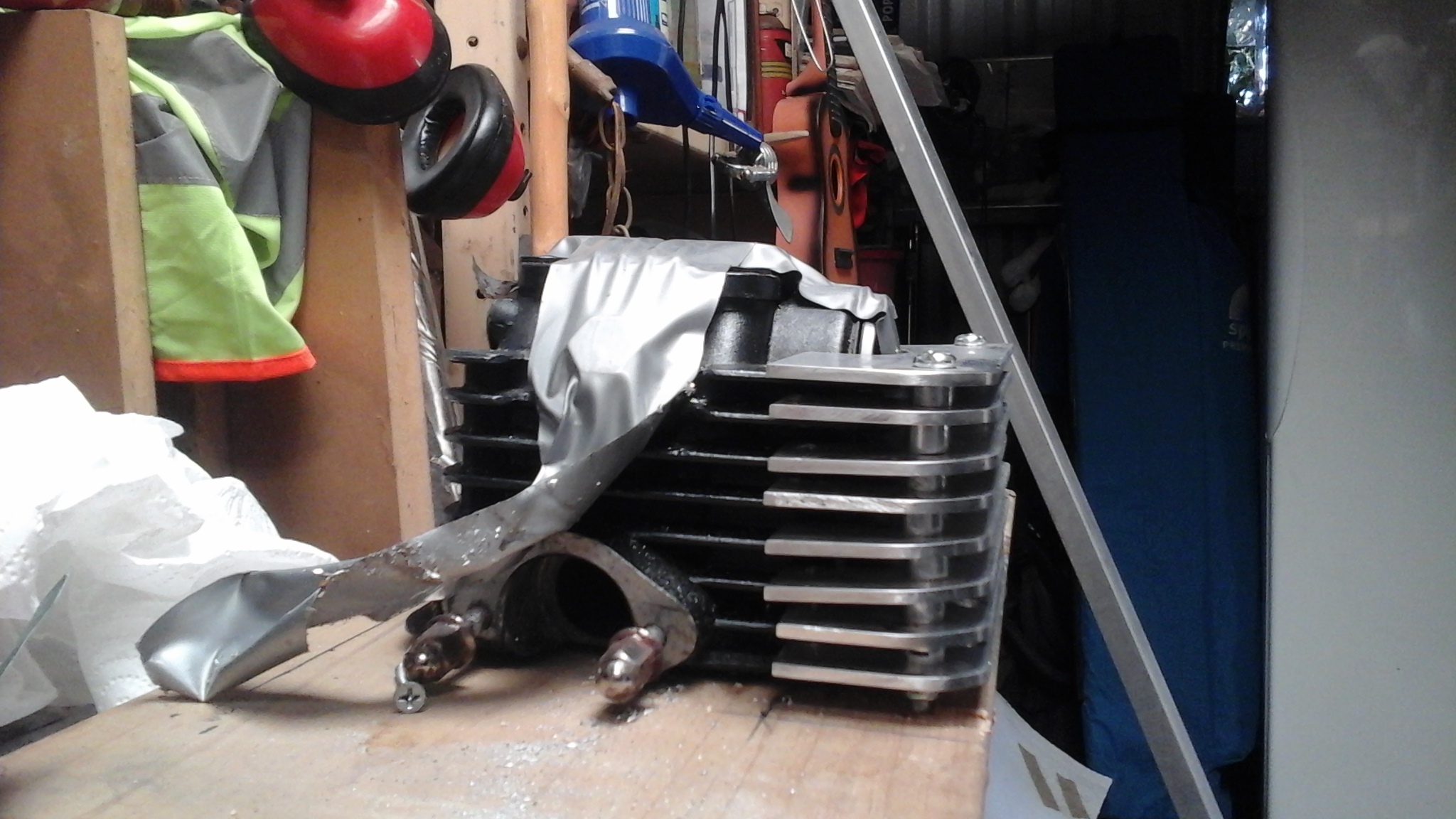

Progress made , individually made fins for hopefully maximum contact for heat dissipation .
All by hand , drill , hacksaw and file .
Progress , 50mm by 3mm alum. each fin 170 long . 1300 of extra fin .overhang front and back is about 20mm extra Its a push fit to get on so hopefully contact to dissipate heat . 3mm fins don't fill the head fin spacing , the round spacer are head fin spacing size , so hopefully i will have airflow over the original fins .
The next side will be interesting , as it's much more exposed around the spark plug , but i am aiming at the same size/style but time will tell when i have to clearance around the plug and lead .

Paul in adelaide said:
hopefully contact to dissipate heat …
You have been busy!
It will be easy enough to tell if they're working.
To test the oil-cooler on my 'Ace' I took the bike for a hard run then put a hand on the inlet then the outlet hose. Scientific!
