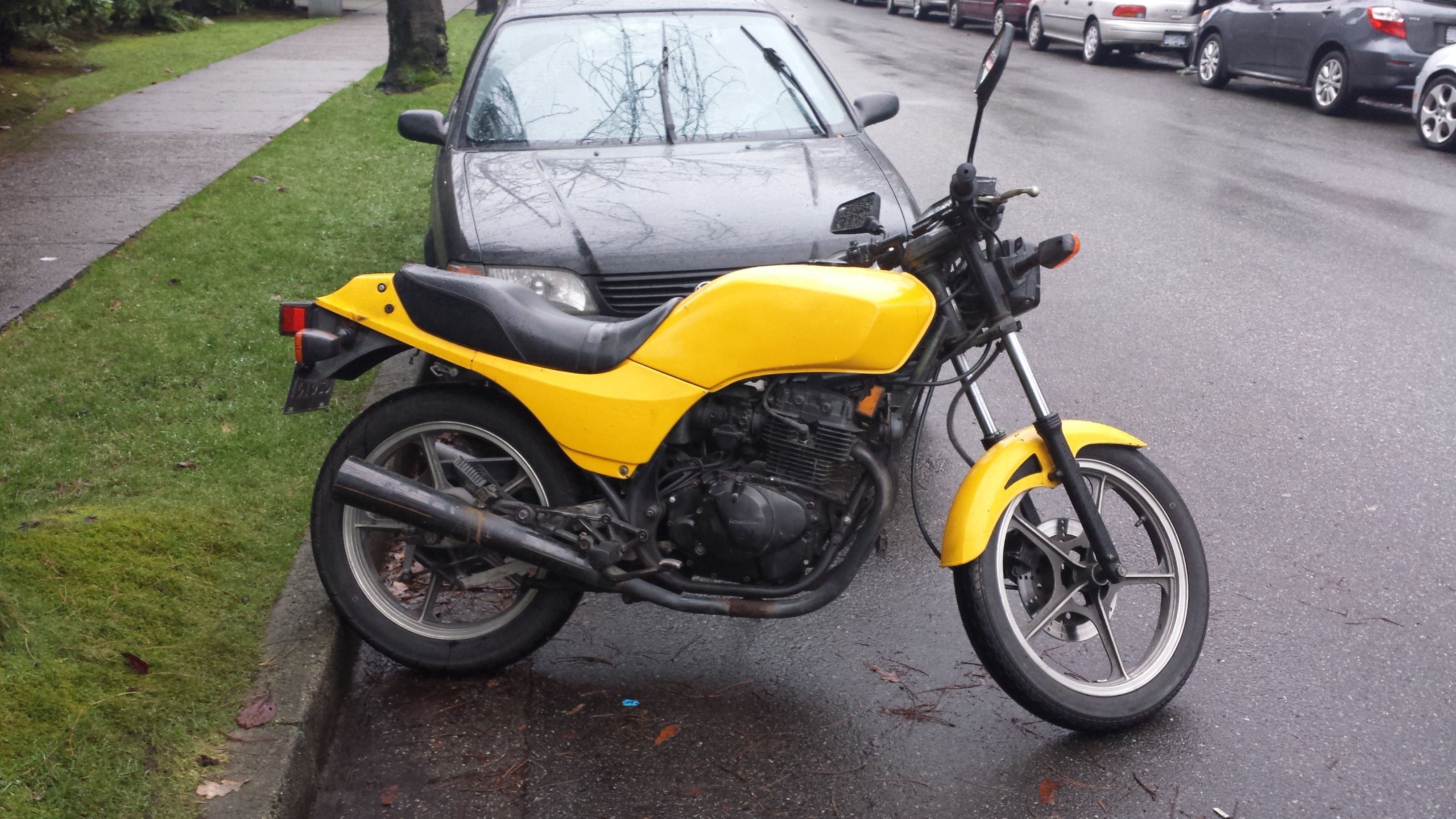

I recently purchased a 1987 Kawasaki GPz305 (Belt Drive) from a woman named Goldie.
http://www.motorcycledb.com/Kawasaki_GPZ_305_Belt_Drive_1987/31585
She got the bike for a couple hundred bucks from a friend, with the intention of taking lessons and getting her license. At 5'2, she felt too short for the bike, and decided to let it go. It was parked in an alley and had been sitting, uncovered, for 2 weeks during a period of heavy snow (for Vancouver), and some rain. The front fender, gas tank, side covers, and cowl were all rattle-canned bright yellow. Combined with the square front light and possibly the ugliest instrument panel ever made, the bike was not making a strong impression.
It took about 30 seconds to start. We chatted while we let it warm up for a few minutes, and then I took "Yellow" for a spin.
I had previously been riding a 1982 Kawasaki 250 LTD. However, I have to give it back to the owner when he returns from Columbia in September. I have very little experience with motorcycles, to date. So please understand that my opinions are subjective.
I immediately liked the riding posture of the GPz more than the LTD. I felt like I was in a more active posture, but still relatively neutral. I felt like this would be more comfortable for longer rides. The 305 is substantially faster. It redlines at 11k, which allows for a lot more play in the power band where the bike is most fun (6500+). The exhaust was nice quiet, which I really like.
Earlier in the week, my friend let me borrow his 2006 Ninja 636 for a few days. Well, that changed everything I knew about riding a motorcycle. I couldn't believe that bike could feel so responsive. I hated the look of the bike, but I loved the feeling of riding it. Getting back on the 250 was an eye-opener, for sure. I knew that I wanted a bike that was simple enough mechanically that I could work on it myself. But, I also wanted something light and agile for congested city riding.
I rode "Yellow" out of the alley and on to the street. I gave it some gas and felt the engine surge to life. Everything felt so right. I decided that I was going to take it before I got to the end of the block.

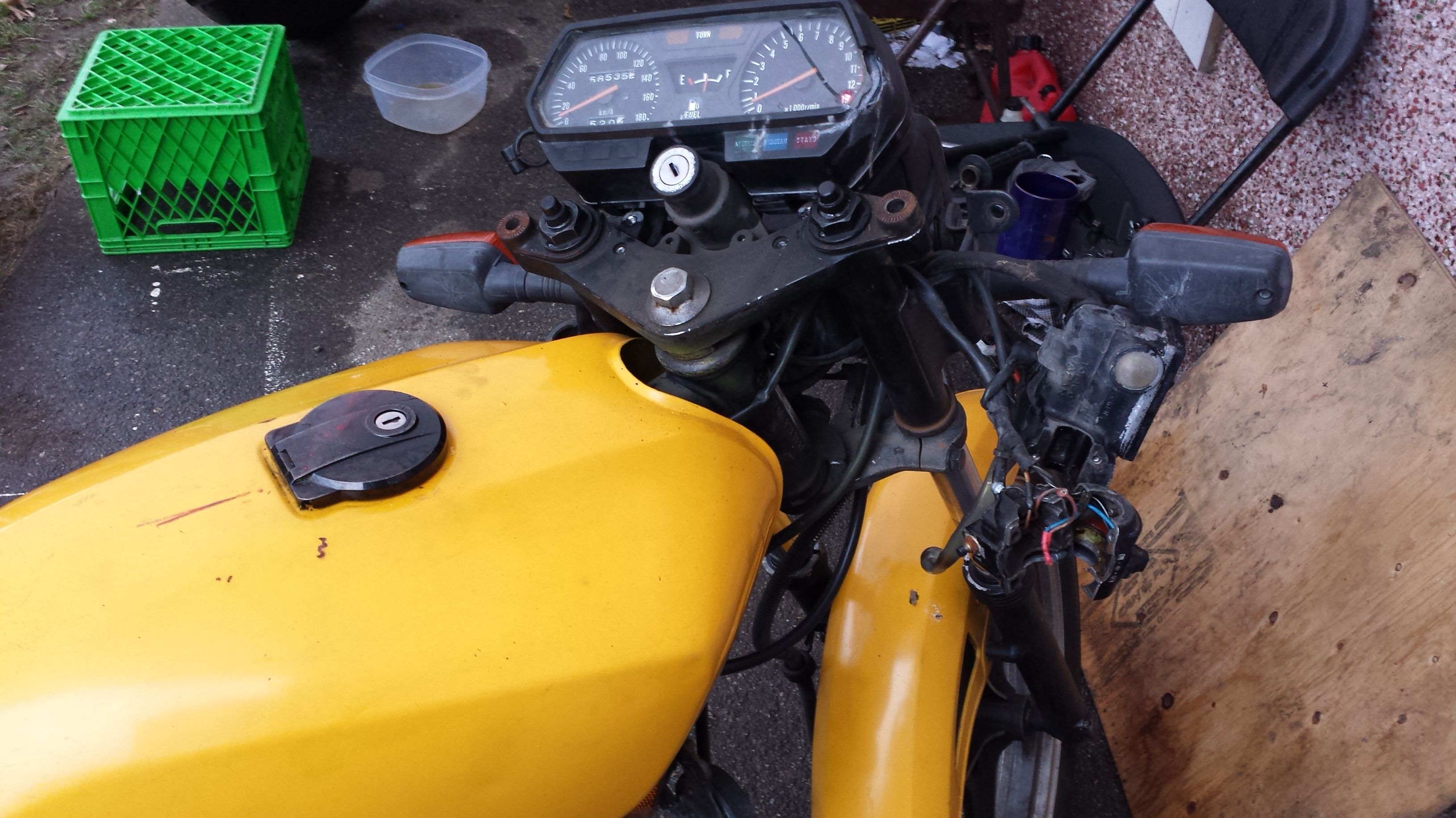

Bars
Stock mirrors are gone and replaced with a bar-end mirror. I decided to flip the bars upside-down, so I removed the throttle, and the unit beside it with the killswitch and starter. I then took off the clutch and the controller on the other side. Took the bars off next.
Then I realized that if I wanted to flip the bracket with the splines that lock the bars into position, I would need to remove the whole yoke. (I think that's what it's called. First bike. No manual. Going for it.) I didn't have a wrench big enough to get around the nut at the top of the fork, so I borrowed a friends motorcycle and rode to the hardware store.
Armed with a 27mm wrench, I tried to turn these bolts and failed entirely. The sun was setting, so I reassembled everything and just wrote the day off as a learning-experience.
Instrument Panel
The master cylinder seems to have broken the instrument panel. I assume this was from the bike being dropped. There are numerous signs of this bike being dropped on both sides. I'm going to replace this instrument panel soon. But, I'm also somewhat tempted to try and reuse the gauges that I have and just build new housings for them. Soup cans might work!

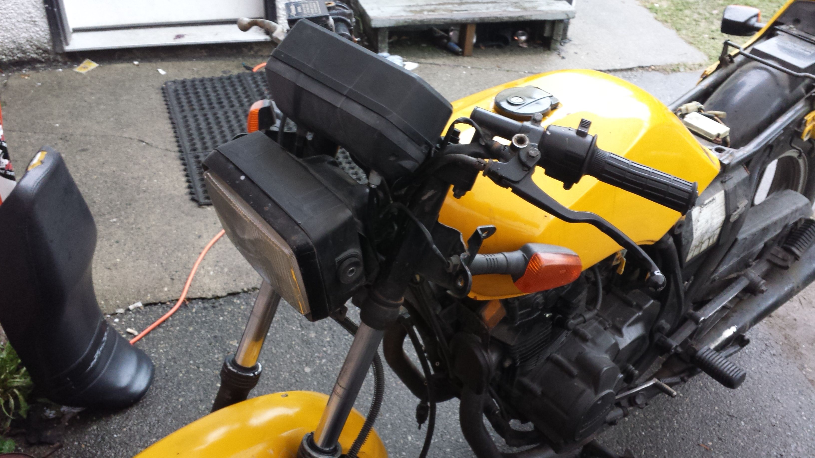

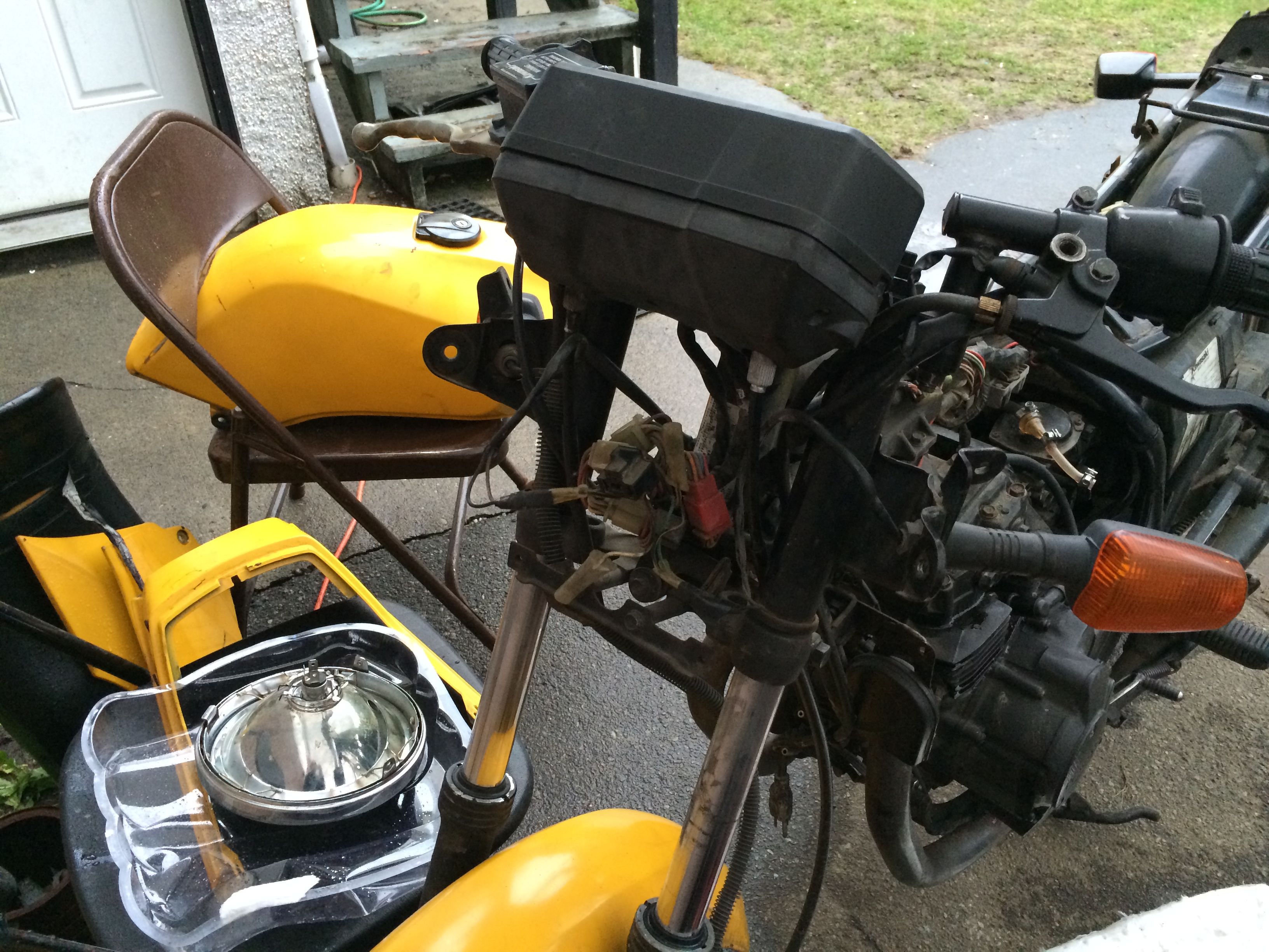

Headlight
My friend bought a bottom-mounted headlight to replace the stock light on his GS400E. I was thinking about buying a smaller headlight for my bike, possibly a bottom-mounted unit as well. Instead, I asked my friend for his stock head light. He graciously parted with it, and I began to remove the rectangular horror from the front of my bike.
I had quite a few wires inside my headlight assembly, but it was nothing compared to the rat's nest that my friend is dealing with! The previous owner of his bike did a lot of work on it, and he did everything wrong.
The stock light from the GS400E looks a million times better than the stock light from my Kawasaki! The Suzuki light is not as wide, so the fork covers have to swing in a bit on either side to make it work. I will add something between the light and the cover eventually, to even it all out. A skateboard bushing on either side might do the trick.
I may not order a new headlight at all. I like the way this one looks. I want to remove as many unessentials as I can from this bike. It would be nice to remove the fork covers. But, if I am going to keep this light in the name of saving dollars, I might as well see what I can do with it. There are some little brackets coming off of either side. I wonder if these were for fog lights? Maybe I'll order some micro turn signals and mount them there.

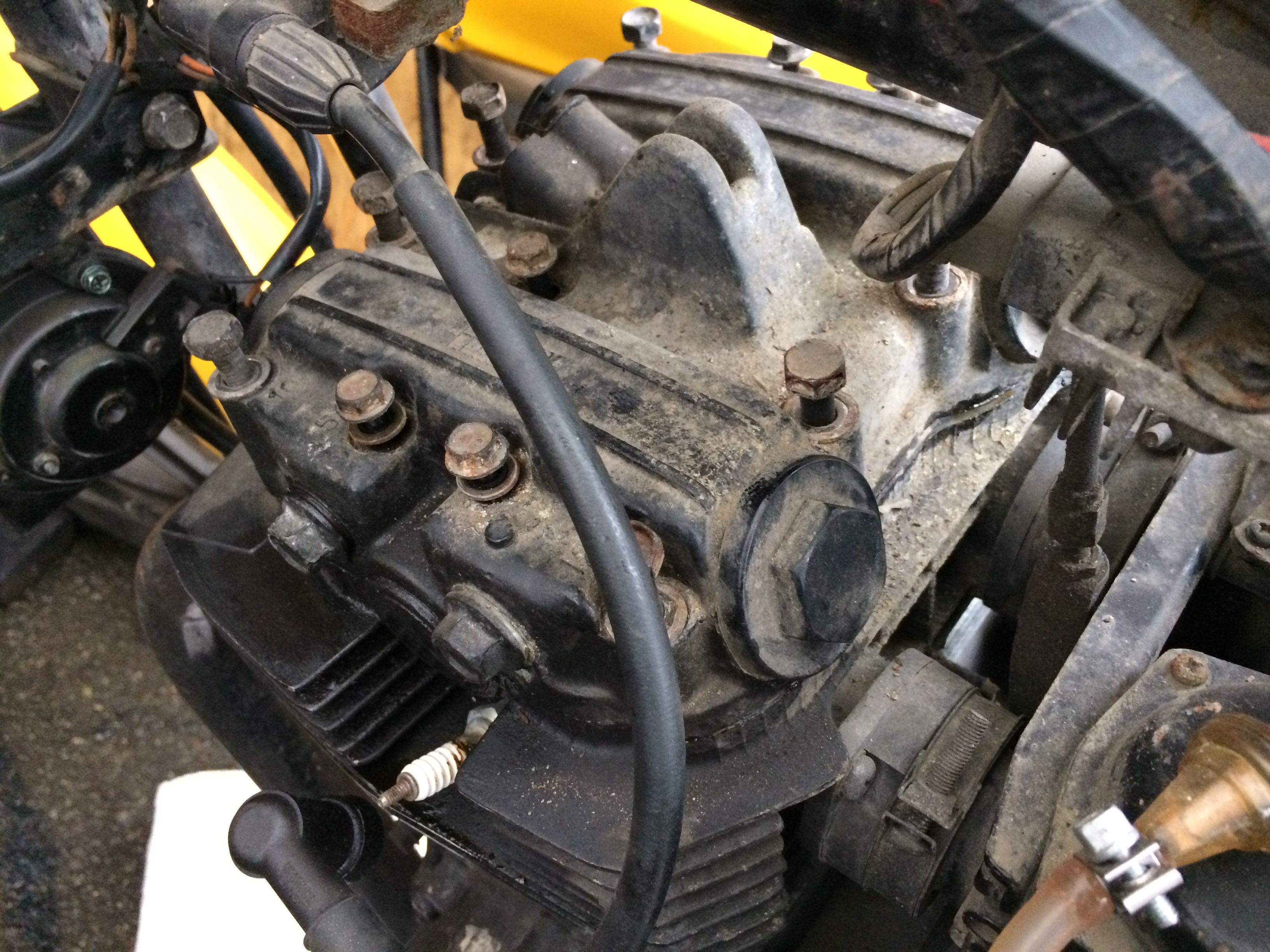

Well, I ran into my first real challenge with the bike. I wanted to check the valve clearances, so I looked up the specs online and started to take the head off. (In case anyone is wondering, the specs I found for the valves said .014-0.19mm for intake and .21-.26 on the exhaust side.)
The engine cover is pretty dirty. I was nervous about taking the cover off, as I didn't want to get dirt inside the engine. I wiped it down a little. But, it was really caked on there. I'm not sure if or when it was last opened. I also realized, after loosening all the bolts, that I did not have a spare head gasket for the engine, and the dealership in Burnaby is closed until the 3rd! Shit. I accepted the fact that I might not be riding my bike again for a while.
I started to take the head off, but it seemed stuck in one corner. I tried to jiggle it around, but didn't have any success. I tightened down the other three corners again, part way, to take pressure off of the stuck corner, allowing it to unstick itself. But, it didn't unstick. It's still stuck.
I don't have a manual, so I don't know if I missed an important step. I am certain that I unscrewed each bolt. Not sure if I should just man-handle the whole thing off or if that is a horrible idea? Do I run the risk of breaking anything?

If your checking the valve clearance only, don't remove the head. Remove those large looking circular bolts in the pic you posted. They are there for that reason. Headlight made a huge difference. As far as the paint, I would try rattle can personally. Bbq paint works pretty good on exhaust to help freshen it up. Good luck from up in whistler
Hey Shawzie, thanks! I noticed these plugs after I loosened all the nuts holding the top-end on. Oops. If I'm going to check the valves through those holes, how do I turn the engine over and get it to top dead center?
After unsuccessfully trying to take the top-end off, and tightening everything back down again, I have noticed some oil leaking over the engine block. I called up my local Kawasaki dealership and ordered a new head gasket. I will try to take it all off again, and replace the gasket. Hopefully this time I can get that damn engine apart!

Well, after a few conversations and a little bit of research, I think I figured out the solution to my problem! The first problem was me mixing up the names of the various engine components that I was working on...
I attempted to remove the valve cover, not the top-end. Turns out it was completely unnecessary to remove this, as there are convenient little portholes (I still have no idea what these are properly named) that I can open, in order to check the valve clearances.
The reason that I was unable to remove the valve cover, is that my engine was not at top dead center, causing either the piston or the cylinder (not sure which one) to be pressing against the cover. I'm glad that I didn't try to rip the cover off with any substantial force!
After bolting the valve cover back down, I noticed a good amount of oil leaking out over the engine covers. I previously called Kawasaki to order a new head gasket, but I now understand that I need a valve cover gasket, instead. Noob life, right here. Turns out there is no such thing as a valve cover gasket for the GPz305 or EX305. Instead, they use a liquid gasket.
